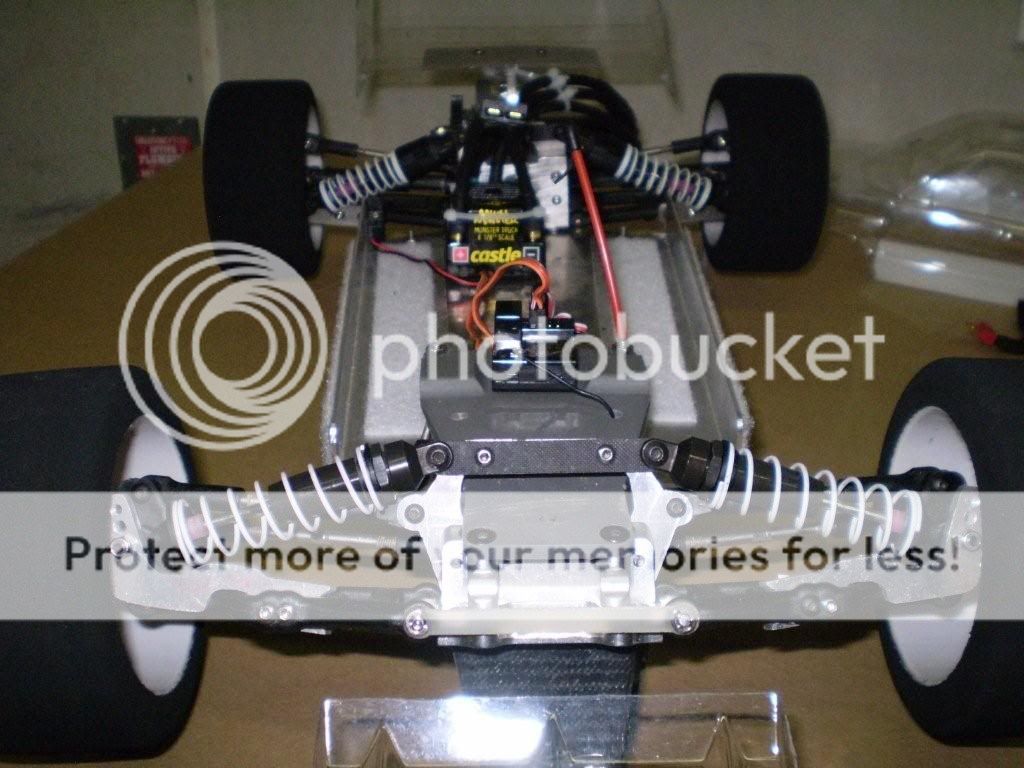

I know of up to 6 Rustlers attempting to crack the 100mph mark
There seems to be a lot of comment about nearly every aspect of each attempt, so I thought I'd throw my effort into the ring for a bit of flaming
Feel free to comment...

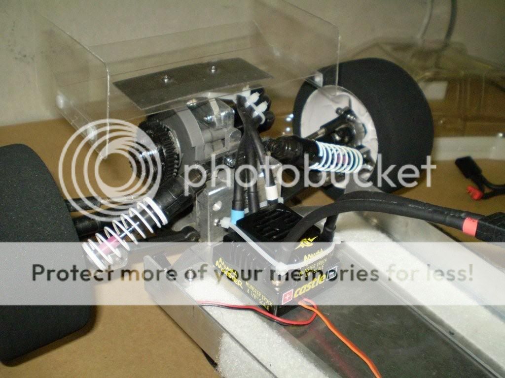

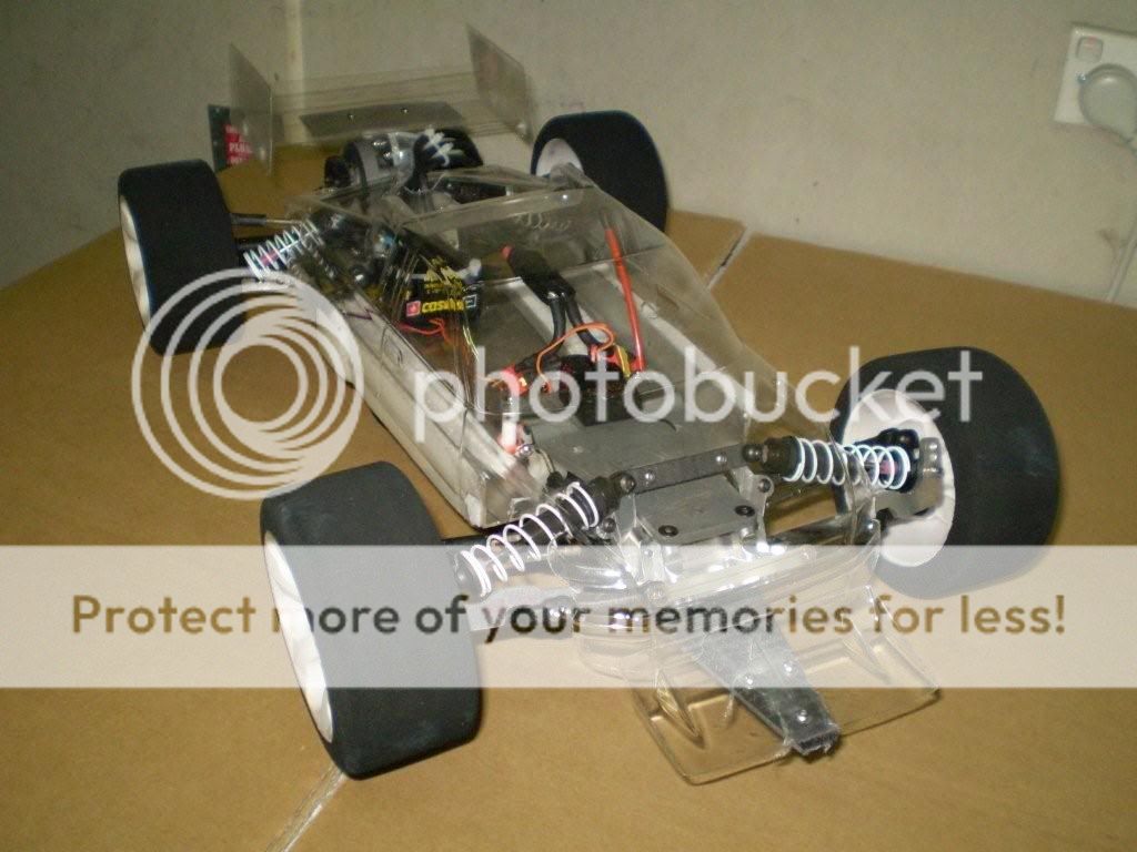

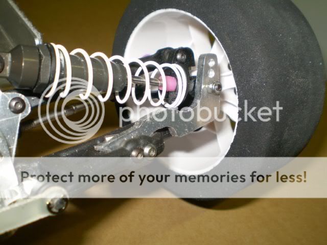

Details...
Motor = Neu 1515 1.5d
ESC = MMM
Lipo = 2 x Thunder Power 4S (3300 30C) in parallel

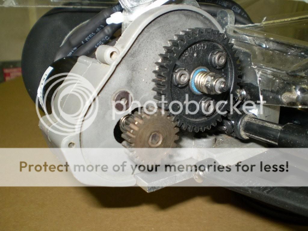

Gearing = 34 spur, 25 pinion Mod1
Wheels = Jato
Arms = RPM
Trans = stock
Shocks = Big bore

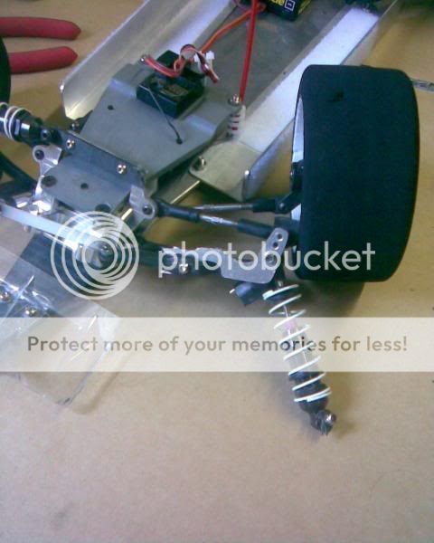

Shock towers = custom 4mm alloy/3mm CF
Chassis = custom 4mm alloy
Servo = stock
Body = XL5 modified
Front wing = inverted XL5 rear wing
Rear wing = BRP super wing
Wing mounts = custom alloy/CF

02.26.2009, 06:11 PM

02.26.2009, 06:14 PM

02.26.2009, 06:18 PM

I'm jump to 17mm hexes with foams... Transmission won't last long with a 1515 - mine lastest about 3-4 runs...

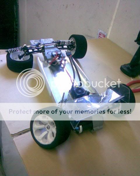

My third run ended tragically with "Rustler" being run over...
So I'm onto Gen 3, which should be complete in a couple of weeks

No damage to MMM, Neu, reciever or lipo (they were cheap junk for the test) but nearly everything else was bent or broken...including the 4mm alloy chassis! It's a rebuild
