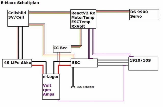

WHAT? 6V BEC? Very bad Information!
I hoped i can make the wire system more simple! (without cc bec for 7.4V)
One Big Point to MMM is lost. Bad joke.

I don't understand. You want a BEC that puts out 7.4v ? You want to fry your servo's and radio or what ?
The robotic servos operate on the higher voltage from what I have seen and there are a number of receivers which can run on the higher voltage as well. I think the new spektrum receivers can use the higher voltage but don't quote me on that.
Electric Dave
04.30.2008, 08:16 AM
Huh? 6v is the normal voltage for a BEC...actually it's perfect, many are a little lower than 6v...at 6v servos will perform perfectly.
tc3_racer_001
tc3_racer_001's Avatar
Posts: 701
Location: Brisbane, Australia
04.30.2008, 08:20 AM
any more than 6v and they will fry wont they? i think 24kg for a steering servo is enough in a buggy anyway :P
Agreed. I don't see why 6v is a bad thing at all. Oh well, more MMM for the rest of us.

Some of the very fast servos designed for touring etc are designed to be used at 5.0 - 5.5V if I remember rightly...but not many. And nobody's going to be using such servos in 1/8th or 1/10th MT applications anyway, so that's not a problem. 6.0V will be great for our servos. It's kind of a shame that it's not programmable like the CCBEC is, but it's no major loss IMO. If you need programmable voltage for whatever reason, just disable the onboard BEC and stick a CCBEC in there. :)

For $20 for a ccbec if you really want a different voltage I really don't think it is a big deal really.

My react rx handle 9Volt and the Dymond DS 9900 like 4.8-7.4V too. (A race transponder hande 8V.)
Everybody cry to HV. But a HV Servo is a bad thing? ^^
Are you looking to my Emaxx wire system? I hoped, my next ESC need no ccbec like quark monster. It is a new top product for many years - it should be a feature of the time - integration.
My emaxx peaks 60Amps :>
Titan
PS: There is a timing option, which numbers the option means? The words do not help me. My lehner 1920 like 12° timing. Somebody know it? thx

It would be different if you could only get performance with >6v, but when you can get 200 oz-in with 6v, what more do you really need?

Ahh C. Now it comes clear, :). I can see how it would be a nice option to be built in that way. I would see such a situation as an excellent opportunity to use a small 2s LiPo as an RX pack. Less clutter if it could be done from the ESC though, for sure.
J.
