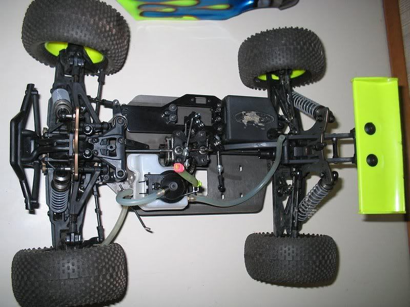

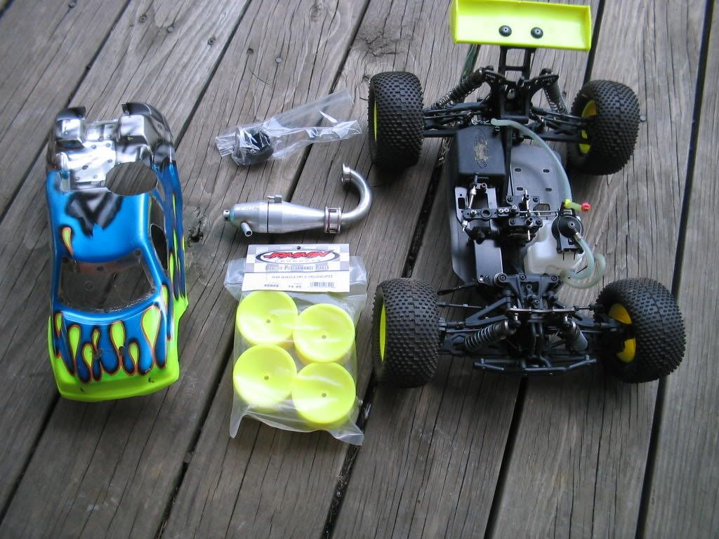

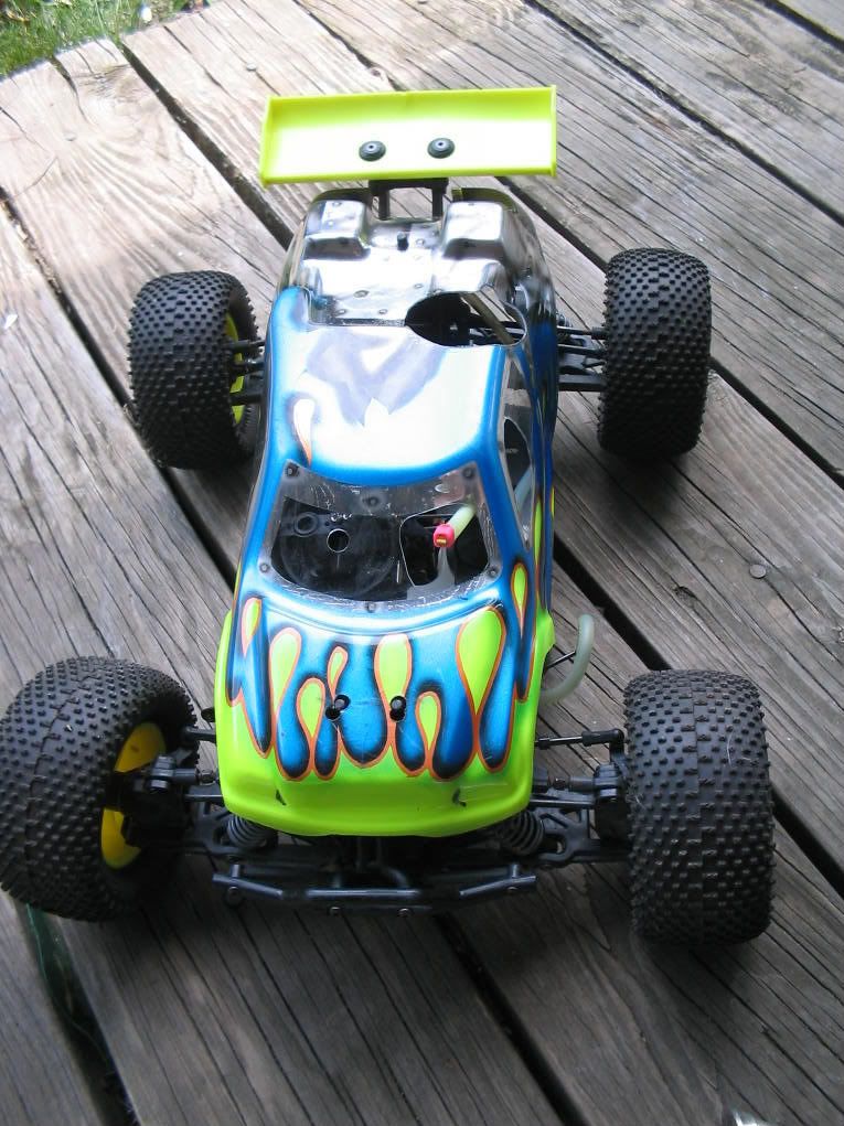

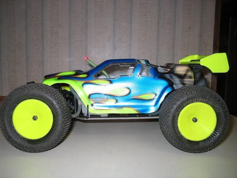

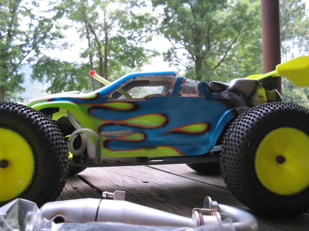

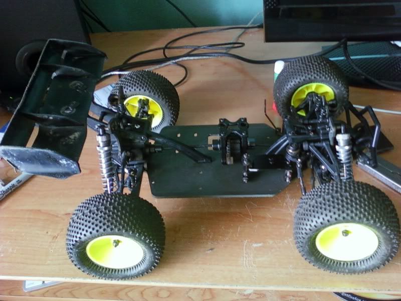

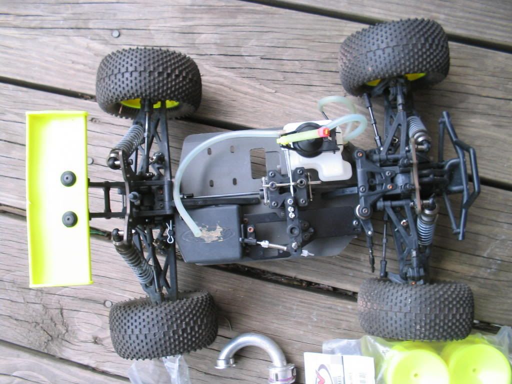

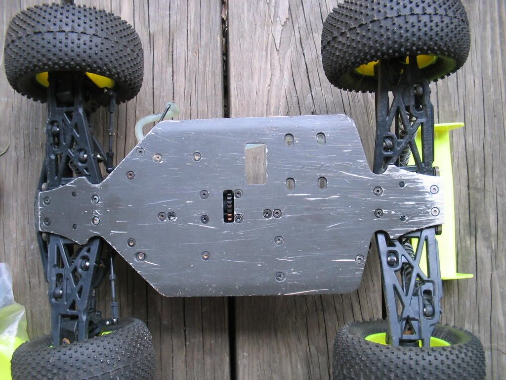

Hey, I bought a Crt.5 used for a hundred bucks off RC Universe, and I will be converting it to electric. This should be a pretty smooth conversion, as I also bought a conversion kit off of RC-Monster user kona(thanks!)
Here are some pics:
I will take more pics once I actually get it lol

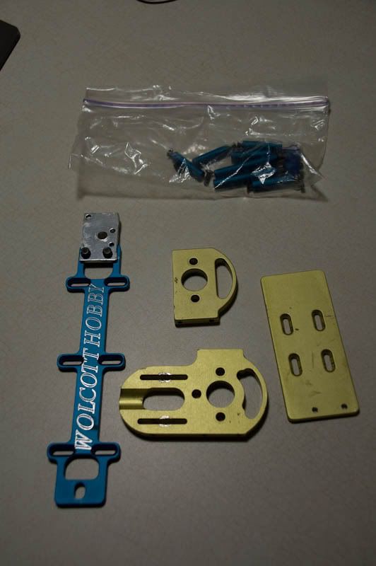

And this is the conversion kit I got!

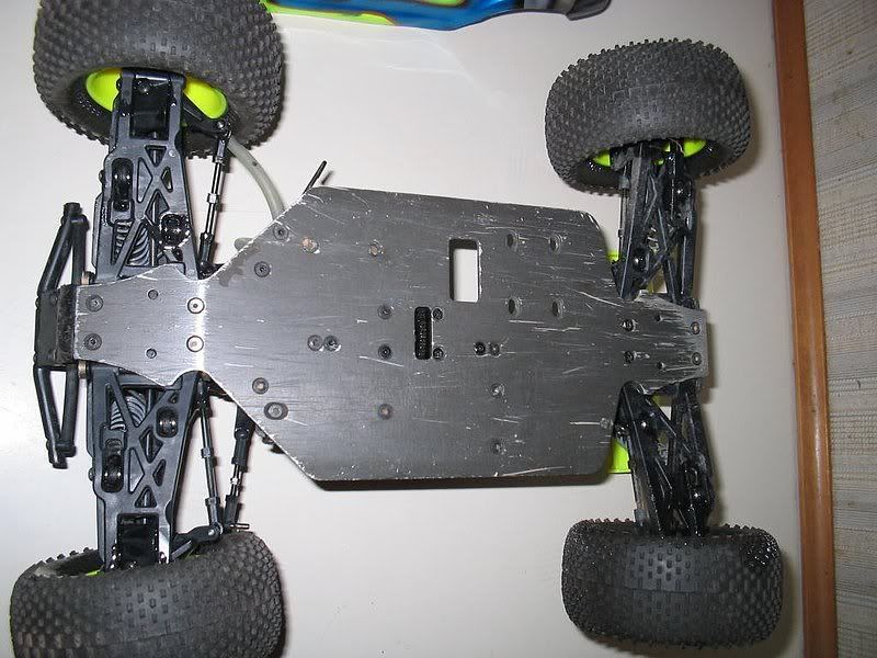

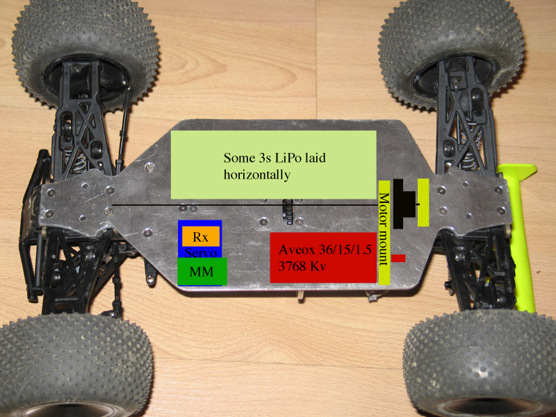

I will have it set up normally for the time being, but I am thinking of taking some measurments, having FLM or Mike make me come custom dogbones, and set it up like the hyper 9, where I move the diff all the way to the back of the chassis. I then should be able to put my MM, aveox motor, servo, and rx on one side, and then possibly fit a horizontally mounted novak tray on the other side, to give me a balanced chassis with a low COG. tell me what you think
EDIT: here is a pic to explain what I am envisioning(I borrowed a pic of MetalMan's chassis):

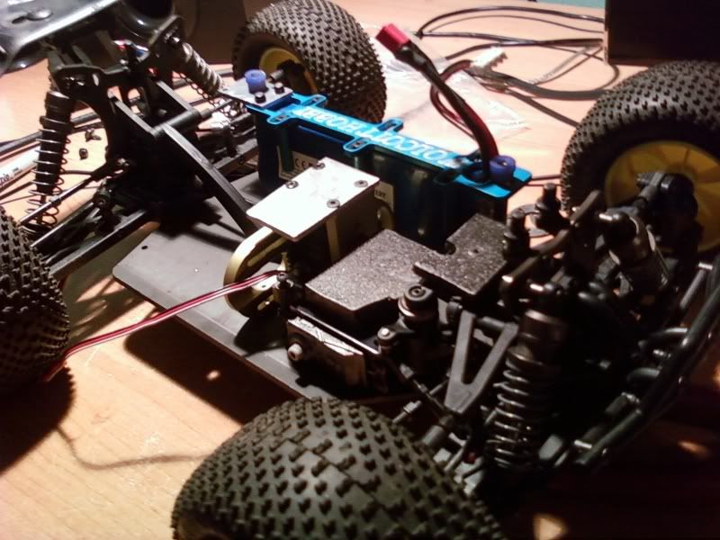

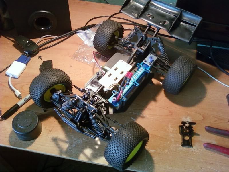

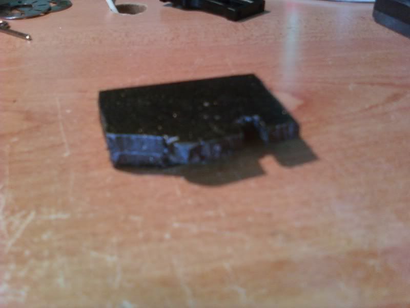

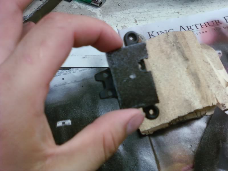

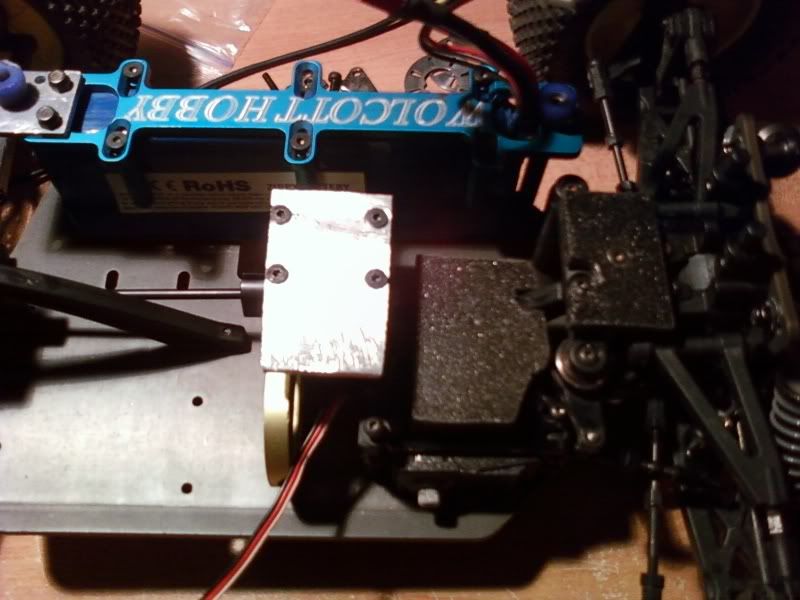

So i got my conversion kit from kona yesterday. and suprising, the kit matches the custom body on the crt.5! I put it all together, minus the top plate for the diff. I made my own smaller one, because I plan on keeping everything lower by mounting my electronics elsewhere. I made a custom Rx plate on the top plate of the front steering assembly, and another one that is on the servo mount, that the MM will sit on. here are pics!
before
and after
