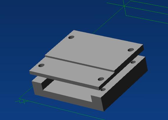

Oh yeah, I just thought of that actually. I have 1/4 inch here, but maybe I'll go tomorrow and get some, that should provide a low resistance, low inductance channel for the caps.
Hey, I just told my machinist to mill this up so I can try it out. I have emailed Mike a couple times, but he hasn't responded. He must be very busy, I won't bother him with anymore.
The distance between it is 4.00mm, I squeezed the FET's with the caliper and that is that measurement I got with a good pressure, I thought.
Name:	Simple ESC clamp.JPG

Yeah, I've emailed Mike a few times and never got a response. With all of the emails that he gets, I suppose that he has to prioritize his responses and what you are talking about having done is way beyond milling a motor mount. It's probably going to require a 3D machine of some sort or someone on a mill with a lot of patience.
