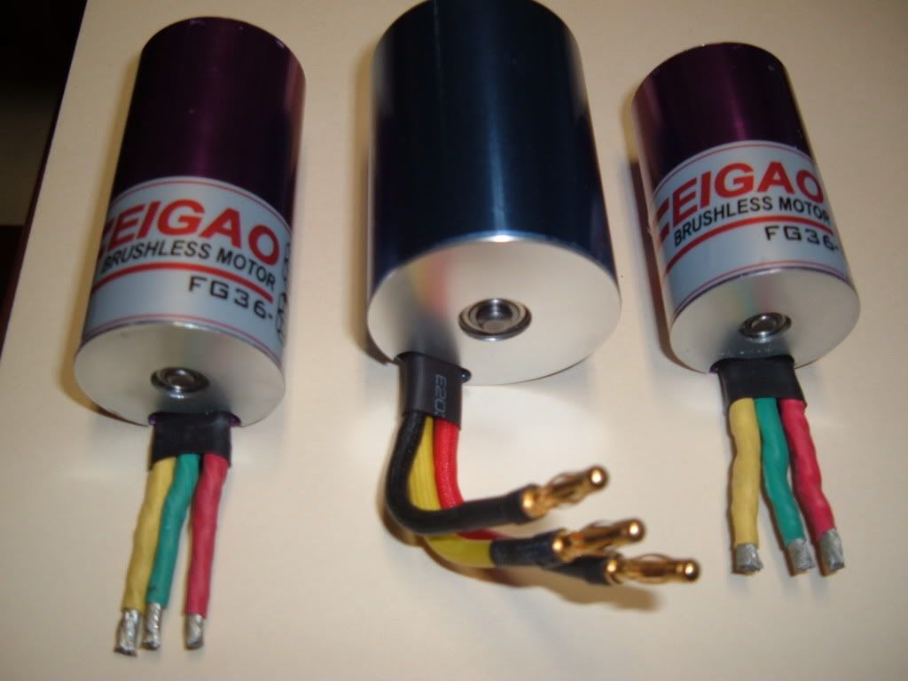

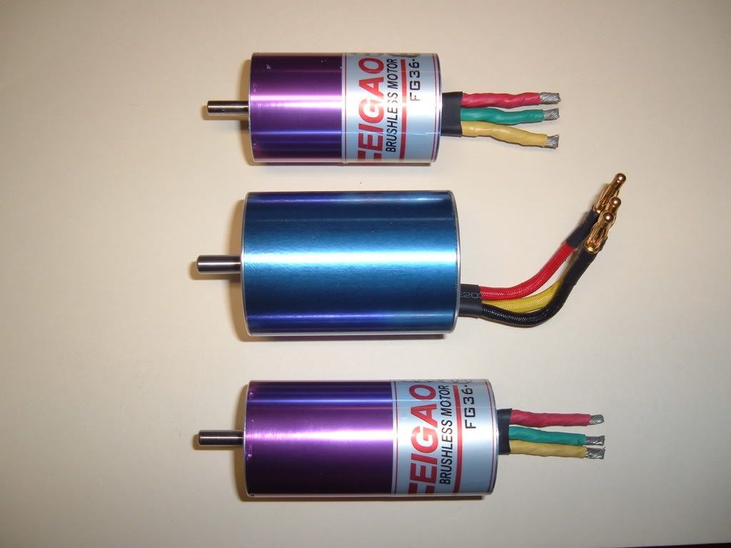

Sorry guys, had you going. It is a KB 45 motor from UH. It is a 10 long can, 1800kv IIRC. It is next to an 8xl, a 380 8xl!!!
Here are some pics next to 540 motors. The motor in the foreground is a xl 540, the other is a l 540. I had to, just to see the responses!!
The KB motor seems like a well made motor, connectors already installed too. It is 45 mm wide and 63 mm long. Has m4 threads set 30 mm apart. 6 mm shaft riding on what looks to be 6x12 mm bearings. The shaft has very little endplay/slop, and the can and endbells are nicely finished. I think it may be painted, cause there is a slight texture to the blue. Anyone know if the endbell unscrews? I read at some point that it does, but I am not 100% sure.

How well do they hold together? I wouldn't mind one for the Twinforce to replace the 2250 that shorted a phase. I have a 16024 that is begging for a big 8s setup

Not sure about performance, but I do have the 2 xl cans on the way too. I need to order some mod 1 pinions with 6mm bores from sdp-si and make a mount for the motor to fit an emaxx tranny. I should have the aftershocck tomorrow and hopefully get it all together in a couple weeks. I may also put one in a boat, who knows!!!

I'm more intrested in how they take a knock. I'm sure they will more than kick butt in a truck

I am almost sure that the front endbell is threaded on. I have a 28 series motor and the front endbell is threaded on. If so it should not have as much trouble as the pressed on feigaos do. i just hope that it runs failrly cool on 5s in my aftershock.

Good god, thats a hell of a motor...

my lower jaw dropped on the floor. That is one huge motor.

Almost had me going too, but I remembered reading that the KB motor has a 6mm shaft, and the XL has a 5mm shaft; the size difference of the two shafts in the first few motors was too big. But still, it is a nice big motor and very very well priced- if it turns out well Mike should sell them as an alternative to the Feigaos.

that's the a 540 8XL.. .probably it's a 380 8XL.. LOL :)
that's a KB 45 L though correct.. cuz the XL is about the same length as the 540 XL..
