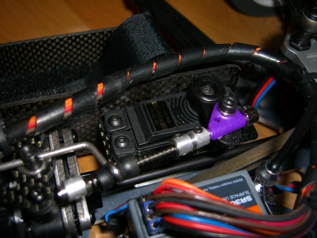

Originally Posted by chilledoutuk View Post
thanks for reminding me why i hate nitro cars all that noise and no go worth a toss.
I could see you were struggling with the brakes in the video as you mentioned i wonder why the stock brakes are so naff is the car heavier than nitro form?
Also what servo are you using for brakes perhaps you need one that has more torque.
The brake servo is an airtronics 94758 digital (115oz) so it should have plenty of torque. When the brakes are cool and fresh it can lock the tires up easily, but after only a couple hard stops they heat up and fade to the point of being useless. They get so hot when I picked it up to check what was going on I could smell them burning.
The car is ever so slightly heavier than the the nitro form. But not much at all. The guy whos body I was borrowing runs his DM-1 nitro and we were comparing the weight of the 2 by holding one in each hand. We concluded that my electric was heavier, but it was so slight it was very difficult to tell by comparison. Couldn't be more than a few ounces different. He has the same problem with brake fade on his also so I think its just a function of trying to have a single disk do all of the work to stop that thing. Buggies have 2 disks and truggies typically have 4. This probably weighs about the same as a typical buggy. I think if I upgrade to a 2 disk setup I should be OK.

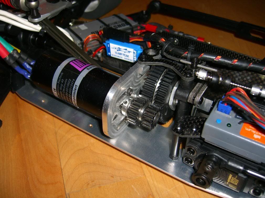

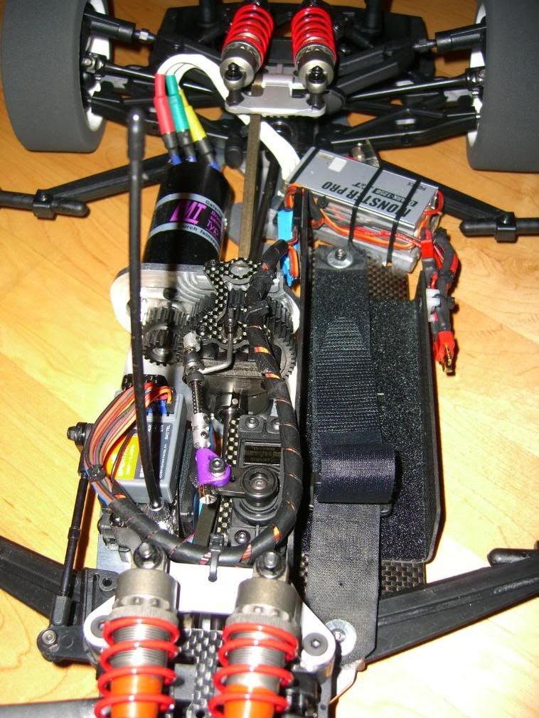

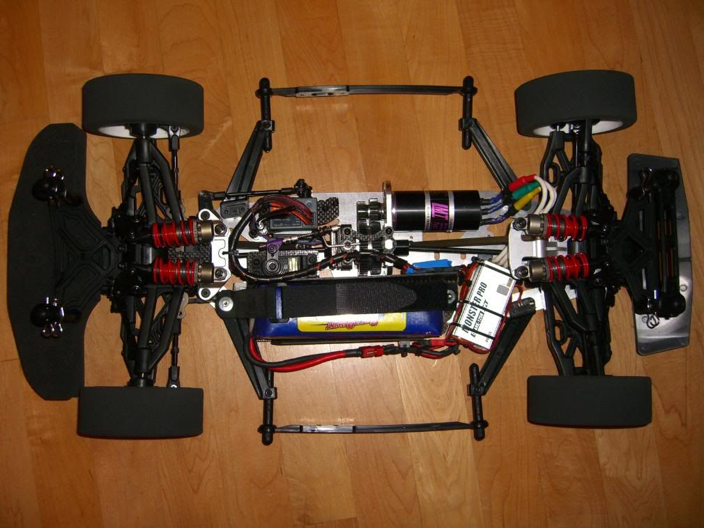

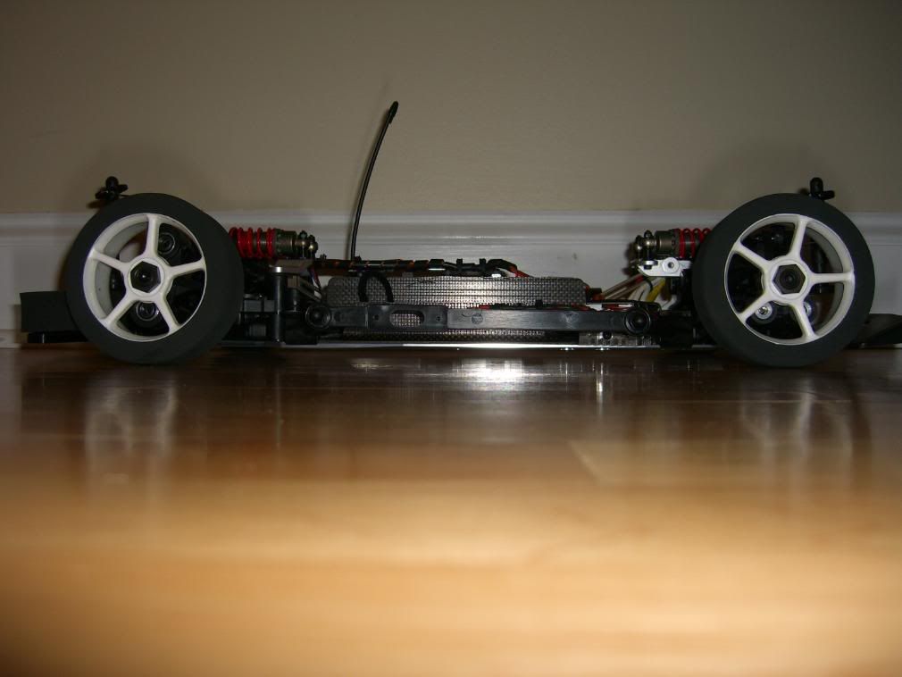

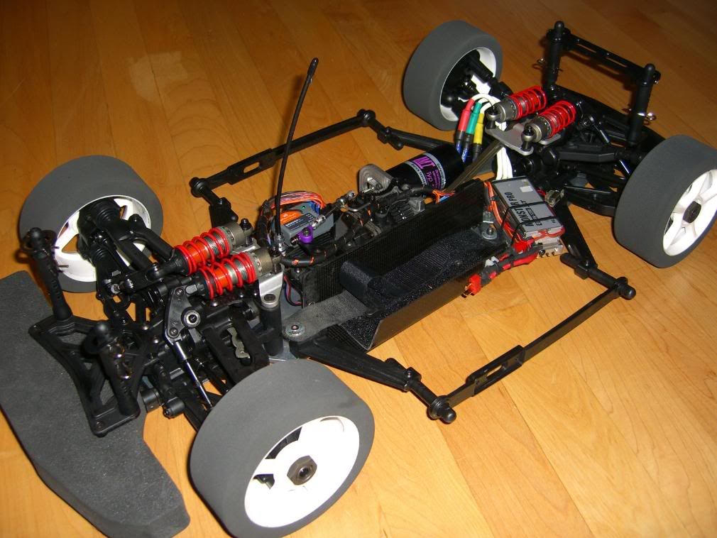

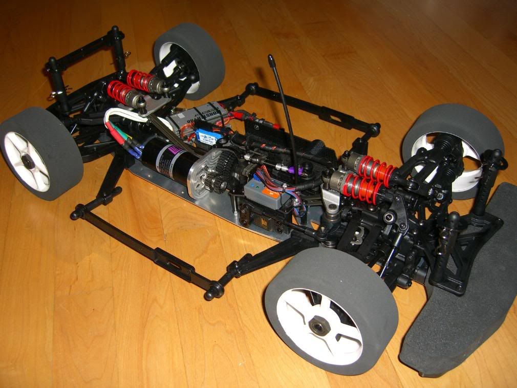

OK reeeeeeally overdue update.
Its finished and I did get it out for a couple evenings of parking lot oval racing before the weather got way to cold. It was still cold out so the tires werent holding the pavement that well. the most fun part was the speed runs. Its a huge lot where we race so I was able to really open it up. I had my 1/8 buggy up to 60mph and this thing was way faster. no radar or GPS yet, but I'll get GPS onit in the spring. It was so fast I was almost afraid to totally open it up. I dont think I really ever got it to top speed. I'll wait untill sping and warmer temps so the tires have better grip. As for the oval racing its almost to fast. I had a hard time keeping the back end in line with the cold temps and poor tire grip. I let it get out of line the first night I had it out and wound up clipping a concrete pole at 30-35 mph. It really sucked. Turned out all the broke was the rear hub carier and I bent the rear CVD and blew out one rear bearing. I was able to straighten the bone and the rest was thankfully only a $11 fix with shipping.
Fixed it and had it one more time on a relatively nice night (40 degress F ) This time I got a chance to put some laps in and I gotta say I think I really like it. It absolutely ripps. It takes a lot of thottle controll and take a very diferent driving style to get it around the corners quickly, but once I got the hang of it I had it really turning some fast laps. Nobody was keeping up. I really liked the 2 speed. On the straight, it was like a little turbo boost kicking in and it just lurched when it hit 2nd gear. Once spring hits I'll start working on tuning the suspension to get it right and dial it in. Is still box stock setup and I'm sure it will be able to be tuned for much more consistant performance.
Anyway... nobody really want to read all this blather. Here are the finished pictures. Sorry no more vid. I broke it the first time I brought it out and didnt get any, and then forgot the camera the other time.

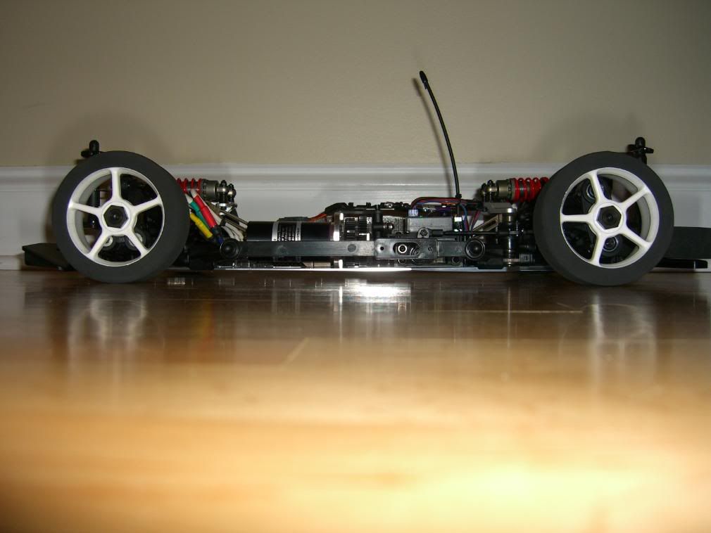

  (#59)
jhautz
jhautz's Avatar
Posts: 4,217
Location: Chicago, IL
12.01.2007, 06:13 AM

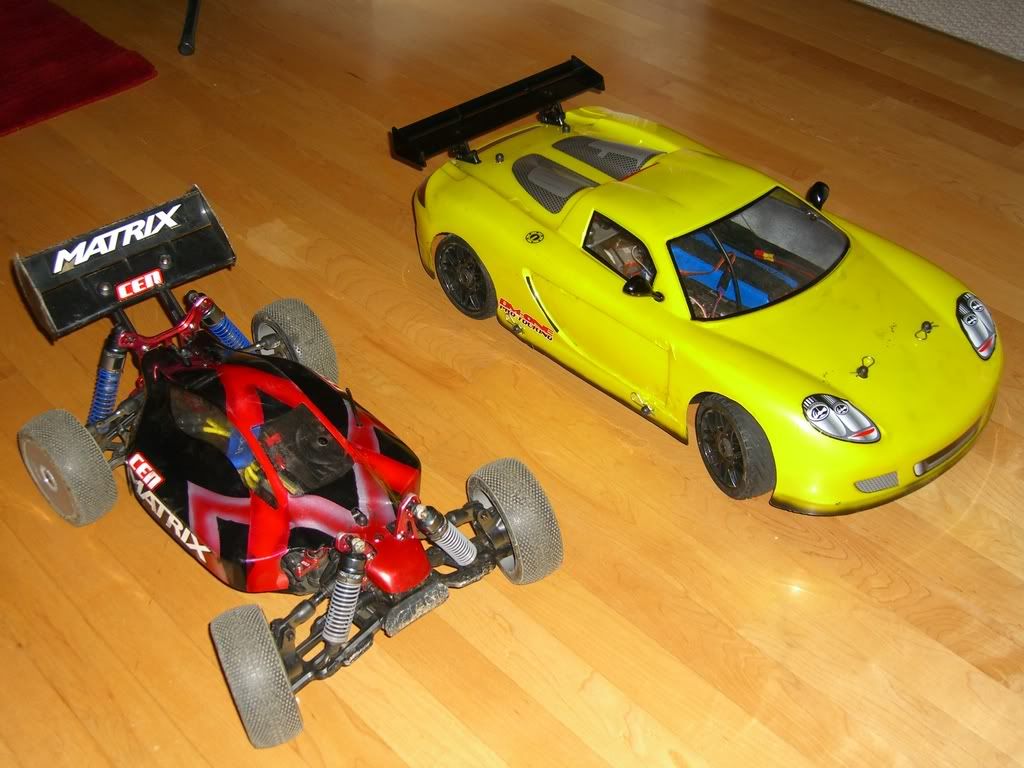

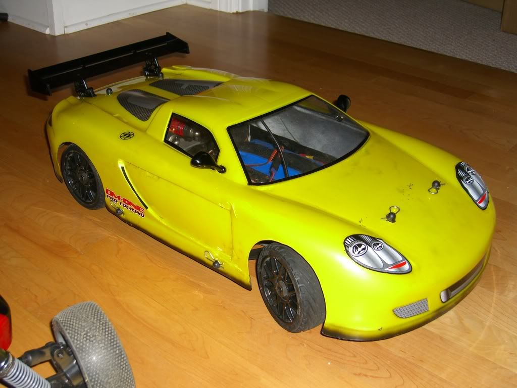

A couple with he body on next to a 1/8 buggy for scale.
