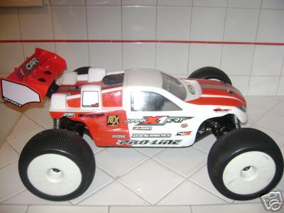

03.18.2008, 03:13 PM
Awsome here's the truck
