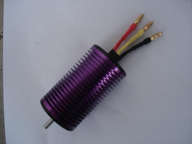

I'm going to do some testing with different 2 pole motors to see how they do temp wise. I'll be getting 2 new motors soon. One has a Kv of 1660 (10XL) and the other is 1845 (9XL).

That's pretty little hacker knock off lutach! :D
It looks good . Pretty much Feigao, KD and a couple other had to copy from somebody . I just hope they are good.
