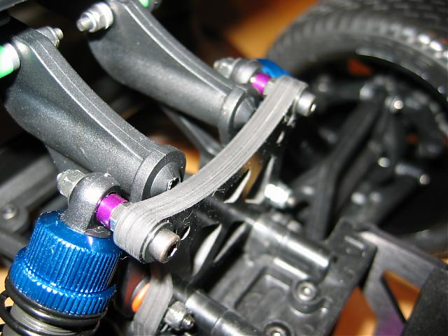

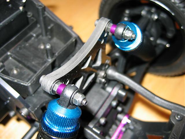

I just noticed your shock towers what are those can you post some close up picks? Is that a hellfire wing mount brakets on there?

I updated my first post, but yes, that is a Hellfire wing and wing mount. The shock towers are MT2 CF units, doubled up.
