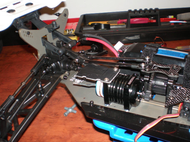

Hey guys .
Following on from conversations and PMs with some of you on RCTech i finally joined here .
My X2 is finished , waiting on the body to be painted and another esc.
Fried the MM when testing the X2 on the bench
Have back ordered a couple of MMM V2 ( one will go in my RC8 conversion ) and will be trying one of Arturs Modded R1Pros out .I can always sell the second MMM if not needed .
Following set up
PQ 5S 4350mah
Medusa 36-60 1600kv motor with 14 t - 15 t pinion ( 38 - 40 mph )
RCM battery tray
TeknoRC universal motor mount
MMM V2 or modded R1 Pro
Everything went smoothly in the build and have to say the driveline is the smoothest i have ever built , very nice
Only mod i had to make was for the Tekno mount .The mount itself is a very niece pice of work , cradles the Medusa like a glove and works as a heat sink .
I had to make 4 countersunk slots in the chassis for the mount so i could adjust gear mesh .
Also since the mount is seperate from the diff any flex in the centre of the chassis would disturb the mesh and could destroy the pinion / spur . I came up with the idea of using Traxxas steel pushrods ( plenty of guys on RCTech gave me some good ideas on bracing the diff ) and attached two pushrods to the top of the diff and rear chassis brace .
This should work well until Mike comes out with an X2 specific mount so i wont need the bracing .

On another note , after a few emails with Mike he was sure a couple of guys are already using the CR mount in the X2 so i ordered one to try out.

Looks great! Keep us updated on how it runs. Does the spur gear go wider than the motor mount? Thats what it looks like in the picture... I just noticed it because usually his motor mounts are just a touch wider than the spur gear, so that the battery tray can be as close as possible and it looks like you have quite a bit of extra room to push the battery a little closer toward the center.
ffactory666
08.08.2008, 03:38 AM
Just checked for you .
Looks like the spur is borderline with the end of mount .
That pic does make the tray look like it's got a mile between it and the spur , just measured it has 3mm clearance. I could move it over a touch more , within 1mm of the spur but don't want to in case of an accident , wouldn't want that spur anywere near the lipo .
How much clearance do you have between tray and spur ?

On my 8ight, I'd say there is about 1/2 to 3/4 of a millimeter clearance between the tray and motor mount. But the motor mount goes about 2 to 3 mm past the spur gear. So I think thats a fairly safe distance. Yah, looking back at the picture, it definitely makes it look more than 3mm.
ffactory666
08.08.2008, 03:52 AM
Sweet i'll keep it at that distance then .
Understand what you mean though , if the mount came past the spur it would act like a guard

Was wondering, ffactory, what zippos are u refering to? The 4s 5000mah ones (the ones i was looking at) were 50 or 51mm wide and all batt trays i could find are only 48mm. Did u get mike to custom cut it? Also is it winter or spring down under right now? When is the best time to visit? Can i stay at your place to save money?
ffactory666
08.08.2008, 07:53 PM
It's winter at the moment , definately wait for summer .
You scratch my back i scratch yours so you can return the favour when i visit the US
I have the Zippy 5s H pack so it's 50 mm wide . Mike made me two custom one piece trays the length of the Enerland cells at 168mm and 50 mm wide for the Zippys .
When running the enerland cells you just pack the box with foam to make up the space in width and do the same with the Zippys to make up the space in length since the Zippys are shorter .
Also Jeff reccomended it ( thanks mate ) and i think it's a great idea , i got Mike to make the front wall thicker that way if the battery moves forward in a hard landing/ lawn dart it won't brake the front wall out of the tray .
It's very uncommon to happen but it did happen to Jeff
