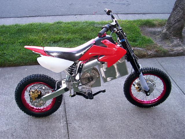

In any case, once I got tired of buzzing around my neighborhood park at 25-mph, I got this bike:
