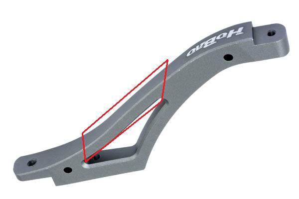

10.01.2008, 10:55 AM
I kinda like the top-plate brace scheme (which is why my last 2 conversions used it I guess). It makes the car far more rigid than with the stock braces, provides more support for the motor mount/center diff, and provides a couple extra places to mount stuff. Of course, it's not as pretty...
10.01.2008, 10:59 AM
I did that on my GTP 2 but not sure I'd want it on the truggy - 2 packs one side seems to work ok on the ST anyway...
With the 1515 1Y on 4s the 51 spur helps with the gearing anyway...
