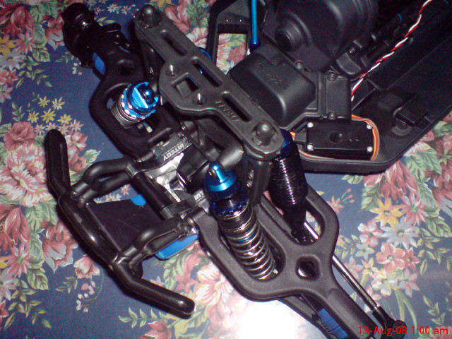

mine uses proline powerstroke w/ bypass, its really good but i know its discontinued and if you happened to see one on ebay give it a try..

My buddy has the same shocks they are the best! They don't leak, caps don't pop off, and they are just so reliable. I would get them but i can't find them any where. I have big bores but they started to suck after i put new oil in them. Should I rebuild them and be done with it or get some power strokes? Witch set up would be better for bashing?

Nice truck also!
