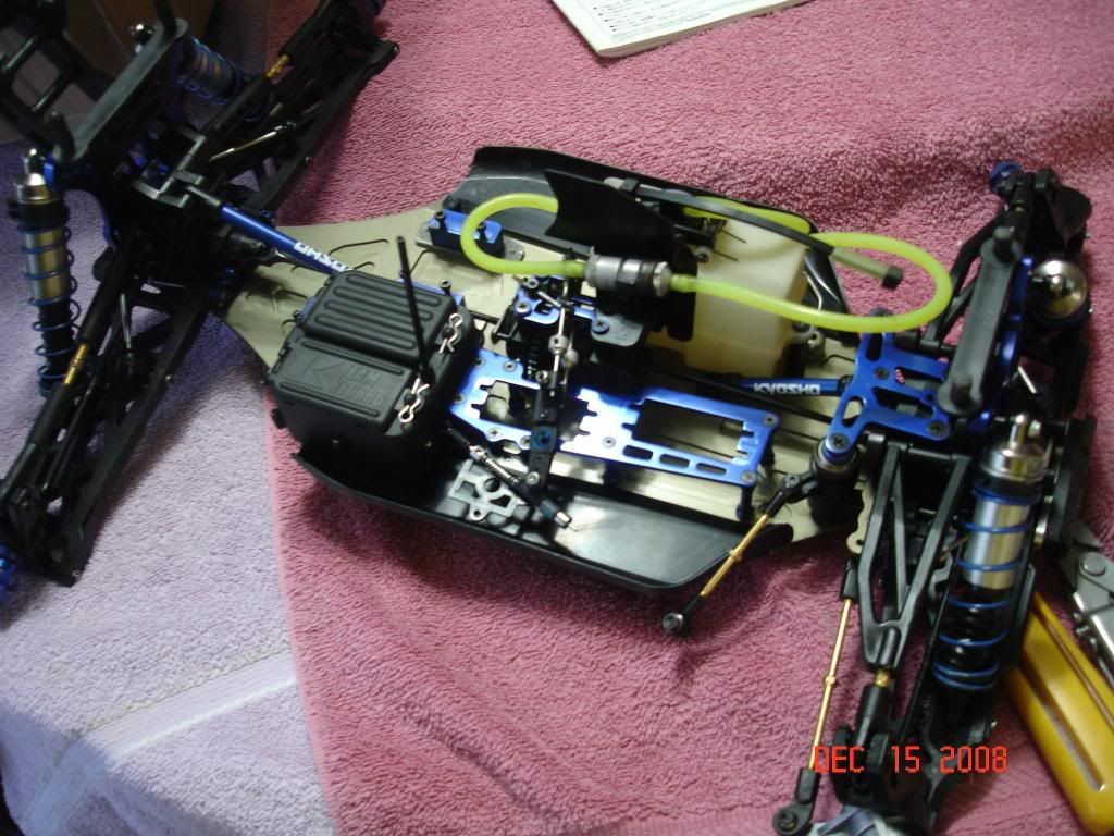

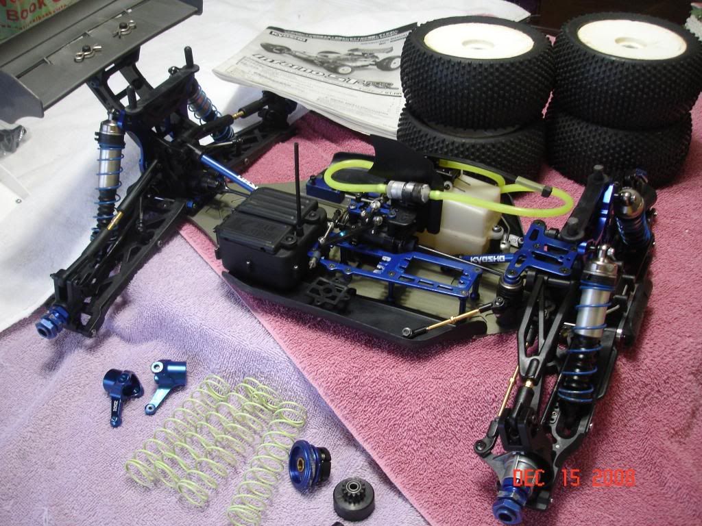

Before the nitro stuff were removed. I actually thought of doing the break-in of my BB engine but decided against since I already had the engine mounted on the SM.

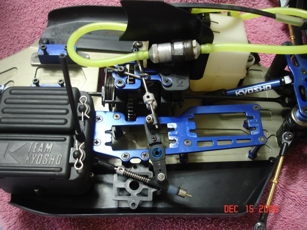

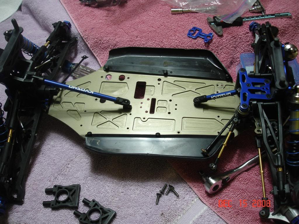

Nitro stuff removed.

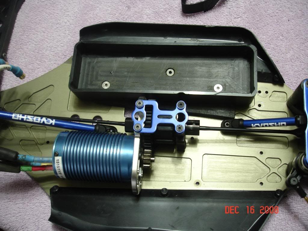

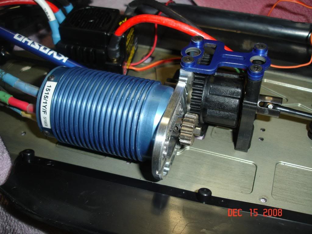

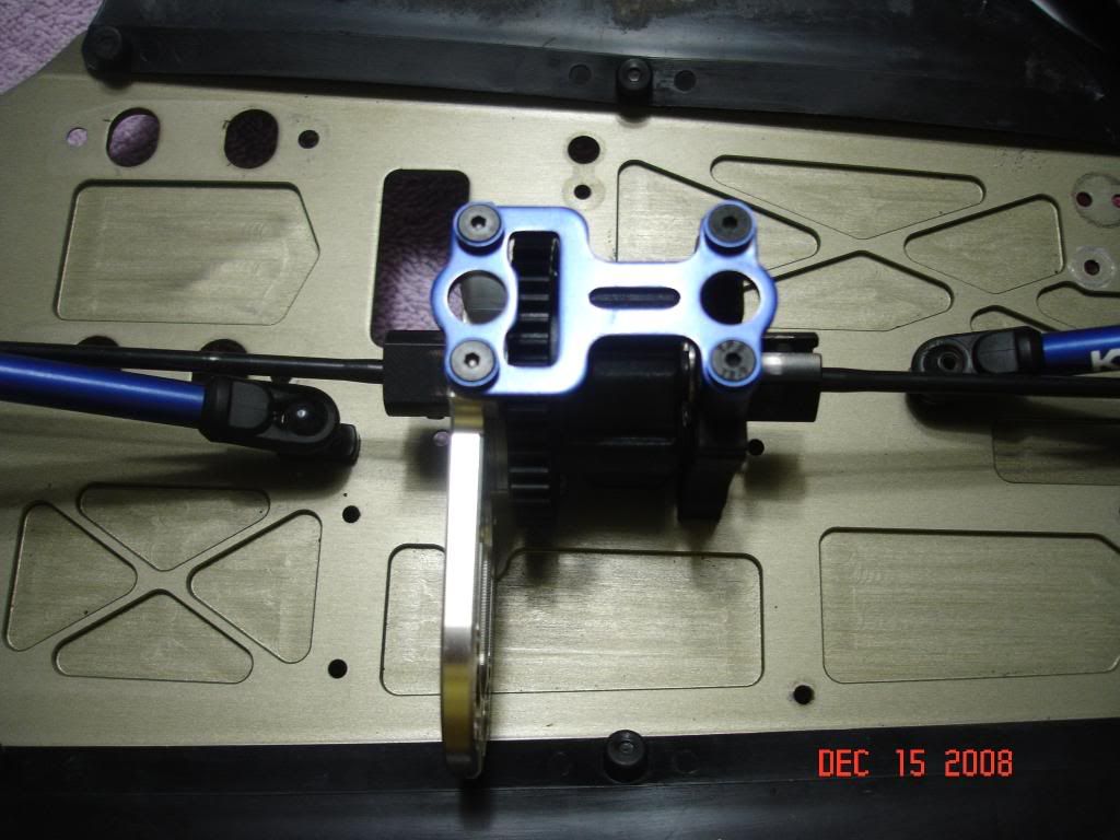

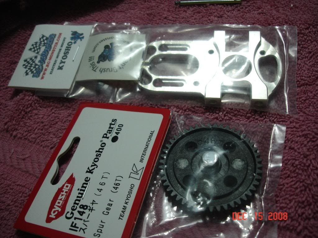

RCmonster motor mount and plastic kyosho spur.

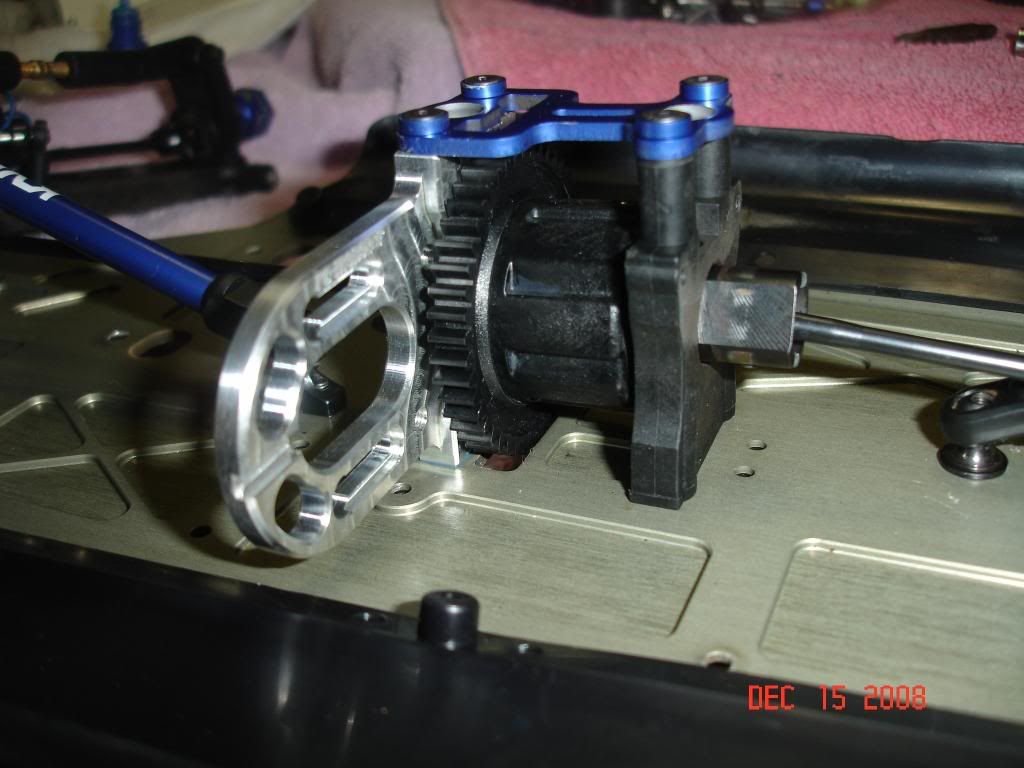

Motor mount installed.

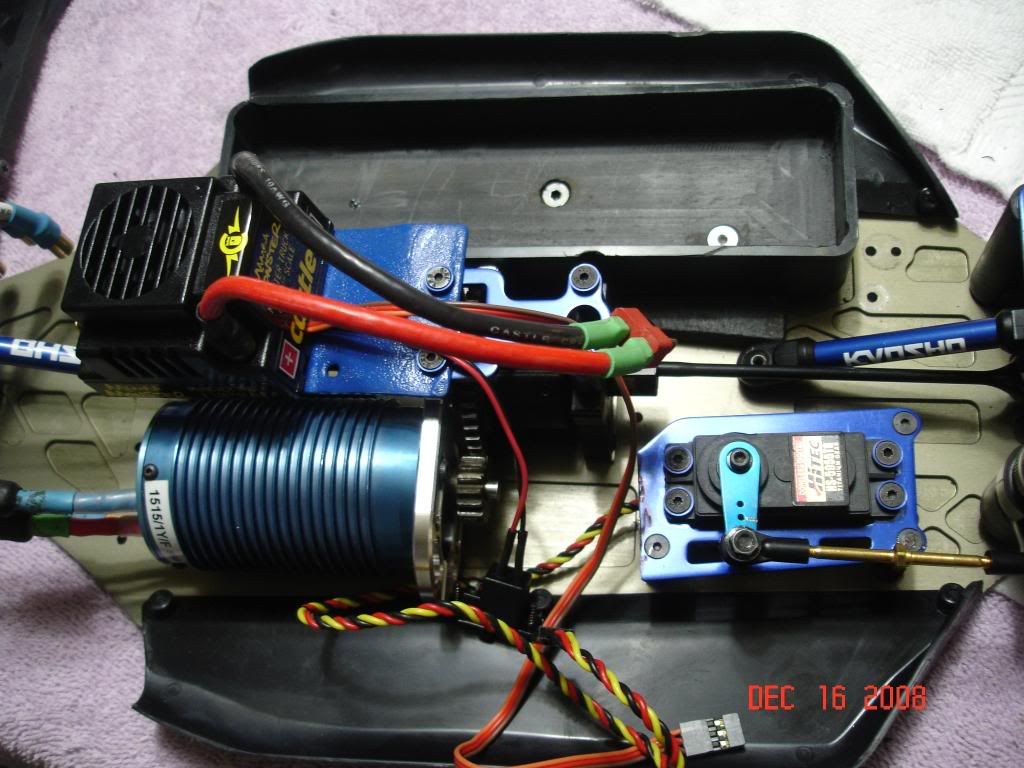

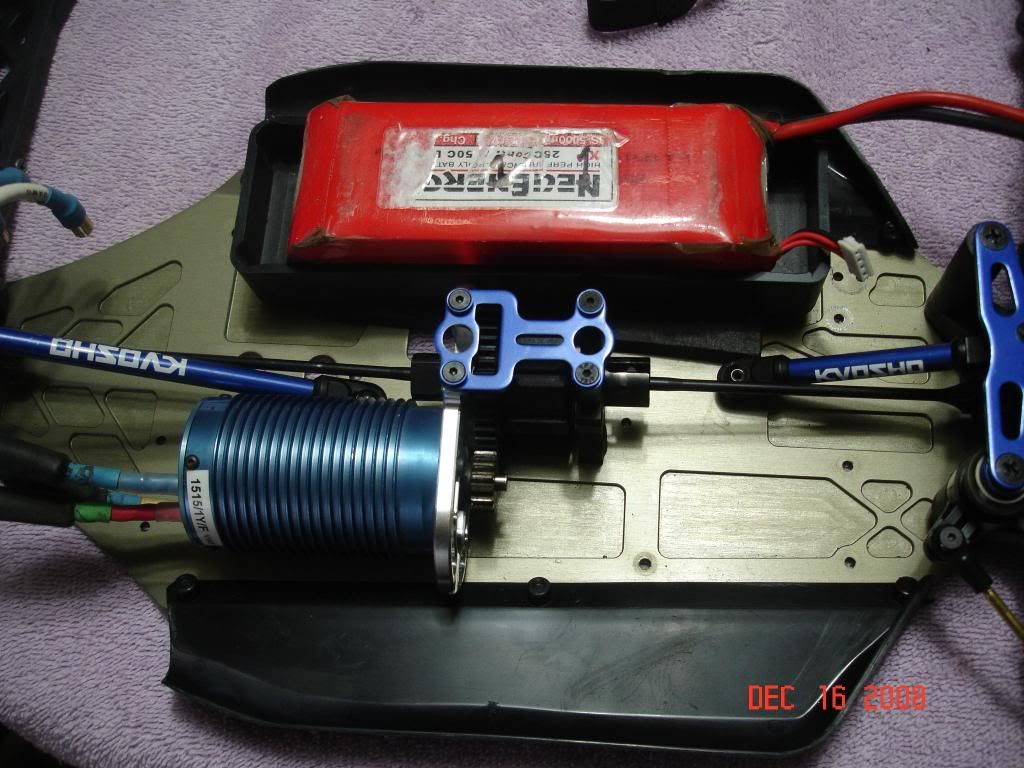

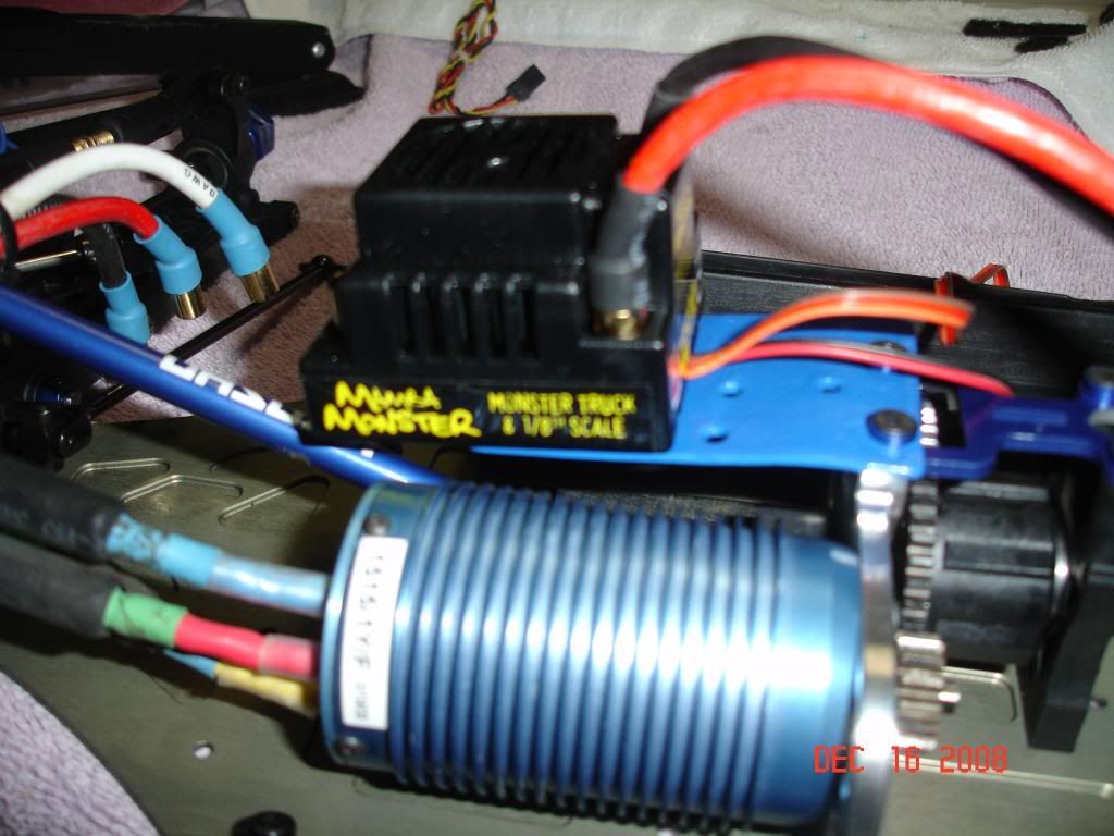

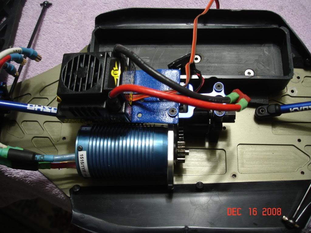

Motor installed. It's the same TeknoRC Neu 1515 1Y from the emaxx. I'm still waiting for the Medusa 36-70-2000 motor which will go to this truggy. The Neu will go to the heavier emaxx.

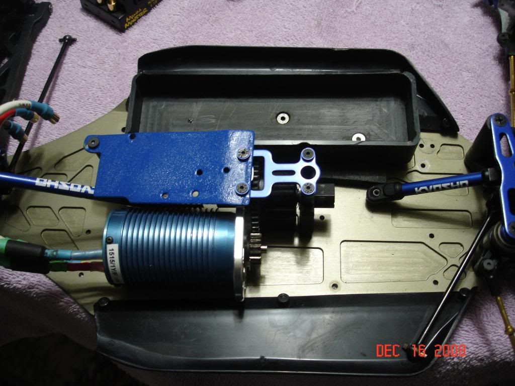

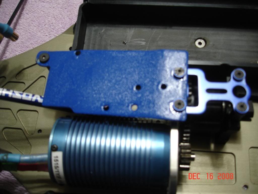

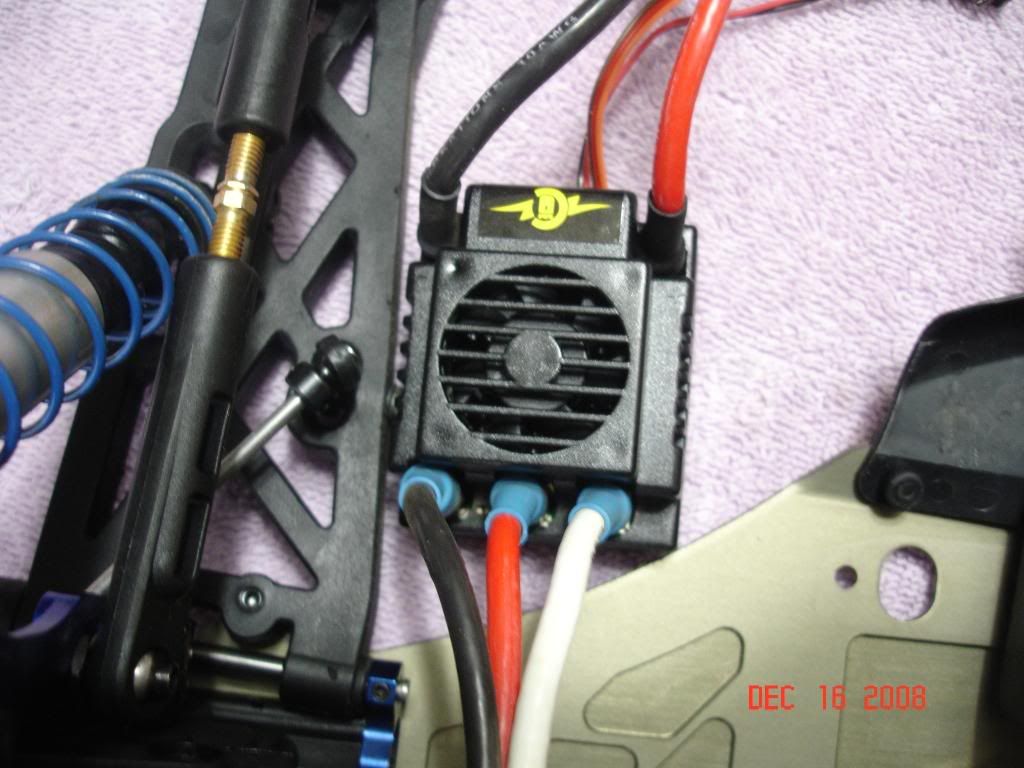

I made an ESC mount from a piece of metal and painted it blue to match the truck.

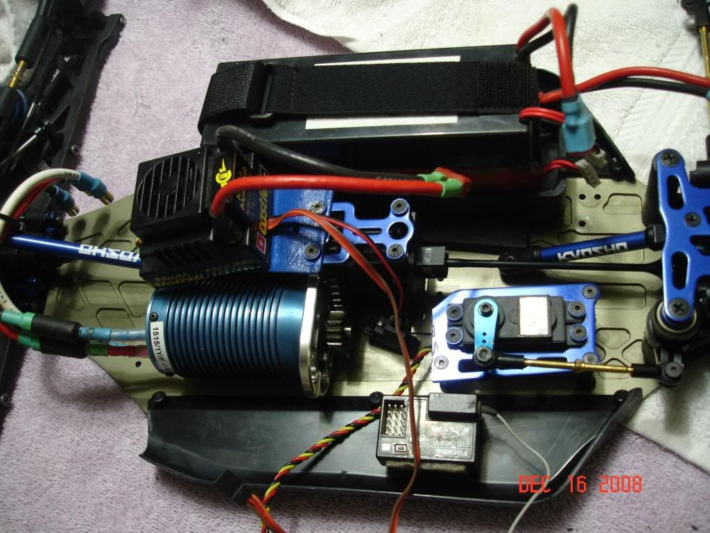

Battery holder installed.
MMM V3. This is my third MMM.
I will be running a 5S setup on this truggy. Right now, it's geared for 46-49 mph. I will check the temps but will droop down the pinion size to 14T for a 40-42 mph top speed for racing.

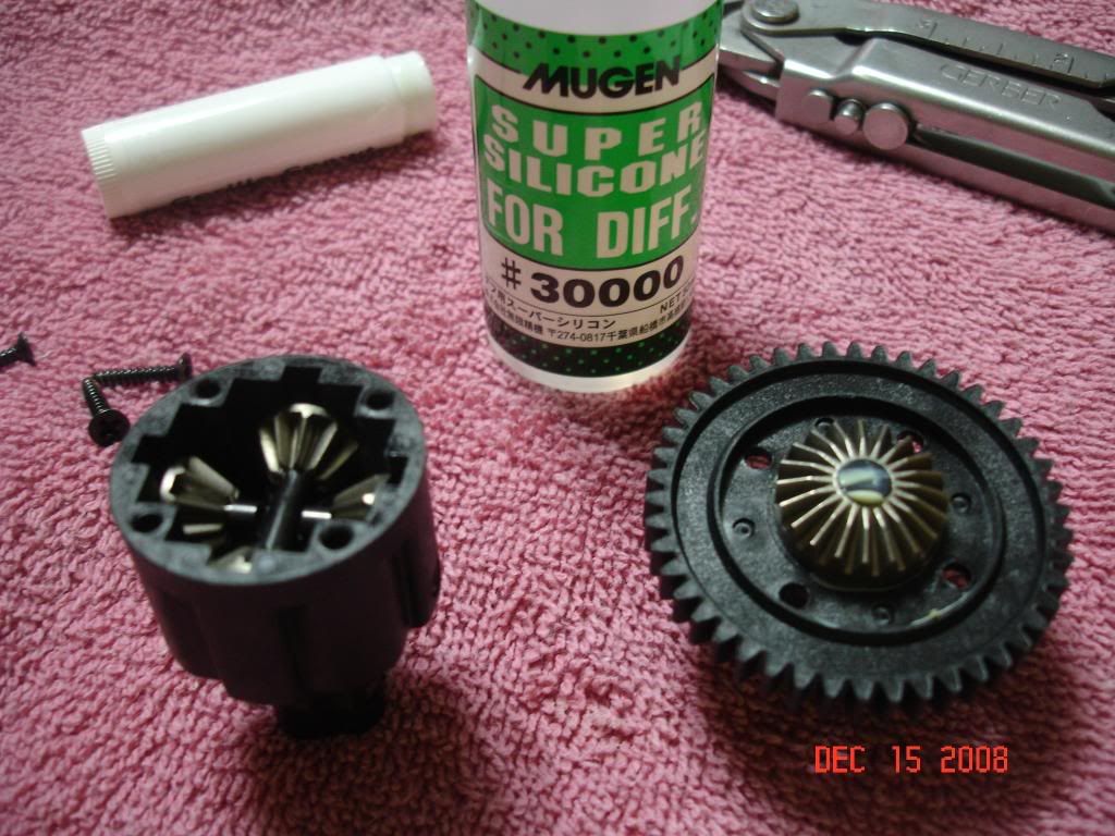

Cleaned and put fresh 30K diff oil in the center diff. The front has 7K while the rear has 3K.

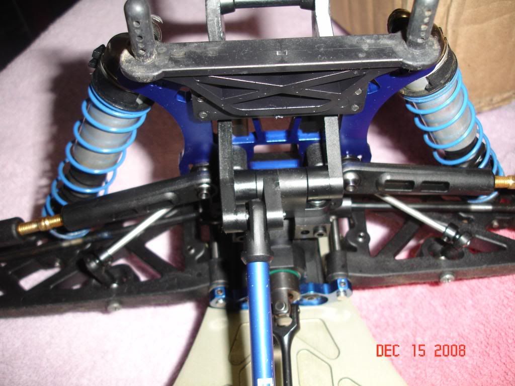

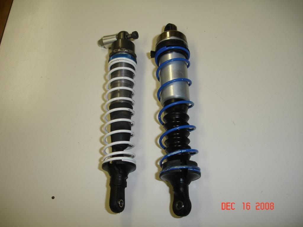

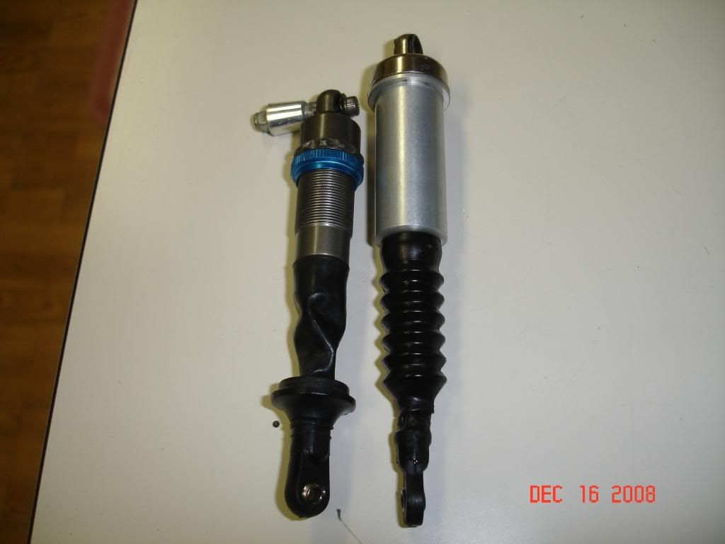

Cleaned and put fresh 50wt shock oil on the massive 16mm big bores too. Side by side against UE's supershocks. They don't look super anymore :D :tbtb: .
Front shocks installed:
Rear:

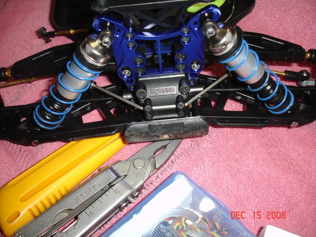

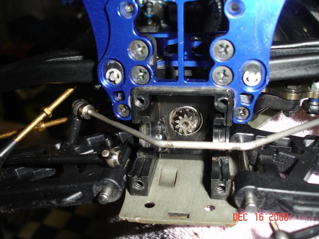

Front gearbox.

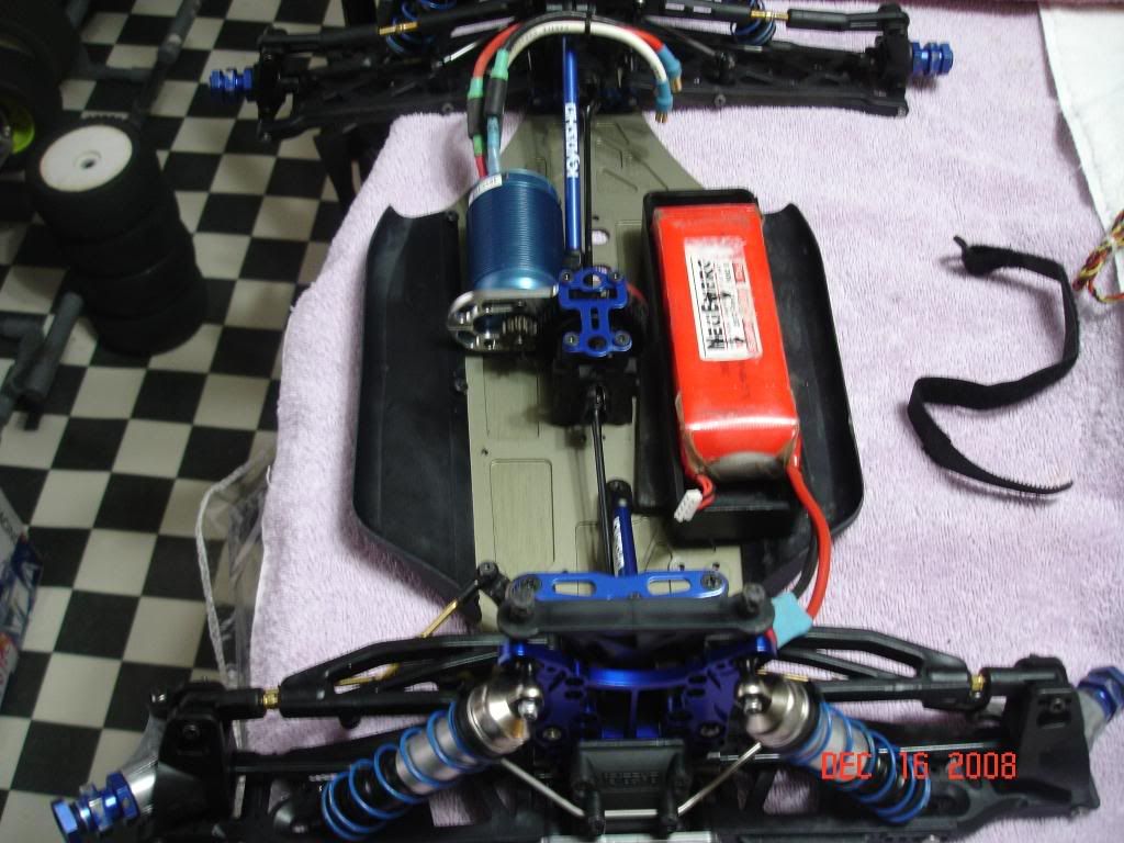

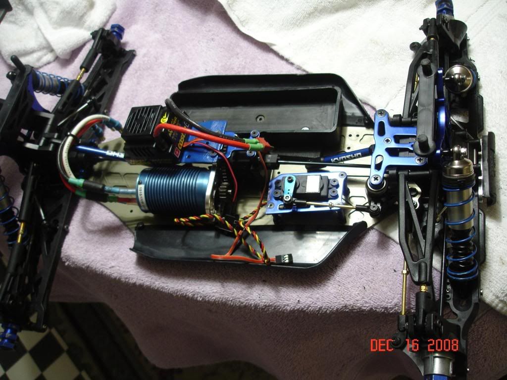

Completed pics minus the tires. I'll be running LPR rims with CF MTRs.
I'm still waiting for the E-revo rx box which will be installed where the rx is now temporarily velcro'ed to the mud guard. I'll post some pics later with the tires on.
Comments and feedbacks are all welcome :cheers: :cheers: :cheers: .

I'll be running a 5S setup using Neu 5AH lipos. Right now, it's geared for 46 using the stock 50T metal spur and 15T RCM pinion. I tried installing the plastic 46T spur with 13T pinion but the mesh is not right. Depending on what I'll find out when I do my initial run, I also have a 48T spur and 14T pinion as spares.

i would suggest ditching the 30K unless your just bashing, the st-rr i built for josh had 15k in the center and itll flip over backwards and lift the front end at the blip of the throttle..... id try 10k for any kind of track use. im only running 7k in the rc8t and itll still loft the front end

ours are built strictly for track duty and racing, if i only bashed id have a 100k in the center so i could do wheelie and flips on demand.

what does changing the center diff fluid to 30k but leaving the front and rear the same do? does this make the 4wd better?

I change it to 30K thinking that doing so will prevent unloading of the front tires. We'll see after my initial run. I'll change it back to 10K if I'm not satisfied with it. What your setup on you 8T?
