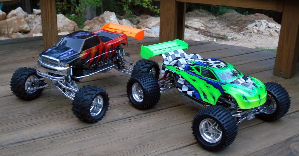

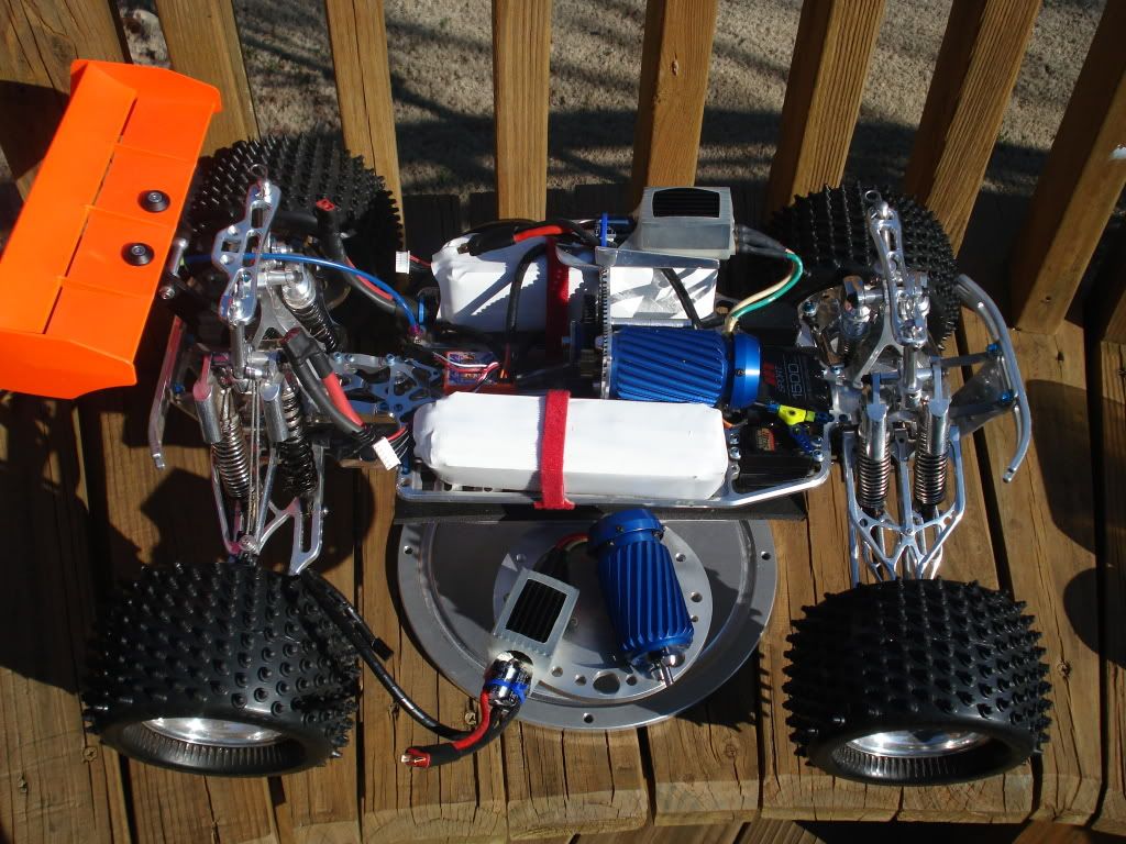

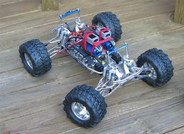

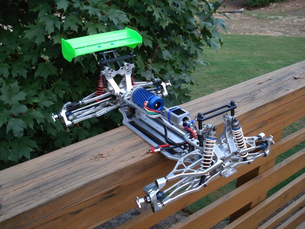

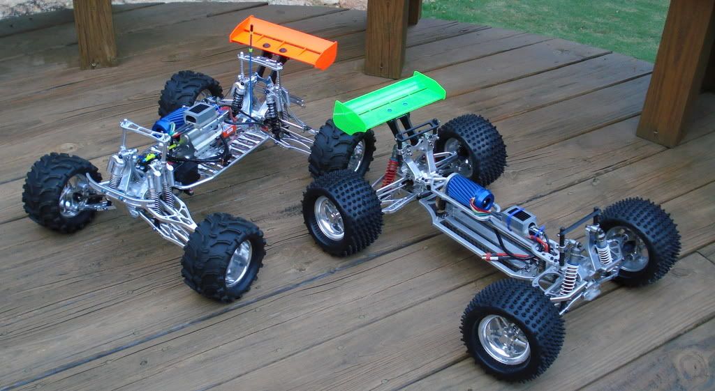

i love the Plette's...you can get them here...http://www.icare-rc.com/plettenberg_pricelist.htm#cars
here are some pics!!...Major power and the best on the market!!...You get what you pay for!!
My custom Direct-Drive E-maxximum chassis!!
Dual Big MAXXimums on 24cell NimH...
Single BigMAXXimum on 5s2p...

Love those VBS bulks. Just plain sexy!!
Nice trucks.

@Plettenbergs, did you ever pull the throttle to 100% when the car was standing with the dual Big Maxximums?

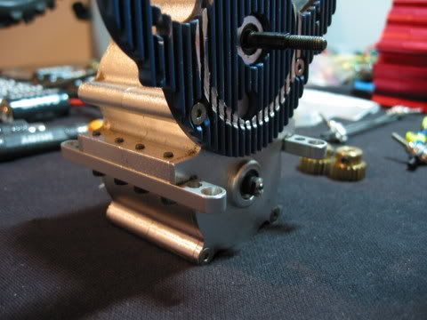

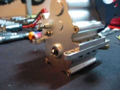

Dual PLETT's all out from a dead stop is not advised...this will happen to you!!
The front and rear drive cups sheared right off!!But my UE spider8's,all titanium UE drive line and my ULTRAMAXXED metal trani gears were fine,thank GOD!...Driving Duals is like having your finger on a large machine gun trigger(GAU8)...Very exciting!!... Press the trigger(big smile) and hold on!!
