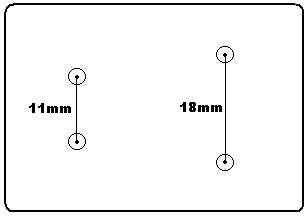

I was just going to replace the diff braces in my GTP... If I can find some with a similar bolt pattern it would be nice, otherwise a little drilling doesn't bother me. Does anyone have an idea what would be a suitable replacement?

Post up the hole spacing but maybe close to ofna lx

The front is 18mm wide, the rear is 11mm, and the holes are centered L/R. *Edit* Would this bearing work? It's 6mm wide, is that extra 2mm going to be a problem or is there a need for lateral shimming?

Easier to just get these.
