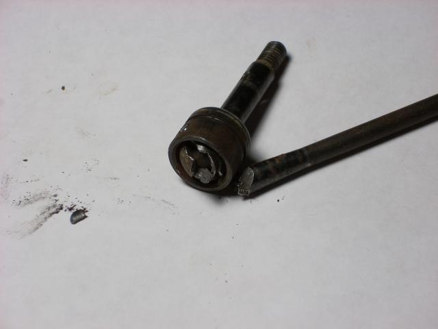

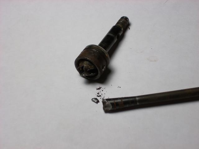

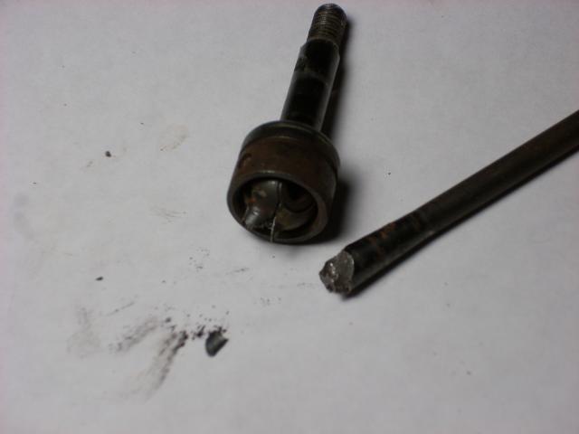

THS brand CVD's
Here are the carnage pics -

I've heard good thing about the MIP1665 CVD's. Perhaps give them a shot as a replacement?

If I can get them for a good price I don't see why not. I am going to call or email THS and find out if they will warranty that CVD, worth a shot.

These are what I would have to get if I go MIP since I don't have 3.3 style knuckles and such. http://www3.towerhobbies.com/cgi-bin...&I=LXDXN7&P=SM
Those should be fine right? If THS replaces that broken CVD for me, and I end up breaking another one, then I will go with the MIP's for in the rear at least.
