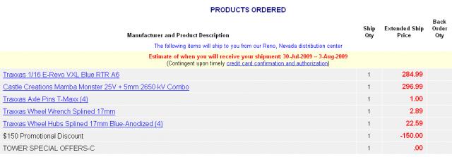

"cough..cough" i couldnt stop myself
Name:	Untitled picture.jpg

So yogy you are stuffing the MMM in the 1/16 right?

Hey...I stuffed an 1112 and a MM in mine, figured he was gonna one up me.

lol worth a try :P its actually for my 8ight B running it on 5S, i hope by next season (winter time) i`ll have all my vehicles in working order . and u know what i needed to get up to $600 so i could get the $150 discount :D haha

Where did you get a discount that high?

He's not in the US. Most international customers routinely get larger discount codes than us here in the US.
