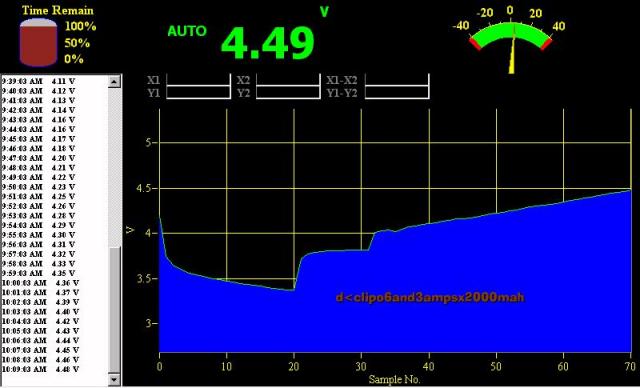

I have a tiny bit of experience with increasing the voltage on lipo during the charge , since all my old packs are so worn out that I can set the rate at nearly anythig I want and they will hit the cv stage very early (sooner) in fact most times I leave all chargers set to max current and even on a tiny battery if the rate goes over the max at the beginning it's no big deal.
Here's what I did after most said I was crazy: My theory was that it wasn't the high voltage that ruined a lipo while charging, but rather the voltage at rest above 4.25 (or whatever you like for a max) I like saying "4 and a quarter" it sounds nice. Anyways I figured that whatever the voltage was up to the full mark was going to be ok and it only climbed to 4.5 on a cheap cell. I still maintained the max current spec of the cell and charged it with CC , and eliminated the CV stage alltogether.
This allowed the cell to charge as fast as a NI cell (at a constant rate) There's no apparent cell damage or heat increase , but the trouble is predicting the "full mark" which I am working on. I'll post a graph as soon as the garage pc is up and ruinning again.
ps , std warning "don't try this at home" or the world may end. That's what most told me.

I predicted the full mark based on total capacity and am working on perfecting it. It sure isn't very complex, but so far haven't found a fool-proof method. I can charge a familair cell at the max rate right up to the full mark without the cv routine. If I can duplicate the methond I use manually then an automatic proccess can be used and save a bunch of time. The voltage can climb to whateverr it wants to 5 volts perhaps, my theory is that the voltag attained during the charge proccess is irrelevent. Only the ending voltage AFTER the current is stopped.

5volts = fire

That's what everyone else said too. Here is one such graph that go to 4.5 volts. I will do one to 5 volts and see temp and pressure.
