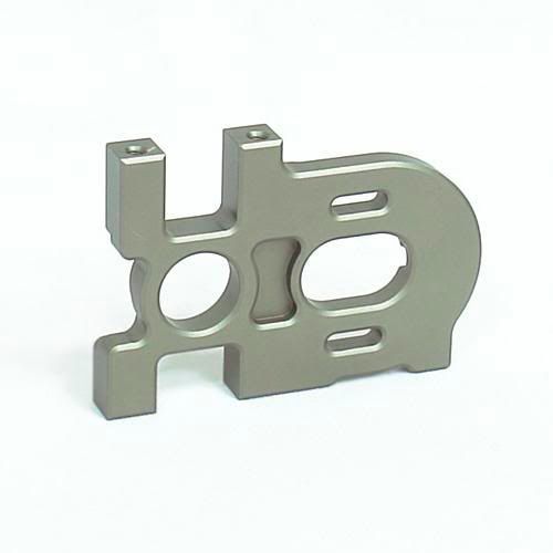

I don't know, I'm a little unsure now. I ordered it with the 50T spur. When I went and looked at the F8T motor mount it looks like the screw slots will have to be lengthened to allow the motor to be moved over enough to mesh properly. Hopefully won't have to do that, but if it is necessary it's a simple mod to do. Only other thing might be shimming to get the Slipperential to fit in the diff mount, but that's also simple.

I am not familiar with the Caster motor mount, but the Slipperential will drop right into the center diff area (same size as the stock diff from bearing to bearing). The motor screw slot length would be the determining factor(in other words, it will work no problem, but gearing opportunities will be limited by the caster motor mount). My mugen motor mount with the caster shims would work perfectly on the Caster truggy. :)

OK well let me do a test fit when the Slipperential gets here, and I'll go from there. There's a good chance the motor screw slots will just need to be extended a bit. Not that I don't like supporting RCM, but I'd rather use the stock mount if the required mods are minimal. If it looks like it's going to be a big job to make it work then I'll look at getting the Mugen mount.

EDIT: Here are both the Caster pro mount and RCM Mugen mount to compare. I think the Mugen would work on the F8T like Mike said, but the screw slots don't seem any longer, so they both might require modification. I'll report back once the Slipperential arrives. Thanks for the help Mike!
Caster:
RCM Mugen:
