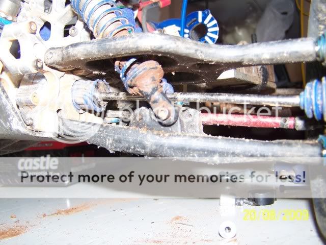

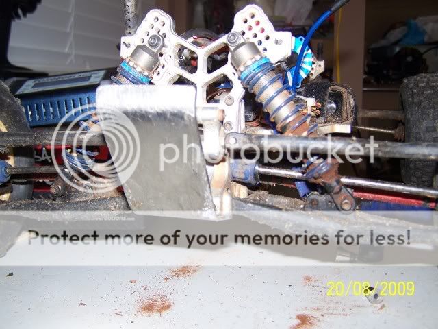

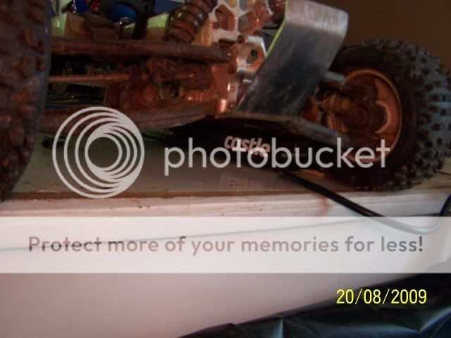

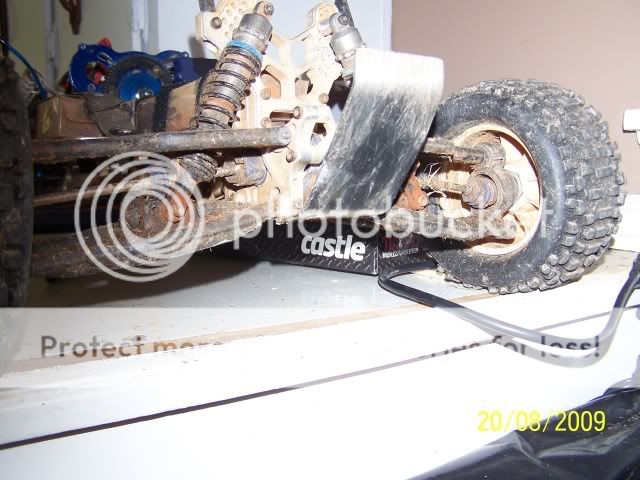

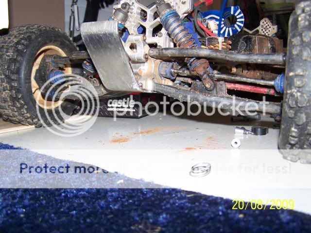

I see one big issue after seeing your other pics. Your battery is almost sitting right on top of the rear diff no wonder it bottoms out. Put it on the side where it belongs and mount your esc there or just leave it open. I would definatly check your oil levels in your shocks because they seem to be leaking a little. While your at it check the bladders like was said previously. 80 imho weight is to high I feel 50or 60 would be better .
