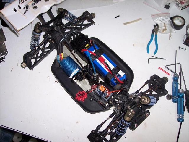

It ran great today at the race. its been a long time since i ran buggy (about a year) so it took me most of the day to get back in the swing of things with the buggy, but i was turned out awesome i lost to josh with his mp9 by only 1/20th of a sec. we were rubbing wheels across the line, great race at the end, i waited for him twice during the race but id rather run a close second and have a good race than run off with it. all the same it was a blast.
Report:
i was geared 15/42 running crime figthers, motor was only 130-138 after 7-8 minutes of running (6 min races with 3-4 extra laps usually) battery never broke 105, MMM never broke 135.... very happy with the setup, and i only ran the pack to the cutoff 15.5v once at the end of the day and got right at 13 minutes so its got plenty of runtime for our 10 min mains...
