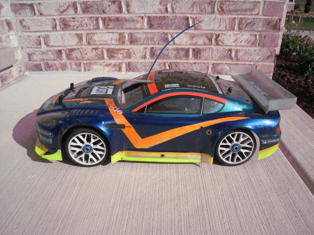

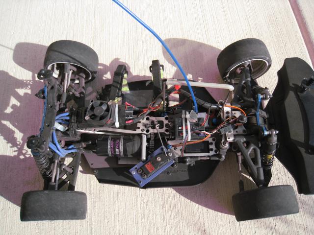

Here is a couple of pics...of my on road...sorry about the poor lighting and the fact that the car is dirty.
The suspension needs work, but it is fun w/the 2200/ccneu on 5s.
here's my Mayhem with the ofna parts.

here's my Mayhem with the ofna parts. - 11.11.2009, 05:00 PM
Sorry for the delay here are the pics.
hope this helps...
