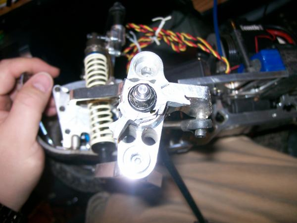

Cutting is different. On second thought, with the size of the hinge pin and speeds the dremel is only capable of, there really isn't much danger, just a lot of white sparks.
