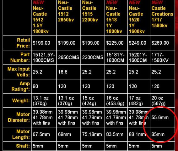

Patric, looks like you put 2025 diameter as the 1717. Is that a pre-introduction?

so thats not the correct diameter of the 1717?
  (#164)
rabosi
Posts: 326
Location: Levittown, NY
11.30.2009, 11:47 AM
I think Himalaya is right. In post #11 Patrick show a caliper measurement for the 2025 to be 53.67mm. I did a rough comparison measurement from the photo on page one and it seems like the diameter for the 1717 is around 45mm (+/- 1 maybe?).
