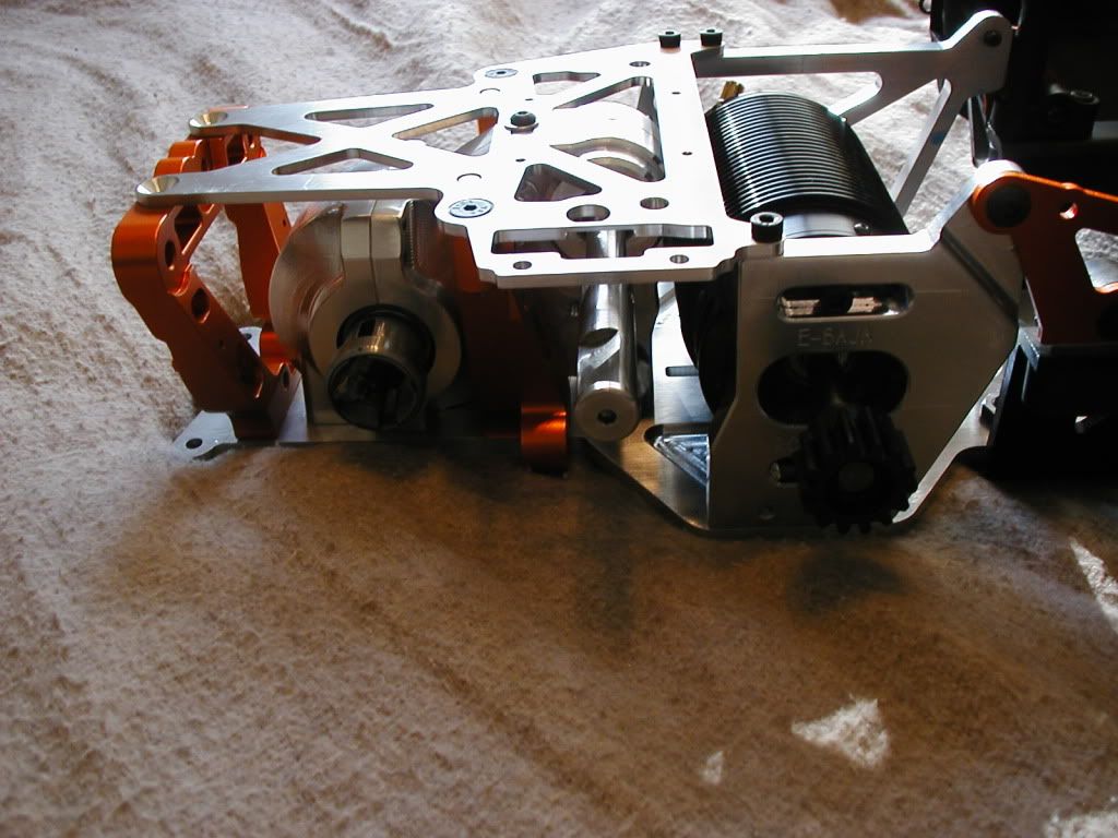

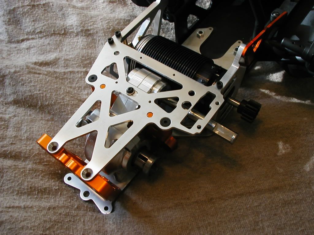

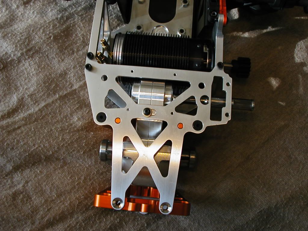

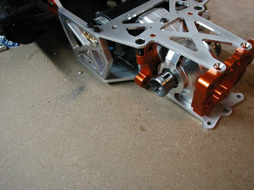

Looking good, Mohan. Don't forget to install a screw on the non-spur side top brace(mising in the pictures). I actually cut the middle of the cross brace off on my baja and kept the "ends" for spacing. Threadlock is your friend on the metal to metal attachments, too(the top brace, motor mount and brace plate, and lower plate connections specifically). That is a quite aggressive setup you have there, too(10s, 30 series motor, big pinion) - I hope you have a lot of space!
mike
I didnt fasten the left plate securely as I had to take it off to solder the wires. I have now firmly thread locked all the screws. On the left top plate there is an empty counter sunk hole where the screw would have gone into the rubber plastic / damper fixed to the engine. it is an awkard piece - do you think I need this?

Yes, I think it is wise to use the left countersunk screw - the wierd angled molded plastic piece can simply be trimmed with a dremel for clearance. IIRC, the screw is an M5 or M6 with a lock-nut on the bottom side - this will add significant support to the top plate, as the next closest screw holding the top plate own is all the way at the rear of the bulk.
Lehner motors are excellent, though expensive and poorly backed in the service department in my opinion. 4 pole is better in the Baja specifically IMO as well(more torque at startup/smoother startup in sensorless operation and the Baja ha a fairly high rollout).
