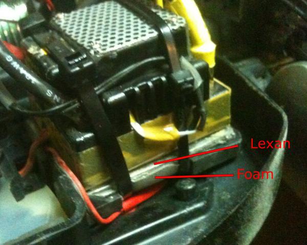

I used a piece of high density foam about 4-5mm thick to cushion mine from impact and shoe goo'd it to my esc mount, then shoe goo'd a piece of lexan scrap on top of that. Something to consider.

KniteWulfe
Posts: 51
Join Date: Sep 2010
10.08.2010, 07:08 AM
Here's a pic of how I do it. Surprised that still happened with the foam.
