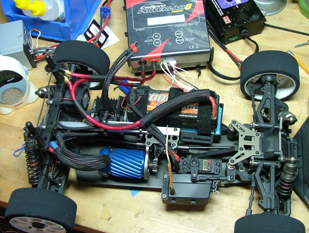

Charging a 4s @32A with the Powerlab + 20 dollar PSU. 8awg wires were at 121F during charging.
