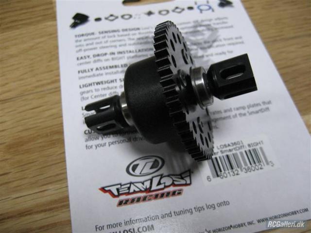

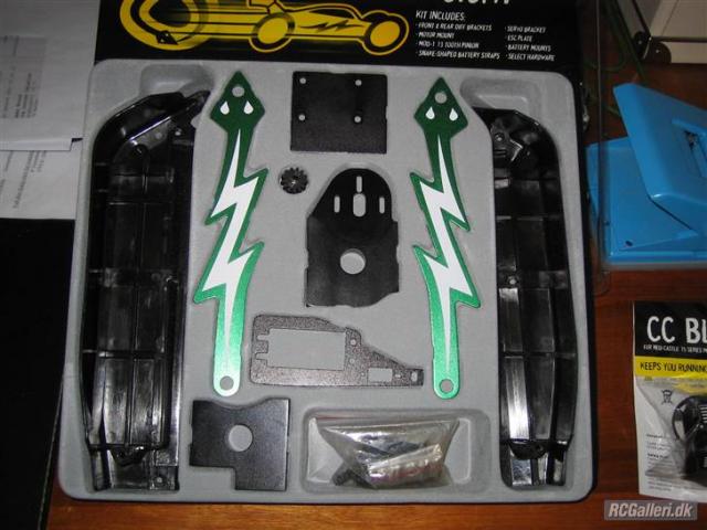

Hi guys! I have been following your forum thread`s for a while-enjoyable reading Now I´m in the progress of removing my gearbox on the old G-Maxx and want to put in a center diff, since the gearbox isn`t holding up well against my NC1520. But could you guys plz help my out with this? I bought a CC losi conversion kit, as I couldn`t get a hold of Mike`s uni center diff/motor mount, then I bought a Losi smartdiff to drop in there-but even with the 46T spur it won`t fit inside the g2r chassis. any suggestions as to what spur/diff i could use?? don`t want to cut my G-maxx chassis.

Try a 44T spur gear. Mike has/had Kyosho spurs in his shop. They fit between the x-braces of the G3, so it should fit in the G2R as well.

I’m using Mikes center diff mount with a 46 tooth Slipperential on a G3R. There must be something different with the Losi diff. People usually don’t recommend the smartdiff for brushless, something to do with durability I think. Maybe you could try contacting him to run another batch. If enough people asked again, I bet he would do another run.

Losi Makes a 43t Plastic spur for the 8e. I guarantee that'll fit between the braces and on the smartdiff. The Kyosho always leaked on my 8ight diff...

Thanx Zippybasher, will try the 43t plastic. I have email`ed Mike about the cd/motor mount. will wait a while for reply. I will now try to post a few pics

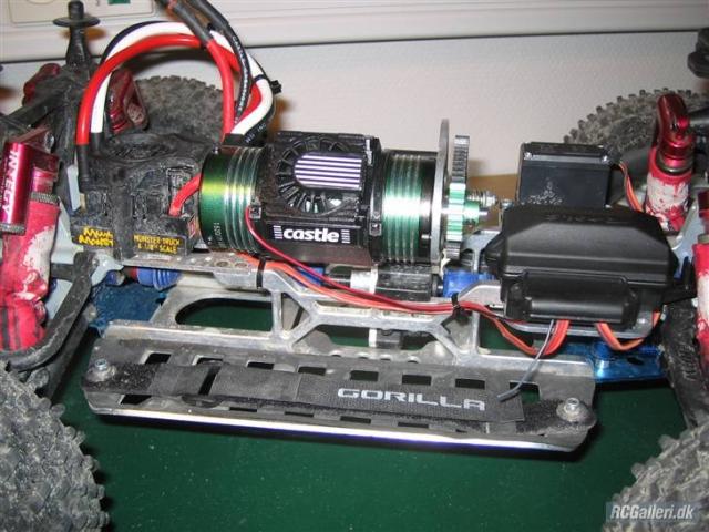

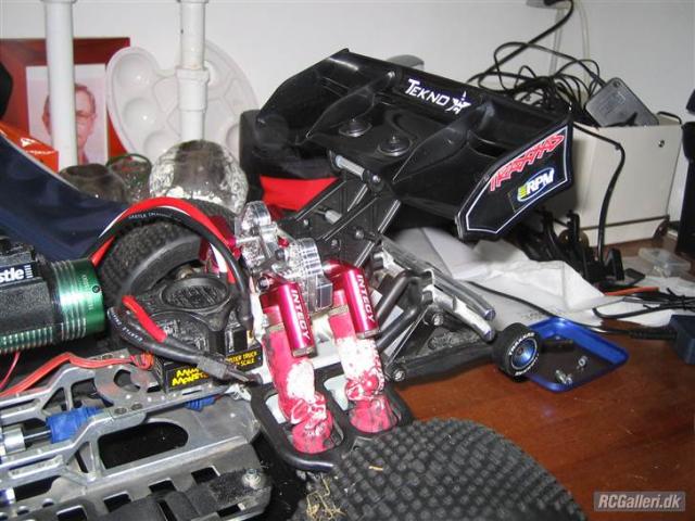

latest update
bruun
latest update - 05.03.2011, 03:01 PM
now running 6s on a CC1520 with 21/70 gearing still with original gearbox.

Not bad Bruun. Considering the handling it looks like you need a UE Mono-block to lengthen the chassis a little bit, and you may want to condsider installing axle adapters to widen the wheel stance just a bit as well. You just have a lot of power for such a short package. Nice looking ride though.

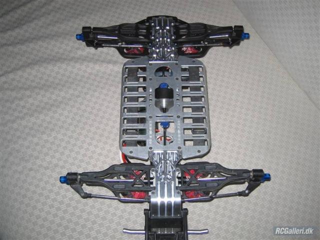

I have been looking at the UE Mono-block, but i`m actually quite happy with the truck as is. It have been geared down to run approx 55kmh. I am going to install the RC-Monster Universal Center Diff/Motor Mount, which I just received as the 1520 tends to break the input drive shaft in my G1 tranny

Edit: Running a SmartDiff in the center position with brushless is generally not recommended, unless it is a race rig. SmartDiffs require regular maintenance and even more maintenance (and parts replacement) is required with a brushless setup due to the increased power over a nitro setup. So be prepared for that if your going to use the SmartDiff.

Thanx Overdriven, I have received the new RC-Monster uni cd/motormount, which is looking seriously beefy! and based on what You are telling me-(and the fact that the losi diff doesn`t fit) I will we looking for something else, Suggestions? the motor will be a castle 1518
07.13.2011, 03:18 PM
Any regular 1/8 scale diff should fit fine- I'd look at the ofna and hotbodies ones, very cheap on ebay and easy enough to tune ( to reduce wheelies ).
