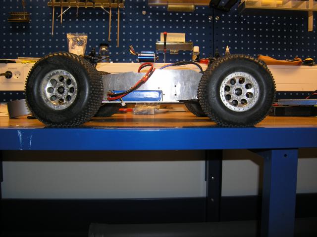

A quick picture of the fatty's ground clearance with Terra pins. I put 1½cm of fuel tube inside the shocks in order to get horizontal "arms"
Here they are:
Thus I have an "on-road" as well as an "off-road" shock set :)
The truck weights in at 6,5kg (14,33 pounds) with the 1717, terra pins and 2 x 5800mAh Turnigys

Looks good Nixpus! I do like how you did the batteries, was thinking of the same thing if I redo my Savage 5T conversion.
