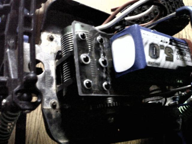

I have a picture attached of the mounting, I was thinking it's not getting any airflow. Windshield is cut out on the body too. Do I need to fan it?
10k
From your picture, I'd be concerned about the airflow - that plexiglass(?) plate looks like it would shield the motor from a good bit of the airflow. Did you use the same setup in your first e-MGT that didn't have heat issues?

It's lexan, but yeah, plastic over the top of the motor.
I didn't have the battery up top before, I had it on the side. I can do it in front of the tranny too, I can always try that to get more flow.

Took off top plate of lexan and moved the battery to the front of the tranny. Also put punch control to 50%.

I think the plastic removal helped somewhat, I'd like more of a buffer though for temps, but at least I'm not in the danger zone.
