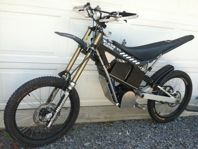

Hippie - thanks for the compliment, Mike. I did some more last night and this morning - I managed to get the stock side panels on with some shimming and broke out the trusty propane torch and bent up a rear fender(not perfect, but not bad for a ghetto prototype). Pics attached
mistercrash - thanks for the compliment. "factory" is the look I was going for. The modules are held onto the bike using the two lower screws on each module(into the aluminum post on either end of the modules). I made a custom lower plate that bolts to the bike in place of the original battery plates. I still want to make a top plate for added security, but they are reasonably solid and I wanted to ride this beast. i may have John Holmes string me up a dirt bike rim onto the rear hub and get a meatier back tire on this thing - along with a gear change to get it up into the 50s(maybe - 40 is pretty fast in the trails already).
Having ridden this bike when it was a 200+ pound, top heavy lead sled I can say that the lipo conversion was worth it and then some. The 50 pound weight reduction and much lower Cg results in a dirtbike that handles like a dirt bike now(top heavy and sketchy in the rough b4). The power is unreal, too - it feels easily twice as punchy as my 300 thumper I usually ride and feels stronger than my 400 KTM supermoto, too. A rookie rider on this thing without limiting the power is almost certain to end up badly!
