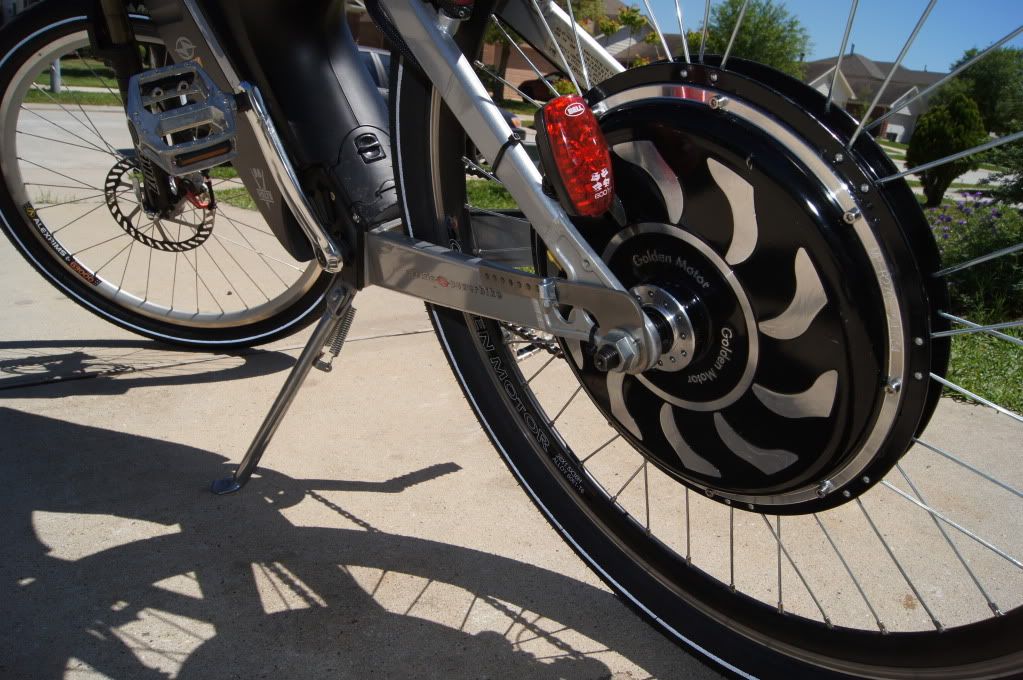

I wish I could move the rear of the bike by 2" for a longer wheel base. I need to learn how to weld.
Yours would be so easy since it's a cantalever system.

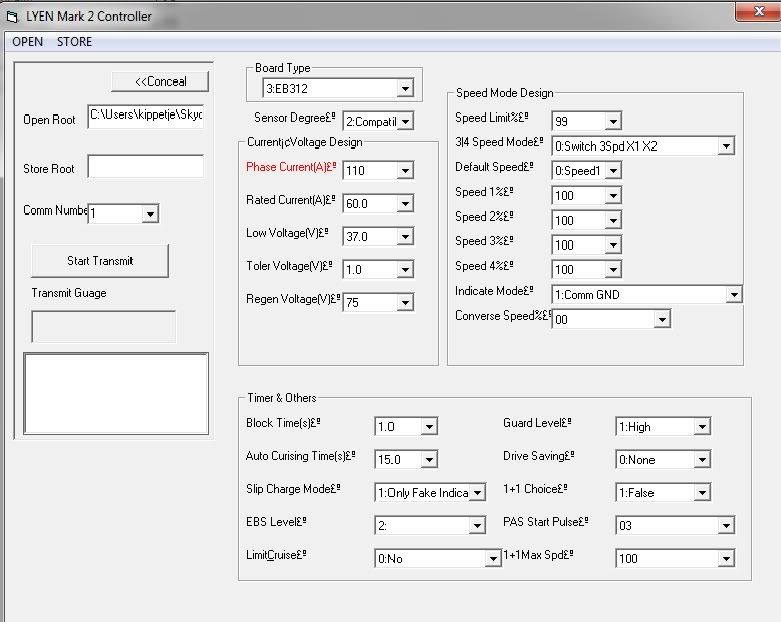

I reprogrammed the sensorless controller and now I pop wheelies. Top speed is the same, but man it gets there alot faster I'm also using some Blue Lipo 20C packs now. I'll post more info on that one later once I get some more cycles out of them.
