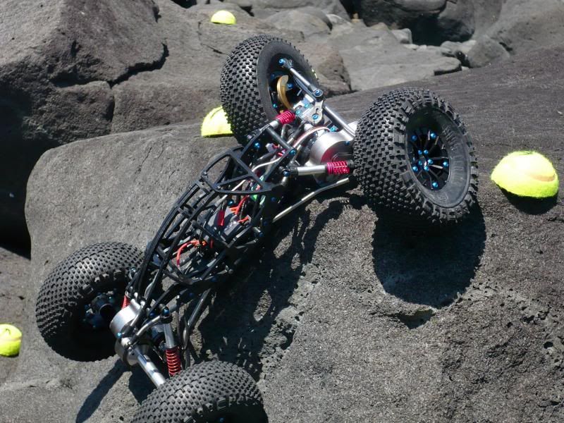

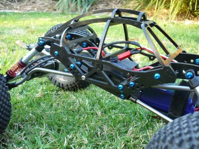

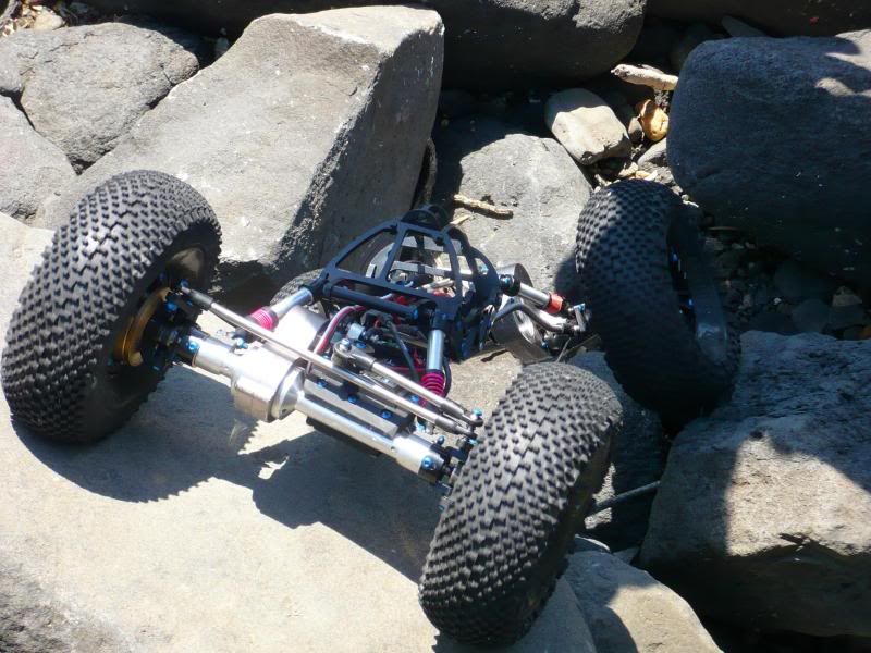

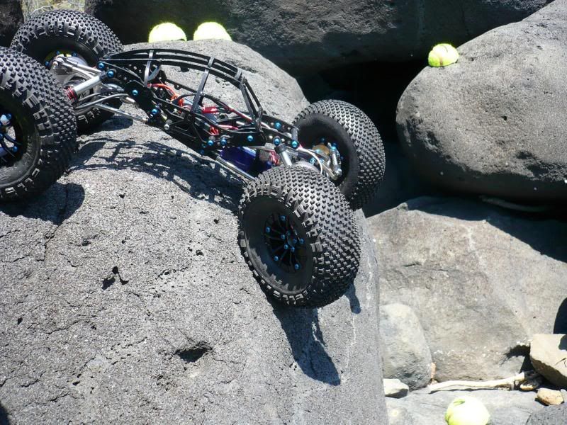

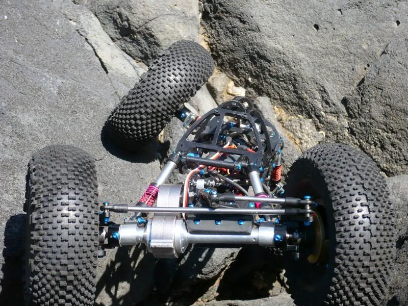

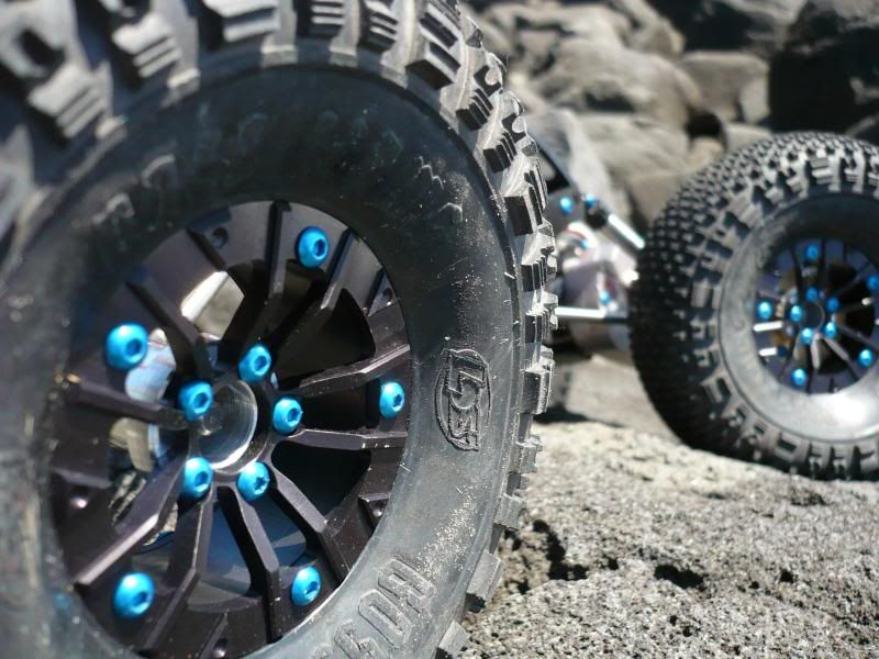

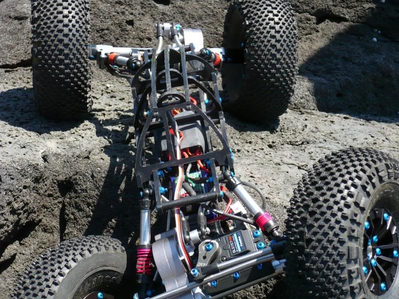

Went out for a crawl on Saturday with a couple mates for it's first test drive. It wasn't 100% finished yet, but almost there. I decided to run the BCs and eritex wheels simply because I made my weights to the absolute maximum size possible and they no longer fit VP wheels. I had my old faithful firm inner, soft outer CI foams from my rovers, but I believe they are a bit firm. The other problem I had was the Charlotte's and the BCs would not play nice and I ended up pulling 3 beads (and this is after about 4 goes at mounting the things properly). The slot in the eritex wheels is simply to small to hold any bead properly IMO. So they will be getting lathed shortly.
Now for the good news. Everything pretty well performed faultlessly minus a couple loose bolts and nuts. The mini pullers and wheelspeed to boot and seem to be able to power the rig around most things with no drama's or temperature problems. They will stall in hard digs or binds, but I guess that is to be expected. The shrunk mamba micro's had no problems handling the pullers, and most of the time they barely felt warm. And finally the futaba servo is simply awesome, I was running it on 7.8v and it was only warm, but had enough power to swing the rear end of the rig around no worries. I think I only managed to stall it once, and it was really wedged in.
Onto the chassis. The rollover, as expected, was excellent. Thanks to my "brilliant" driving and a bit two much wheelspeed with the pullers I tested this quite thoroughly The handling was quite good also, for everything from precise slow speed crawling to going flat out up rocks and doing backflips. This chassis will definitely be staying put with very little changes. Hopefully CrawlerX should have them released shortly for everyone to get their hands on them.

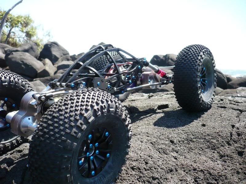

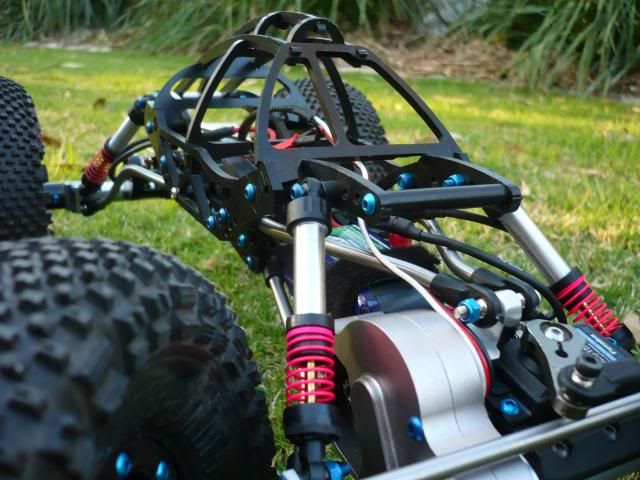

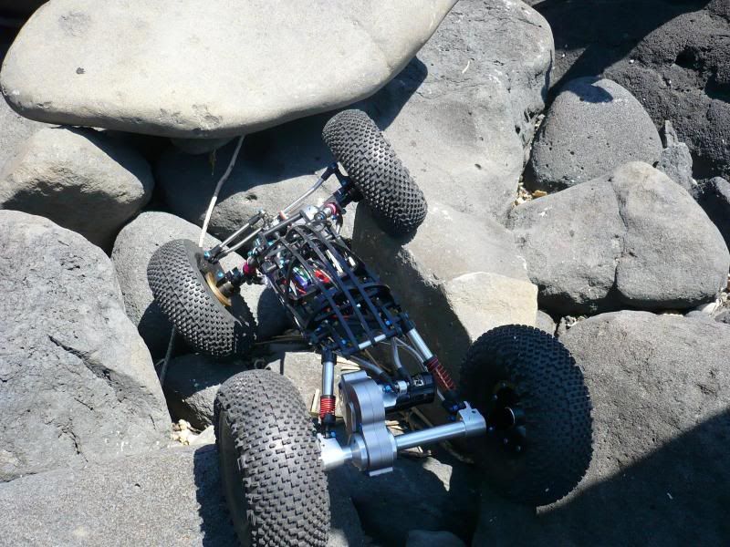

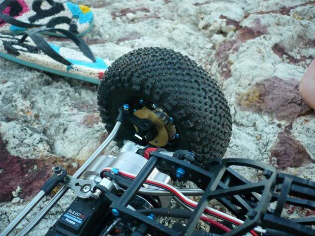

Pictures, well unfortunately I was having to much fun 'testing' to take any pictures or video. So I'll just have to end with a couple I took at the end of the session. You can also see the final design for my knuckle weights.

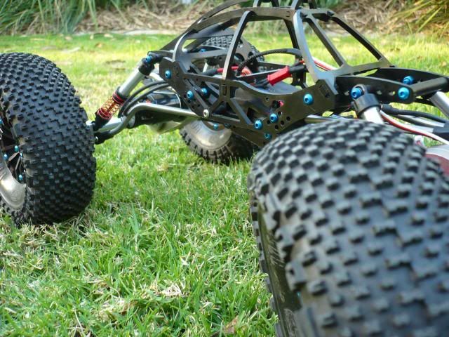

Done minus panels

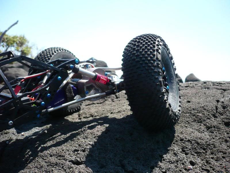

Went for a crawl today at the old faithful spot. I didn't have a chance to make any panels yet. It seemed to crawl quite well, apart from a few minor things that I need to fix. The chassis held up excellently to some decent abuse, along with everything else. Video should be up shortly also.

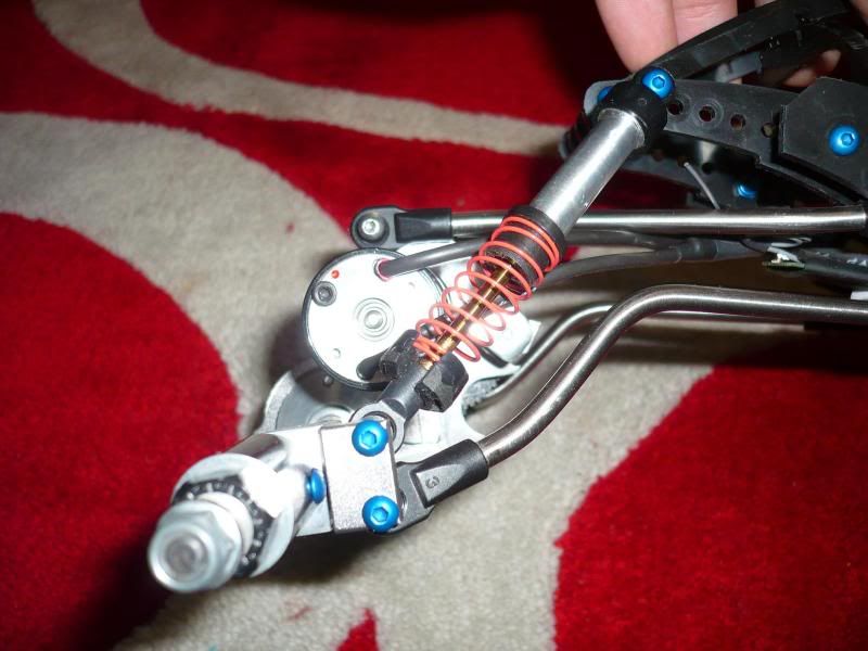

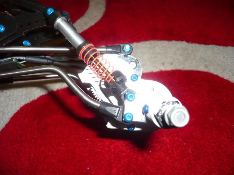

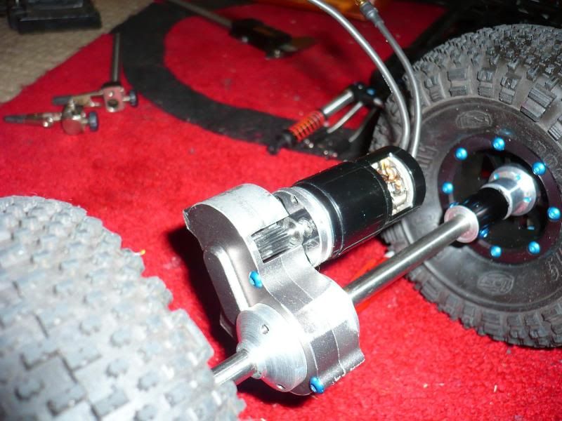

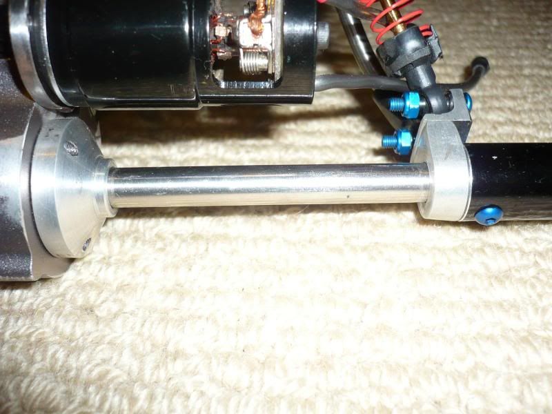

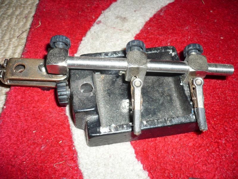

At 8mm I believe I hold the claim to the smallest berg tubes ever produced. Not finished yet, but not to much further
Also on a completely unrelated note my third hand, has suffered a debilitating spinal injury

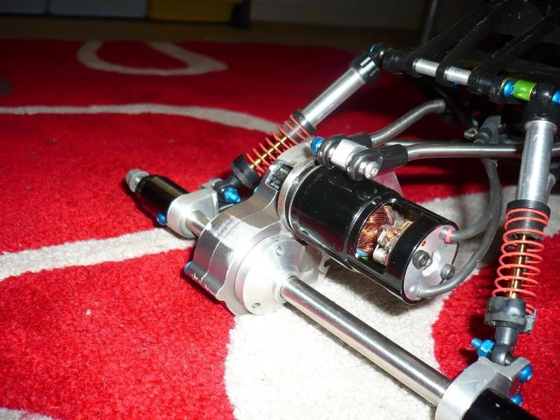

Today's progress.

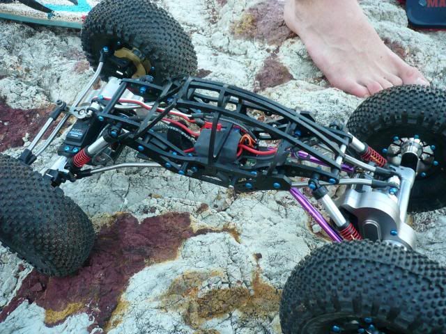

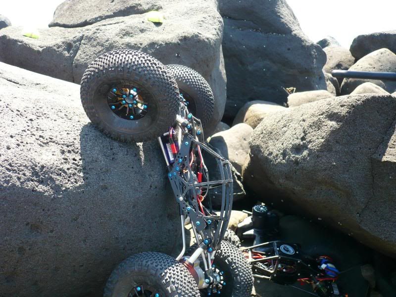

Here's a few pictures of the rig from the social on the weekend. Thanks Steve for the pictures :thumbsup:
Very happy with the rig so far, and am proud to say that my Crawler X chassis'd rig was the only rig to make the climb at 1:04 (thanks Jakesy for the video) It might not look like much but it proved to be quite a challenge, no matter what rig you were driving.

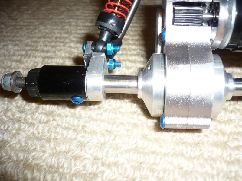

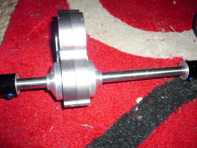

Here's some pictures of the very first set of Ras Customs wheels. Granted they aren't completely mine, but they do prove the concept.
I later realised I should have got the weight of the complete wheel, but just as a comparison here is the weights of the original wheel, and the parts that replaced it.
The wheels proved to be very easy to mount, about the same, if not easier than the 'normal' style beadlock. Best part though is it will fit about about 49mm knuckle weights for even more weight under the axle.
Original next to the new internal style
