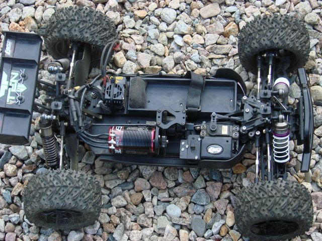

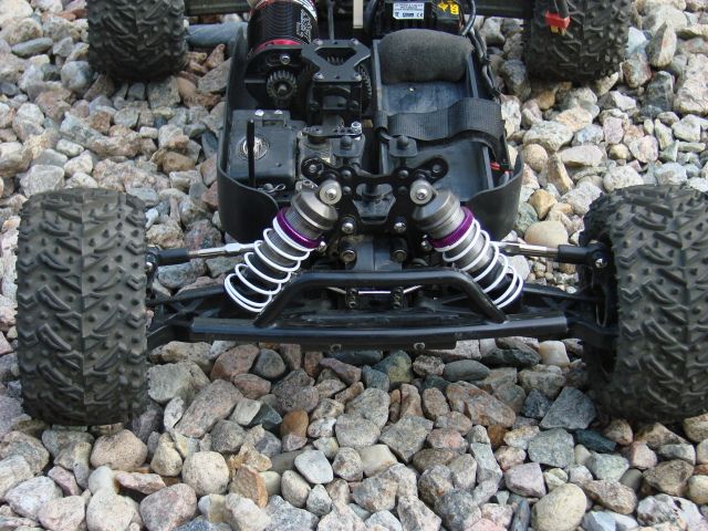

Ok all....if you really want to have a set of front shocks that should withstand anything....i give you the Ve8 fronts...
and lets not forget about the rear...RC8 buggy fronts..
This setup should be able to handle anything you throw at the truck. Speaking of which...the Ten T has surprised me on how durable it is. My friends and I frequently visit a bmx homemade track and our motto is simple...go big or go home! Needless to say we jump quite high and after countless beatings, the truck has been unscathed except for bending a front shock shaft.. So I decided to upgrade from the Revo shocks ( CRT.5 setup )I had to something bigger and longer. Result is the suspension is super plush. Suspension feels just like my truggy.
Happy jumping all!

Thanks. Actually, there is room for a slightly bigger bore shock on the rear as well especially if/when the rear toe is lessened...not sure of the RC8's bore at this time.

forgot to mention.....on the Ve8 shocks, stock springs w/35wt oil
