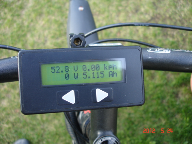

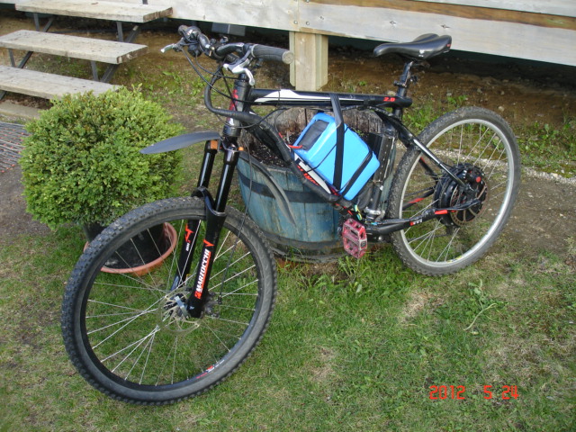

Here are 4 pics I just shot. Battery mounting is TEMPORARY (along with some wiring), was doing work on it and just threw it back on for the pic. Tires are temporary as well, going to purchase some fat sticky rubber tires soon to really grip hard on our bad roads here. I know I loose about 4kph top speed (and thus Wh/mile) vs. road tires, but the safety and handling is well worth it.
I was pondering the idea about putting the battery in a standard size ammo box and using a rear cargo mount, as they can hold 40+lbs apparently.
Cheers

Very nice even with what you call temporary stuff on it. It looks like a nice, good, solid set up. I read from some people that a big battery in the rear on a rack makes for some funky handling. Many have the opinion that the battery belongs in the frame's triangle, just like what you did for a lower CG and better handling.

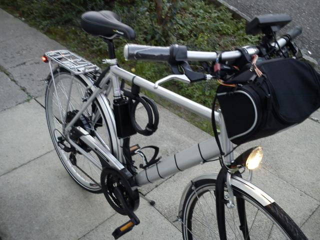

Picture of the completed bike:

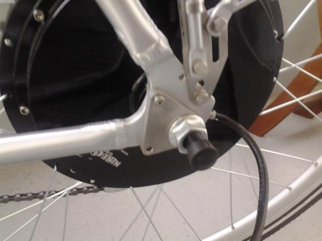

Attached is a picture of my torque arm, which is waterjet cut from 6 mm stainless steel, the slot milled to fit the axle and then mounted to the bike frame with an M4 screw. I have one on each side.

Super nice and clean Thomas. Looks very inconspicuous, but it goes over 60 I love it.
