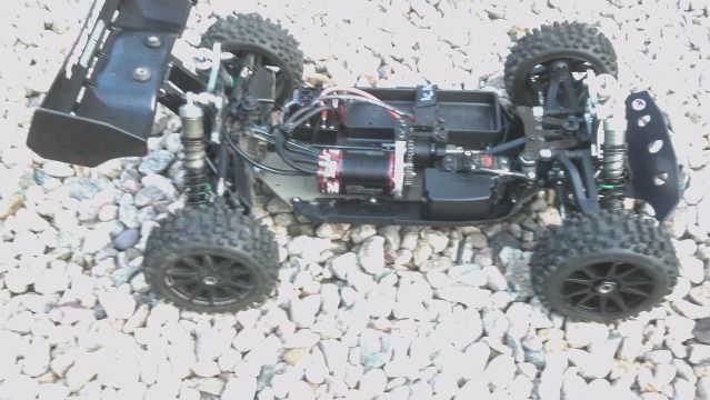

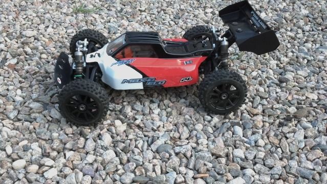

Here's a couple of shots of my mbx6...looks just like the eco version.
