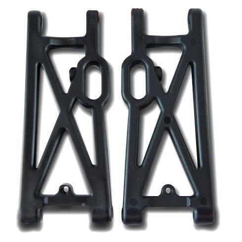

Then saw a complete 'backend' of a Redcat Rampage XB-E 5th scale Buggy on ebay for cheap and thought "give it a try".
Well, it seems like I was really lucky :)
First, I think it can be made to fit on a Savage and second, there are a lot of options to choose from because Redcat and other brands make a whole line of 5th scale cars with similar suspension components. You can even get FLM ball-drive CVDs and 7075rc alloy steering knuckles and carriers for them, very nice.
When you look at those parts, you can see that they have "buggy-stlye" geometry/layout (and not 1950's russian truck geometry like on the Savage) and are very beefy because they are made for much heavier cars. Hingepins on the diff side are 6mm, on wheel side 5mm, bearings are 10x18x5 for the buggy arms with 10mm axles. For axles there are two options, one with a thread at the end for FG-style 18mm squares, one without thread but pinhole which could be used with 17mm or 24mm hexes. Dogbones are 12mm ball diameter with 6mm shaft and also bigger diameter pin than 8th scale components.
There are two different A-arms and knuckles available, from Rampage Buggy and Rampage Monster Truck. The Monster-Truck ones are even beefier and it's said the V3 MT arms are made of a better plastic (PA66) than the ones before.

Pictures of the Redcat Rampage XB-E buggy parts compared to Savage parts, FLM extended Savage arms/bones, CEN heavy duty parts and ThunderTiger ST-1/MT4G3 parts (click on pics to get highres version)
Pictures of Redcat Rampage MT V3 parts (hex is 22 or 23mm unfortunately so the stock ones are not of much use):

Put the parts together for a first rough testfit. Looks good.
The lower shock mounting position on the Rampage buggy arms is almost the same as on a stock Savage A-Arm.
If I see this correct on the photos, the shock mounting position on the Rampage MT Amrs is a little
more outwards, should be better for Innovative-RC or LST shocks.
