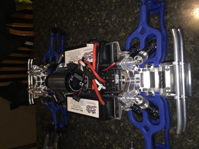

Just be careful, try some spacers from cardboard to get to the desired height. But 30/65?! With that beast you might want to introduce a MOD1 spur/pinion. Gives you better gearing options. perhaps you don't need to lift the transmission that way?
Those RPM arms and CVD's might get you into trouble; just make sure not to tighten the pillowballs too close, since it might cause binding, ruining either the diffs or the CVD's.
Nice project! Sorry that your questions weren't answered sooner..
