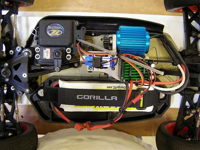

Here is my current setup. I need to work on an antenna mount for it. I have the 36-50 2000kv with 12/46 gearing. I just took a few passes today on the street. What are some steps I can take to keep the ESC cooler other than a fan on 4S ? it was about 95F here today and after my short run the motor was about 105F and the ESC 125F.

What are your esc settings? You could up the timing and see if that helps? From what I can gather the higher pole count motors prefer more timing. You could also turn down the punch control.
Maybe open some cooling holes in the body, and add a fan.

Nice buggy John. Do you have any airflow through your body? I used a toilet paper core to make a duct from the windshield to my motor and it did help, dont know if it was any better than just a hole though;)

That is actually a really good idea. A duct like that could really flow, especially at speed. I may give this a try, sounds good for esc cooling. Maybe make a duct tube that runs front to back, and cut out a portion so that the esc heatsink can sit in the airflow.

I just re checked the settings and found that I was running the old SW.. v.09 and now its updated to v.17 I think I will leave things set the way they are for now and see if that helped.
Rev... off....
braking at 50%
Punch control 50%
Timming normal
LVC 12.4
Also I was not running a body for the road test / shakedown.
