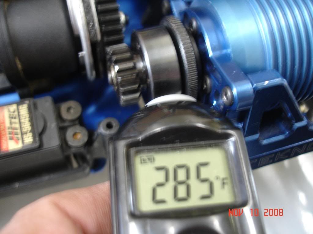

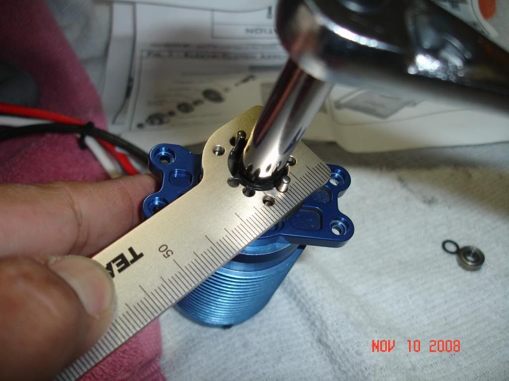

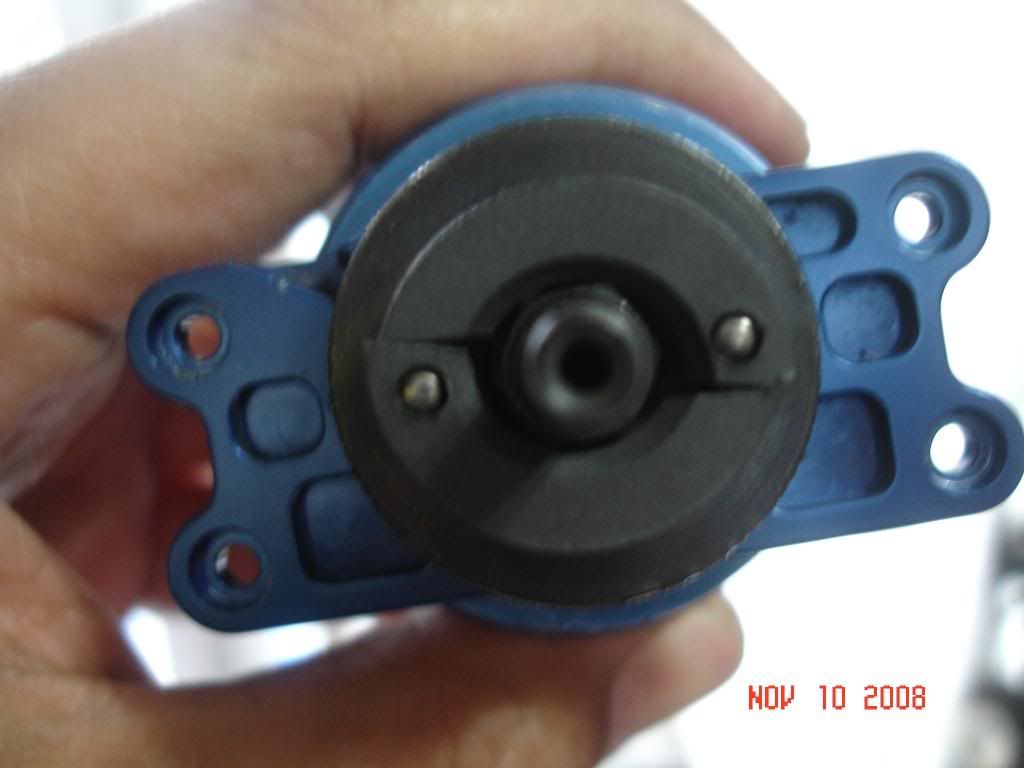

Here's some more update with pics.
Clutch shoe positioned on leading edge. It's been set like this since I started messing with it.
Tightened the clutch nut again using my Kyosho lockout tool:
I decided to install a new stock clutch.
Still the same heat problems.

I suppose I should state the obvious: You should revert to the other shoe set for now! Geez! 285*F is rediculous! What's the melting point of steel???
What other shoe? the 4-shoe? or aluminum shoes?
I'm getting tired of removing and re-installing this elektri-crap . I'll try the 4-shoe clutch with carbon shoes but this time have the shoes trailing and see the difference. If not, I'll just wait for the long-shank pinions I ordered or put spacers and use a regular length pinion.

Whichever set gave you the 150*F temps. It may be too high, but the ones you swapped them for definitely made things worse.
