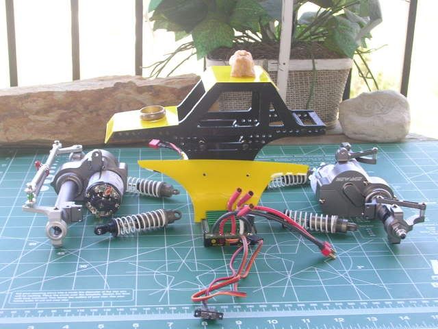

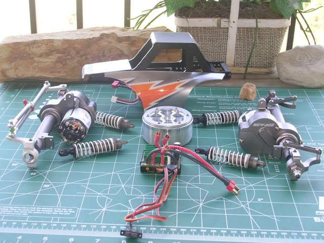

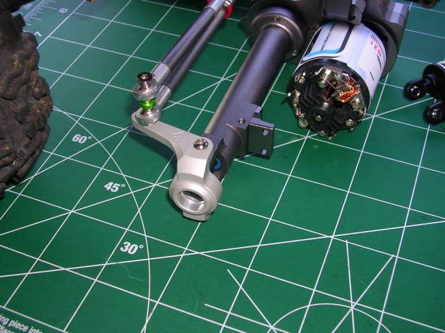

Looks good. I belive you will have to add 3 capacitors to each motor, so you dont get radio interfirance. Nice shocks .

The only thing I'm adding to the motor's are wire and solder.

You may get glitching if you dont have capacitors on your motors .
If you mean upper links . Im using revo aluminum push rods # 5318x & 5319x. Are you going to run the shocks inverted or regular ?.

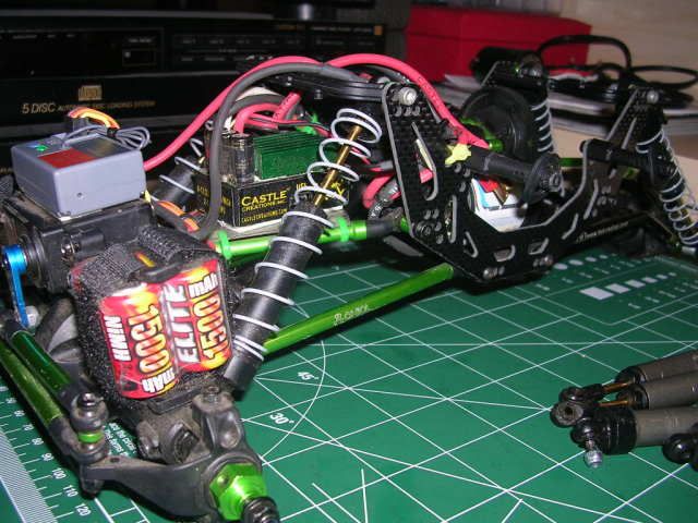

I've never used caps before and certainly have not had any issues. Let's not jinx it.
In fact, as far as my crawlers go, I have never even unraveled the antenna on the receiver. It still has the original ziptie from packaging. You can see it in the picture below. I'm not saying "Do It" like that. But it has worked for me.
I figure the only time my crawler is more than 5'-10' away from me is when I kick it.
I was able to invert the shocks and mount them. Which if it can be done that way is what I prefer on my crawlers. Get the shock body & oil weight down lower on the rig. I have run into a couple of instance's to where I had to mount them "right side up".
