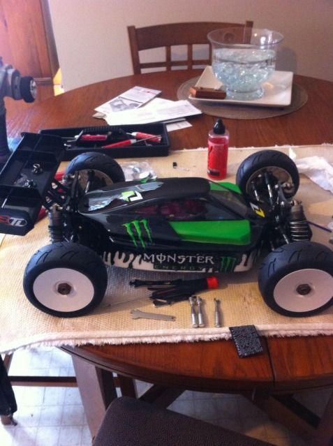

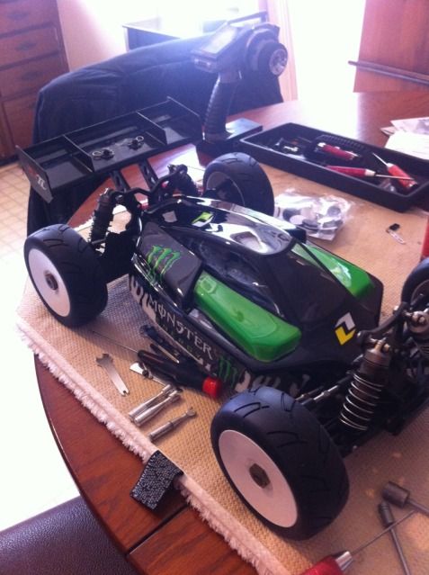

04.28.2012, 06:48 PM
just alittle update
on road mode is a go
