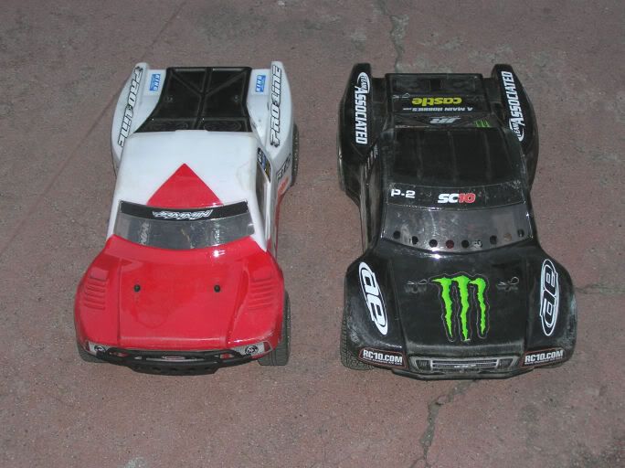

Well I don't own a Slash but I do have an SC10 so here they are for a size comparison.
Jammin SCTRC10 and Associated SC10
Topless

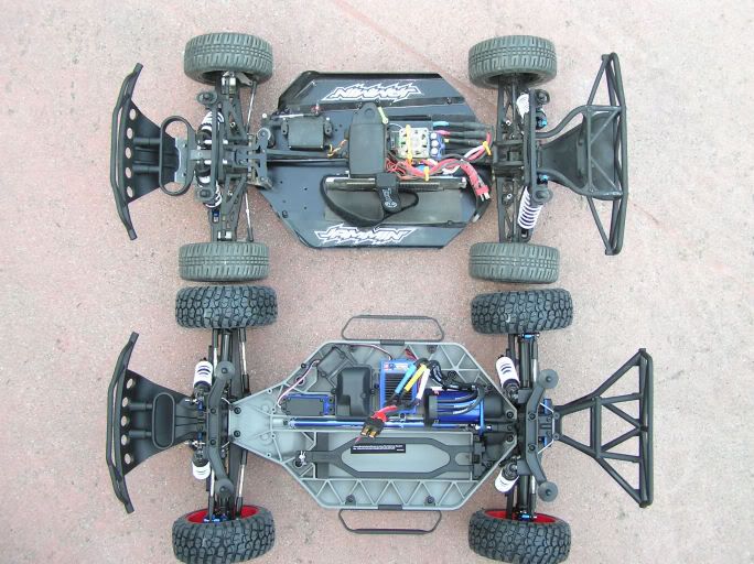

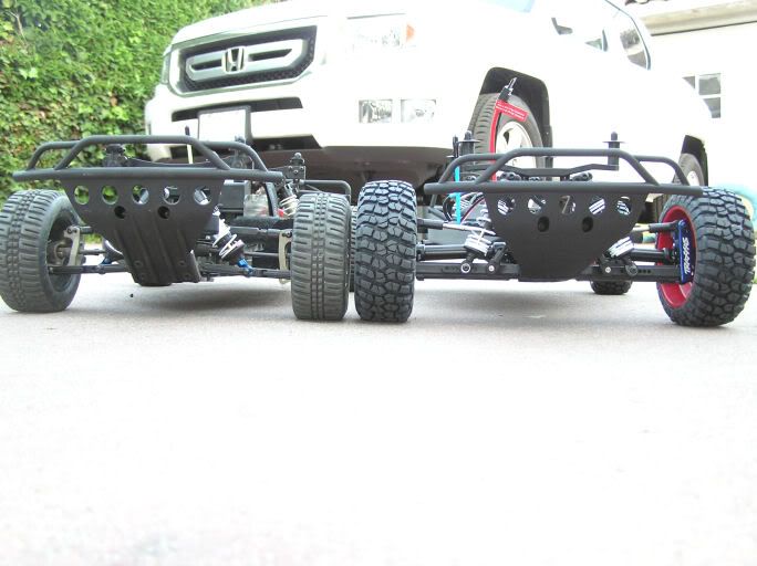

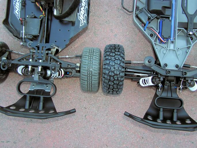

Ok, earlier I posted some size comparison pictures of my Jammin and Associated SC10. I got my hands on a Slash PE 4x4 and here are some shots comparing them. The Jammin has a much lower CG, and small wheels/tires. I have already had the Jammin out on the track and it is a fast, sweet handling truck. I hope to get both out on the track this weekend, curious to see how the higher CG and bigger tires effect the Slash's handling.
Side by side
Tires
CG - With the suspension arms close to parallel the Jammin sits much lower.
