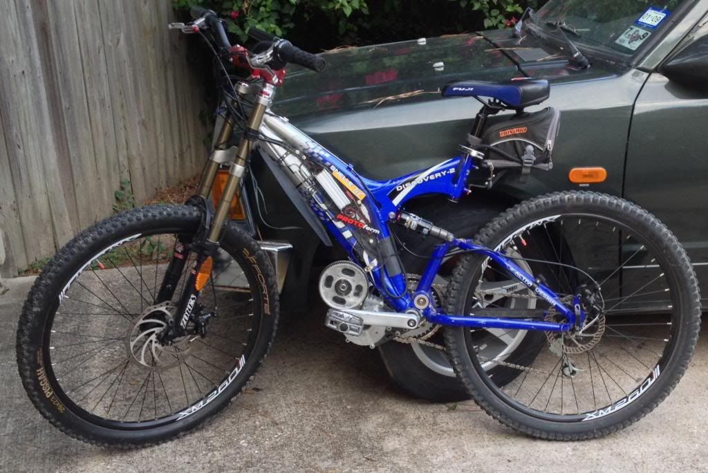

70mph on two wheels is way too much for me. 30mph on a single track, zooming between the trees is scary at times. This cromotor is capable of 5000W all day long and 12KW burst. Now take this same motor and stuff it in a middrive setup for insane RC-Monster Torque.
The Cycle Analyst does have torque throttle feature, which I will try out for off road duties.

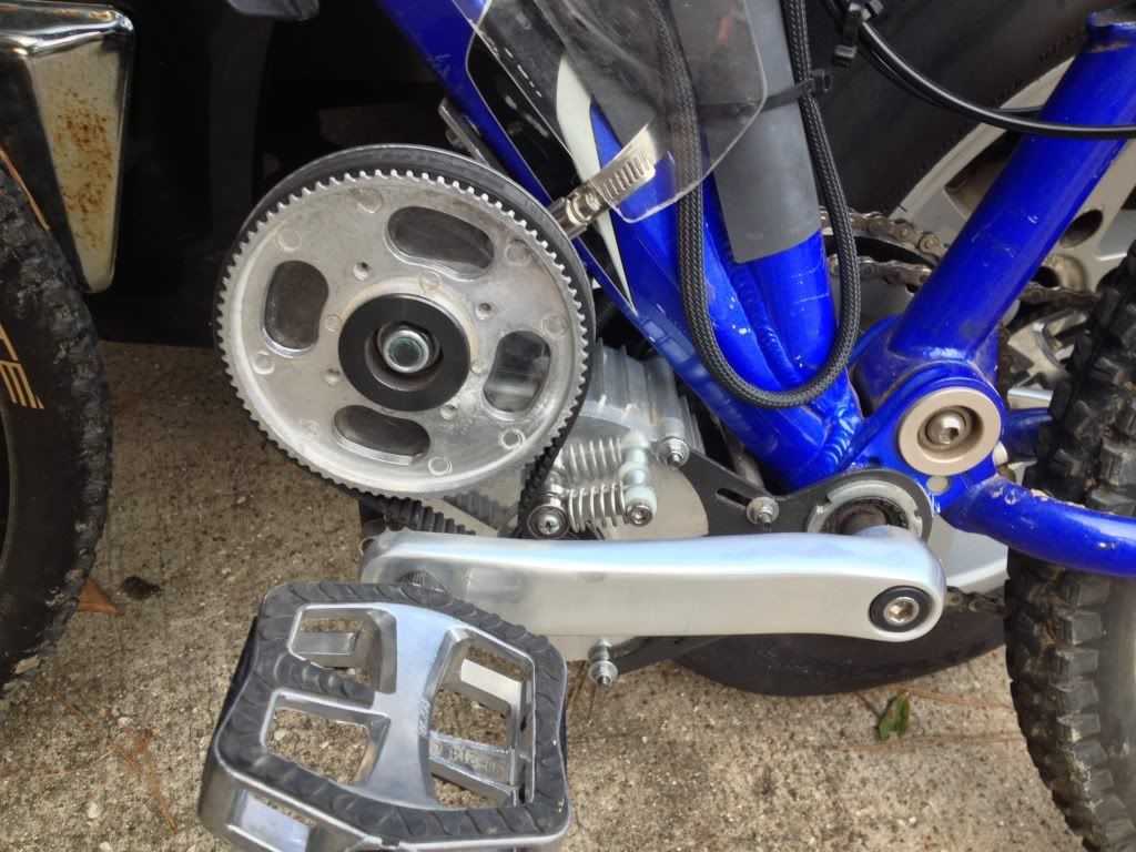

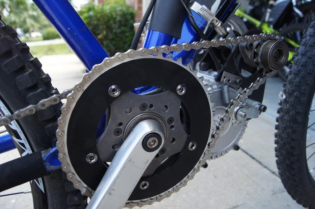

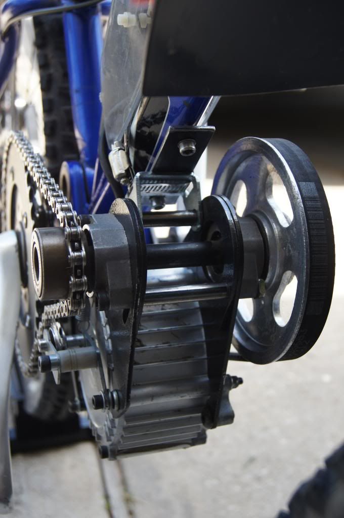

So I love torque too, hence my love for dragracing anything with uber torque. But didn't like the direct drive setup on my 42" wheel base Fuji bike. Weight distribution just sucked and zero lowend torque. So on the same bike I setup a mid-drive unit and it's a day and nite difference. Weight is all in the low center. Throwing the bike into corners is way better. Instant low end torque and only use 15s1p 5Ah lipo pack. Power consumption is about the same as the direct drive setup, when riding the same trails.
The first reduction stage is a belt drive and I push a peak of 37.5A through it. I could push 50A through the setup if I were to swap the belt drive to a chain drive. But that would be a bit much for where I ride.
Here are pics of the mid drive bike

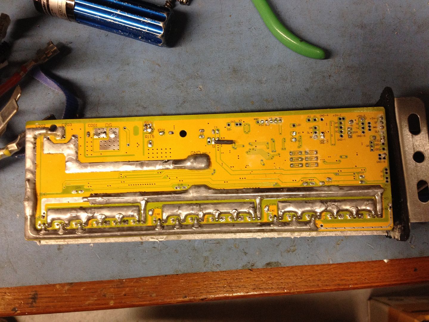

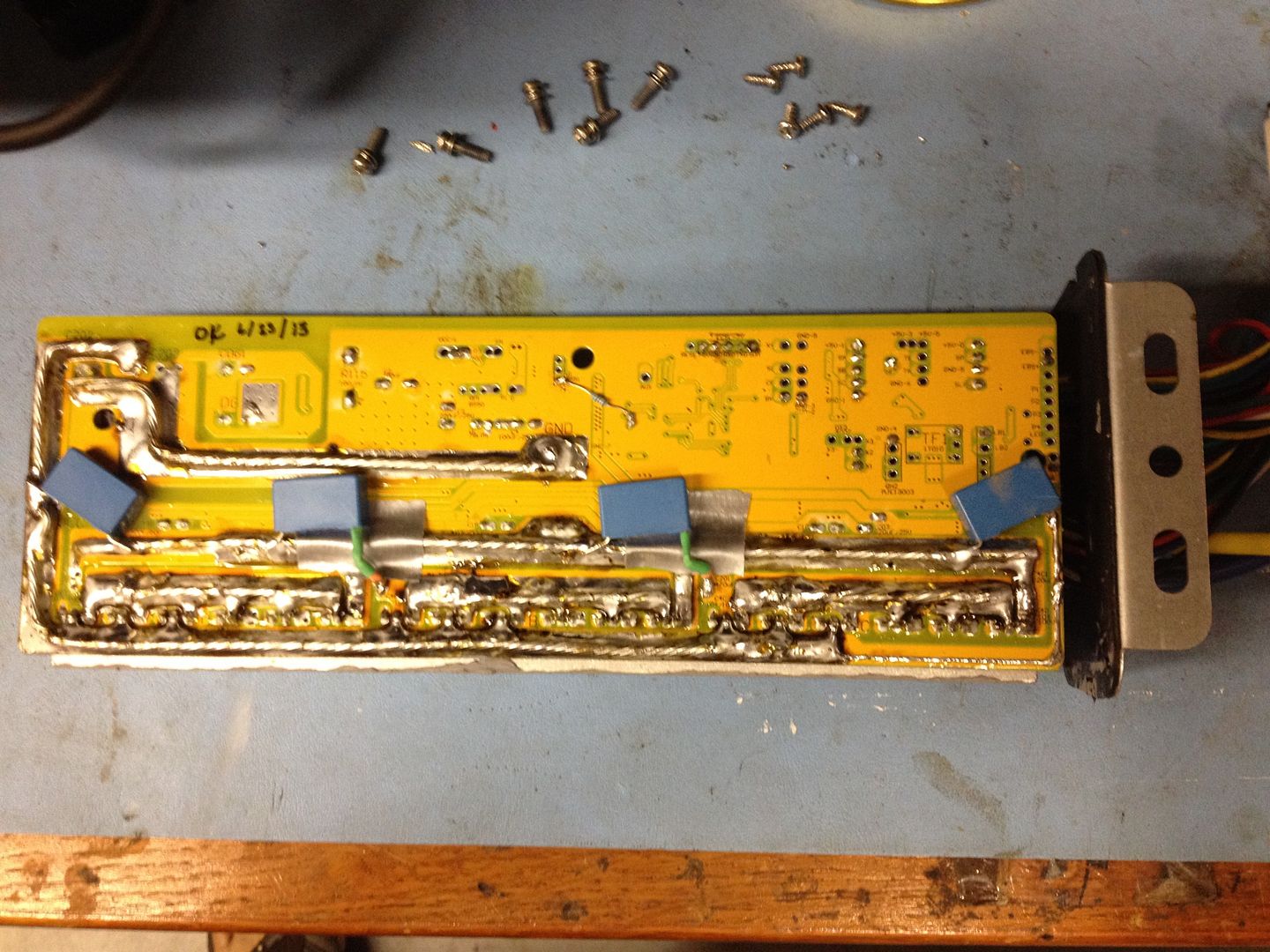

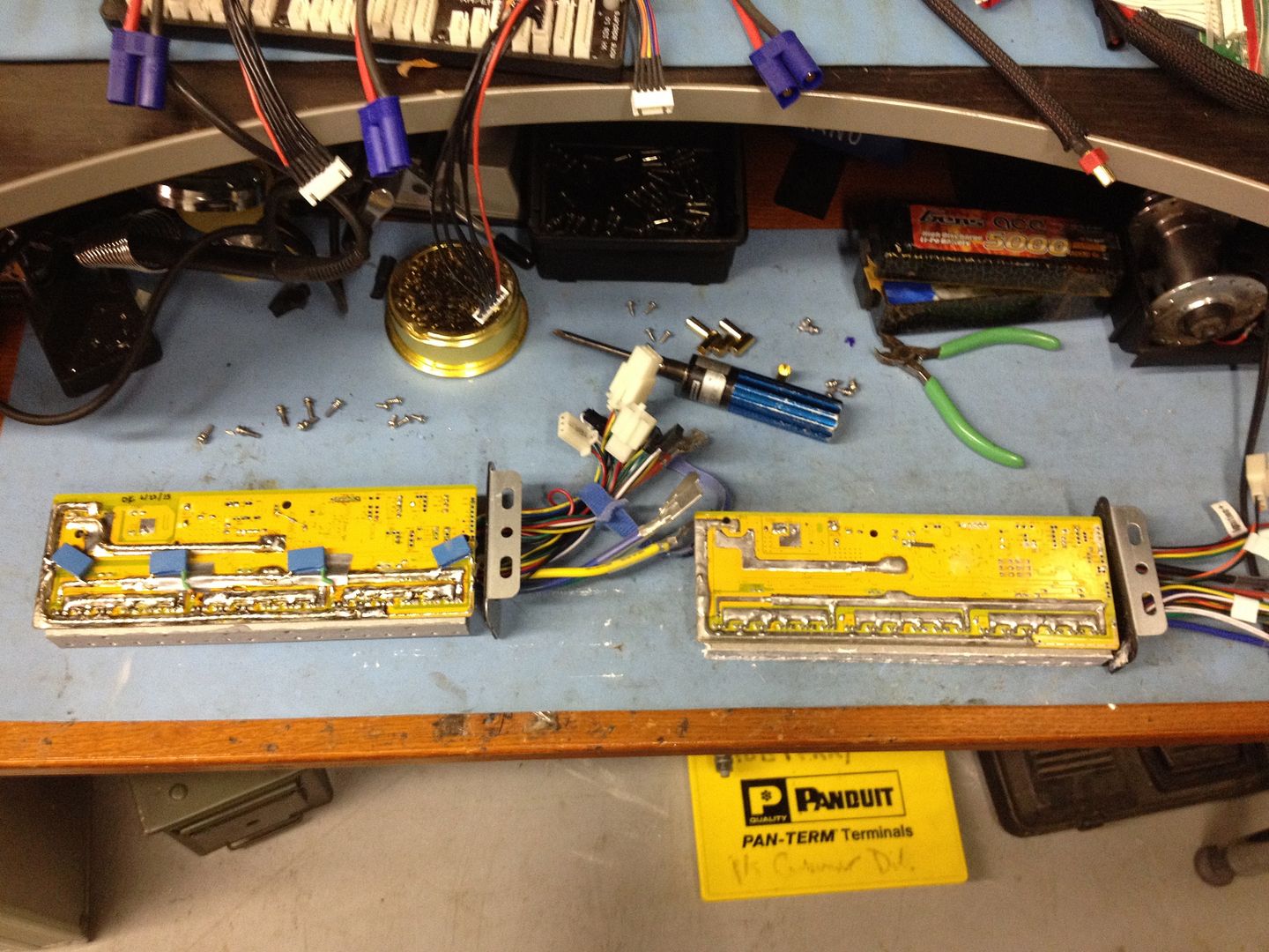

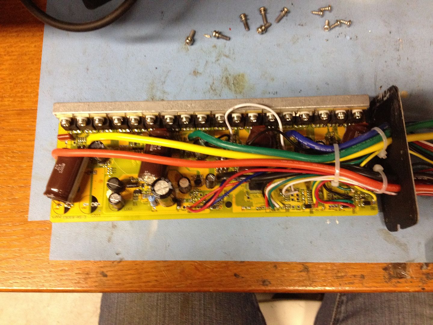

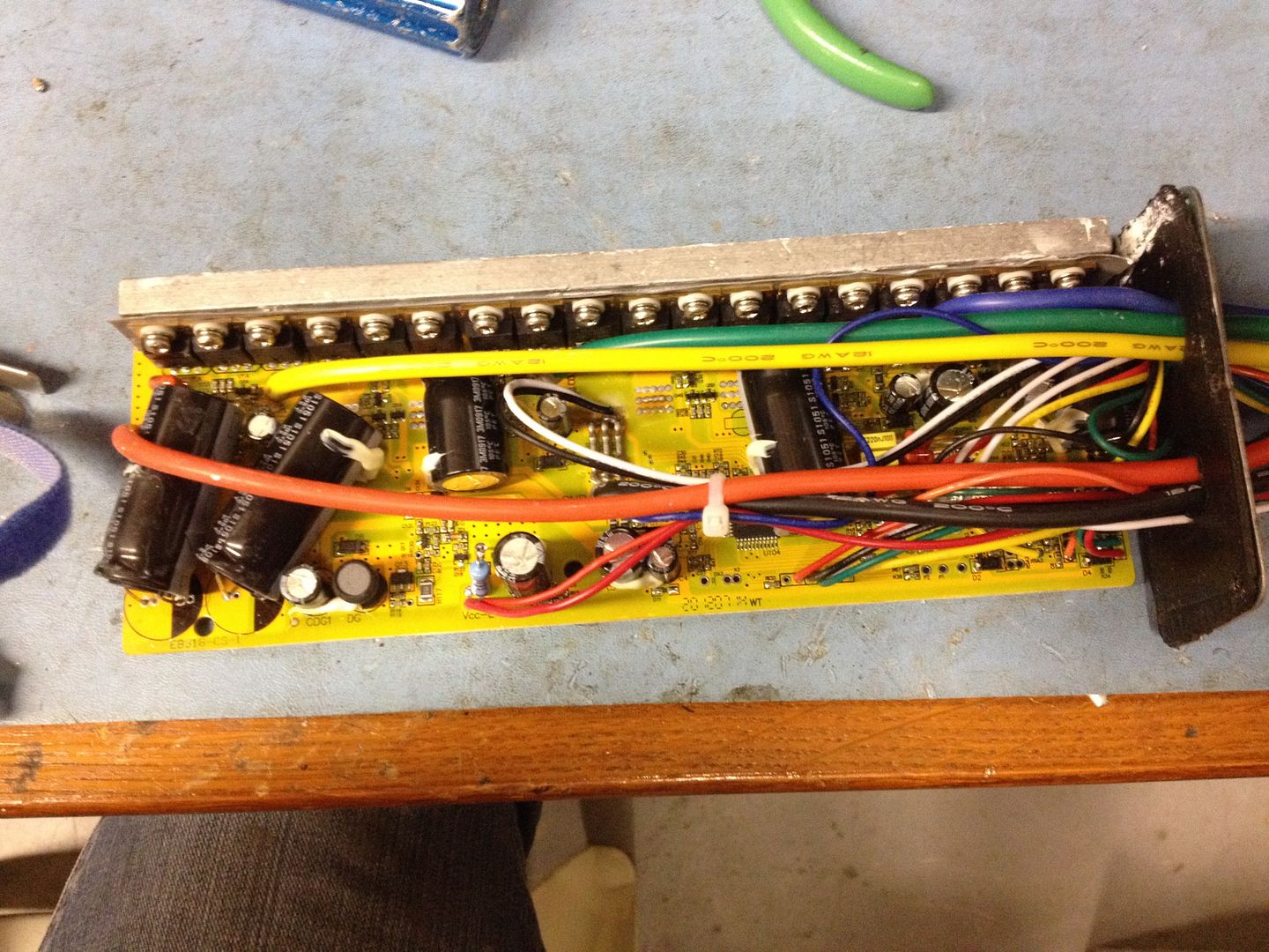

I know some of you appreciate nude shots.
18fet ebike ESC's. One is sensored with 125V capable fets and the other is sensorless 100V max.
sensored
sensorless

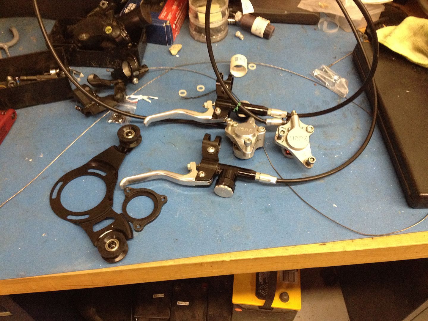

Got me some oldies Hope Brakes and MRP chainguides. Still waiting on my Hydraulic pressure switches for the brake cutoff.

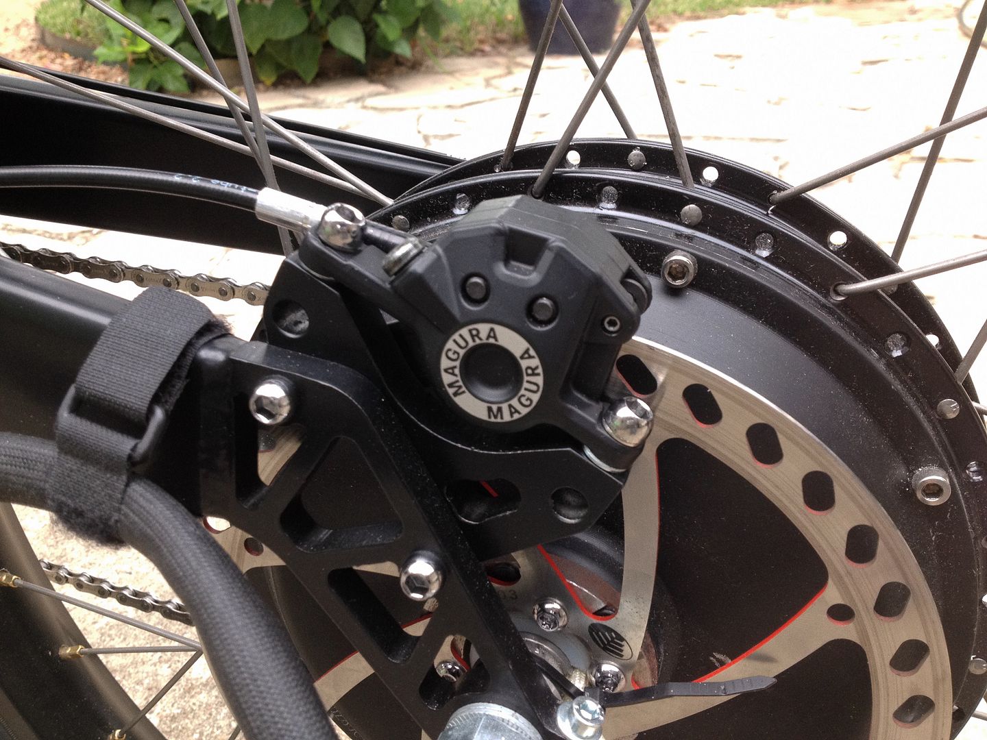

The dual disc brakes didn't work out. They leaked at the pistons and I'll have to fix them later on. In the meantime I found some Julie Magura ebike brakes. These have the brake cutoff sensors build inline with the hydraulic lines. These work good at slower speeds, but I'll have to depend on regen braking at higher speeds. I still need to wire it up for that.

I added some more copper on the traces of Lyen 18 fet sensored controller as I did with the sensorless version. The controller is a bit better at the topend and climbing steep hills from a standstill. Sadly no video. I managed a speed of 46.8mph. Bike feels like it can go faster. I'll have to find out what that limit is one day.
I had my friend and his daughter ride the Raptor too. They loved it. He is about 265lbs and the bike still pulled him like mad. His daughter is about 115lbs and the bike takes off like a bullet with her on it.
