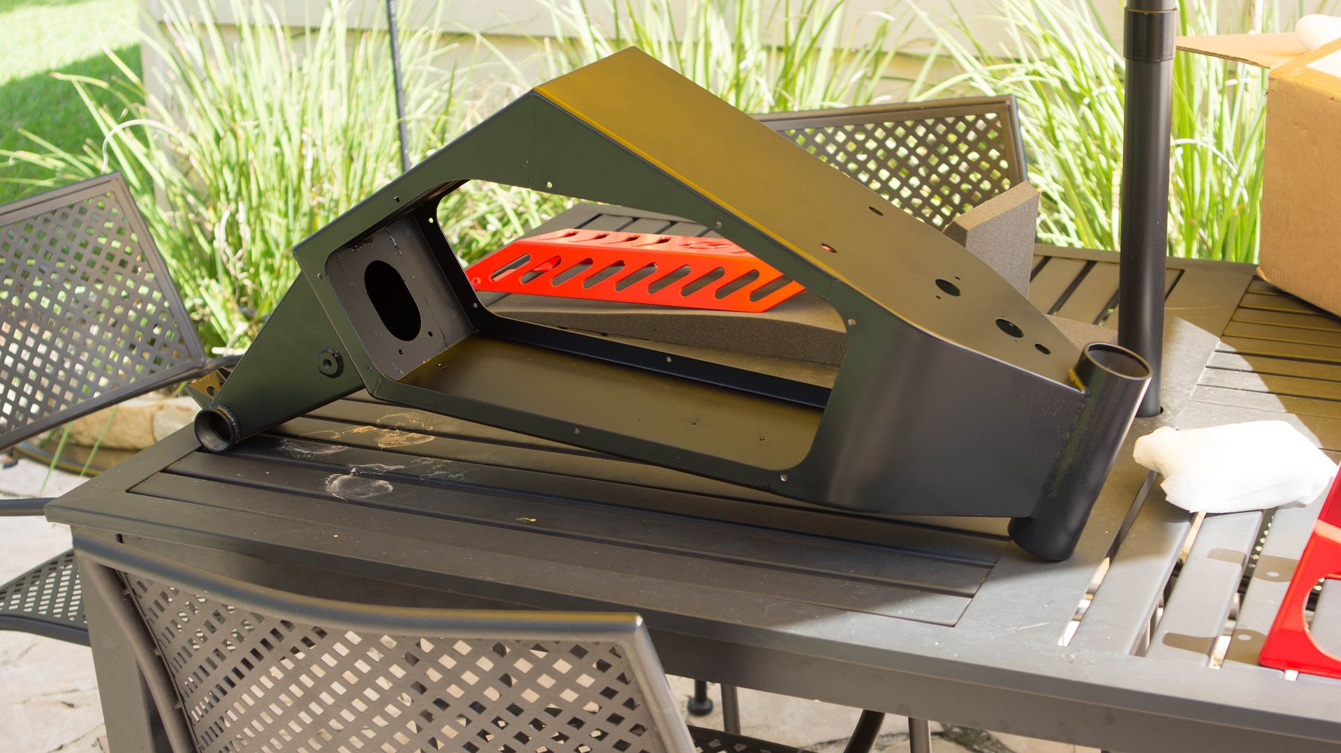

The ebike frame came from Slovenia and took 1 month from fabrication to delivery at my door. The motor is a Greyborg beast and got that through the USA distributor. I purchased two 18 Fet controllers and I'll have to see which I like best on this heavy frame. Anyways, I got both a sensored and sensorless controller. The Cycle Analyst is the latest version and has plenty to mess around with. Batteries will be my same old Sky lipo 6s packs and a pair of 3s Gensace. Sometime next year, I'll get me a A123 pack build.

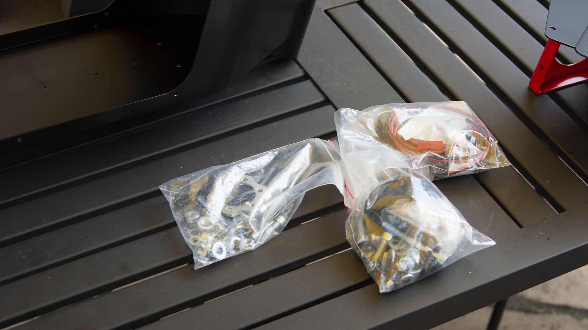

So this is what I received in one box.

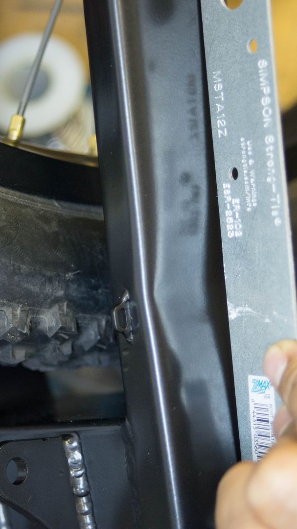

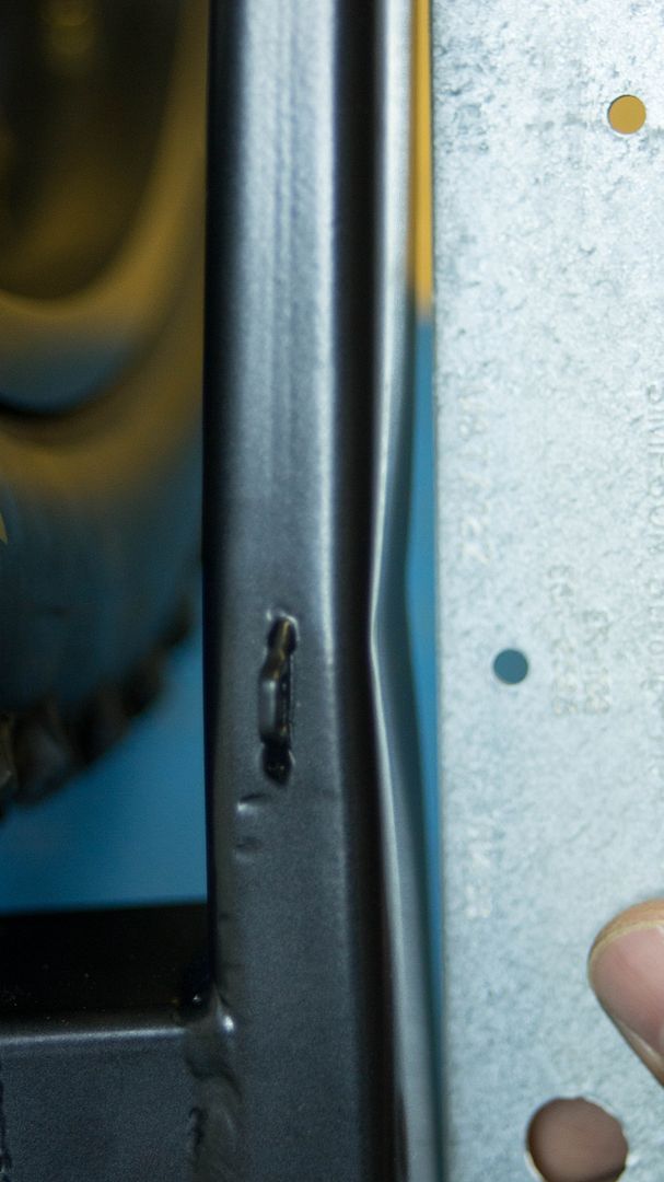

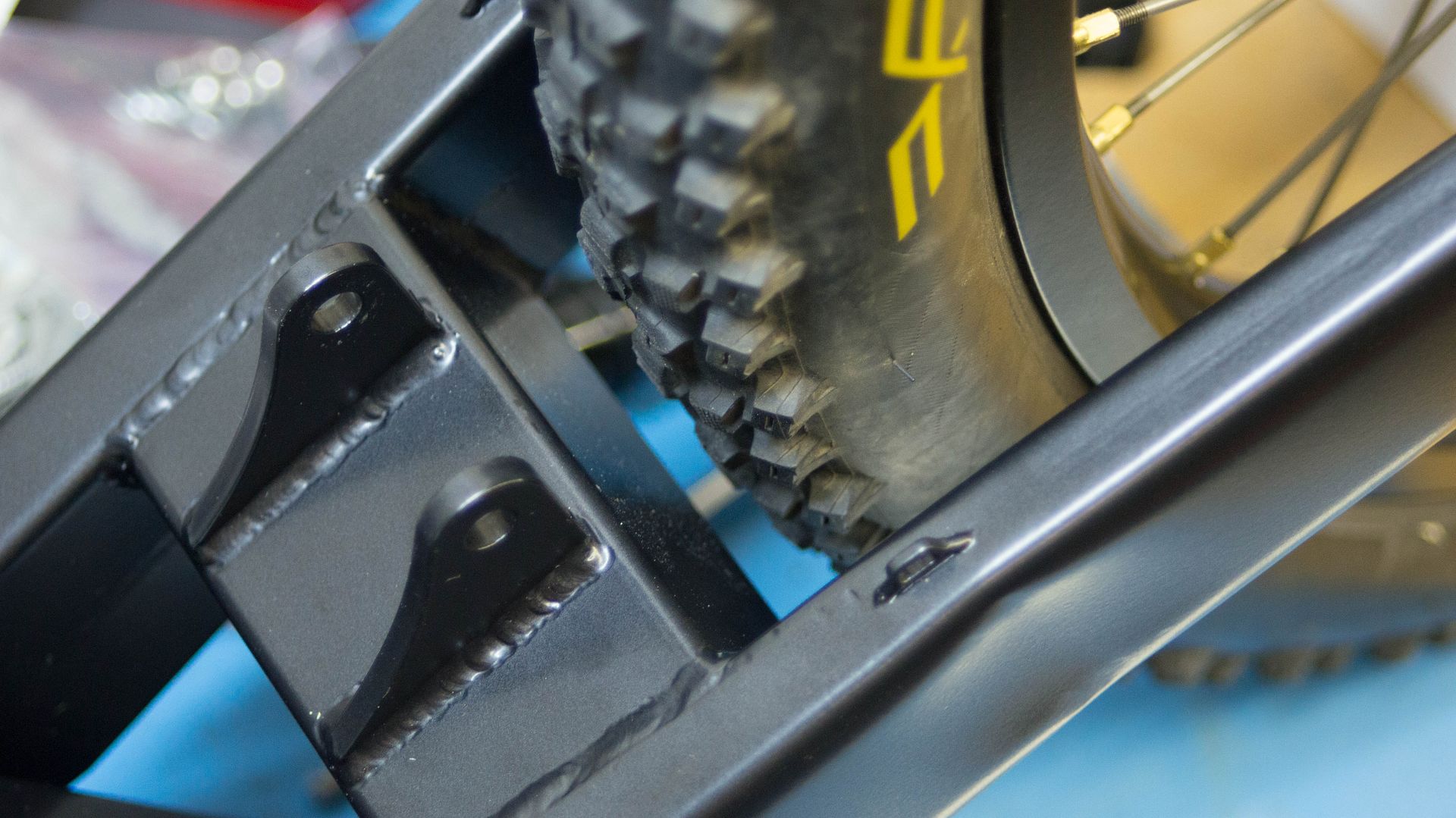

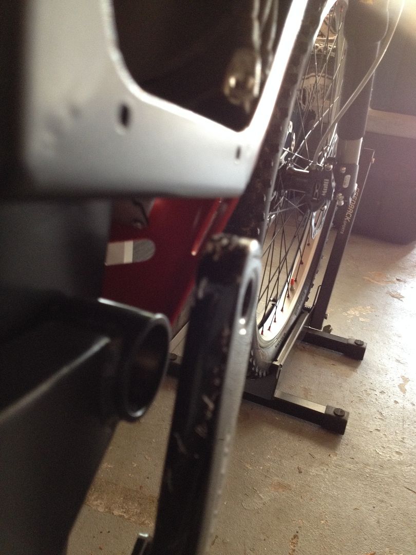

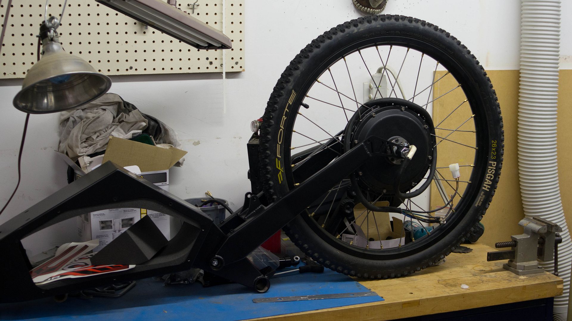

I installed a 26 x 2.3 tire on the 46mm rim. I had requested the dropout to support a Cromotor and 5 speed freewheel, thus 165mm dropout spacing. Well it looks like I'll go with a 3 speed or two speed freewheel instead. Too bad a Schlumpf drive can't/won't fit.
I am disappointed in one thing. For the money I have spend on this frame, I expected a non-tweaked chainstay to get too the 165mm dropout.
I've emailed the company and they agreed to send me a new swing arm on an open forum and email. Lets see if they do send me a new one.

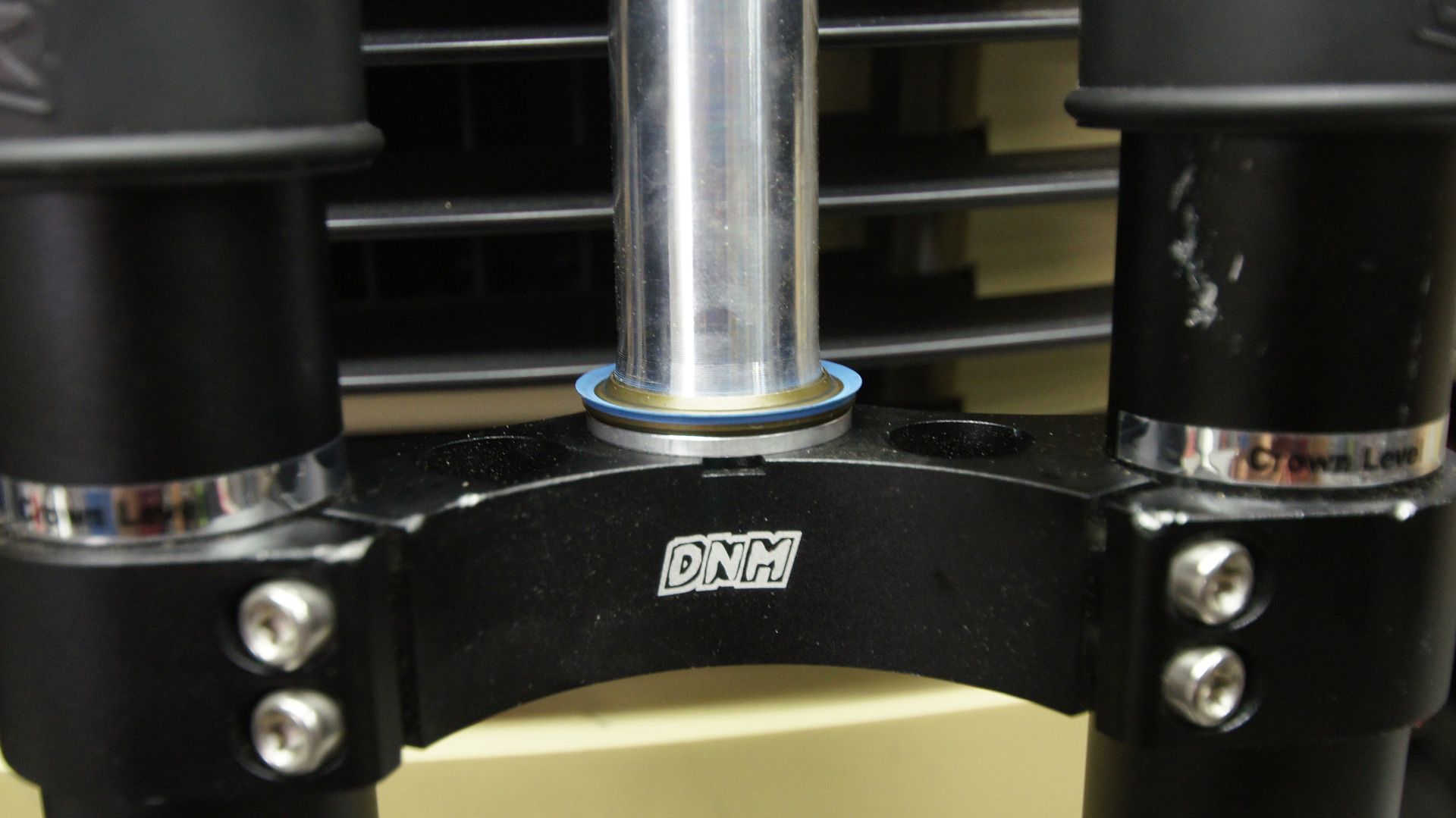

Got me a DNM fork that is dual disk capable. The dude at Bike Barn laced up the hub for me into a wheel.

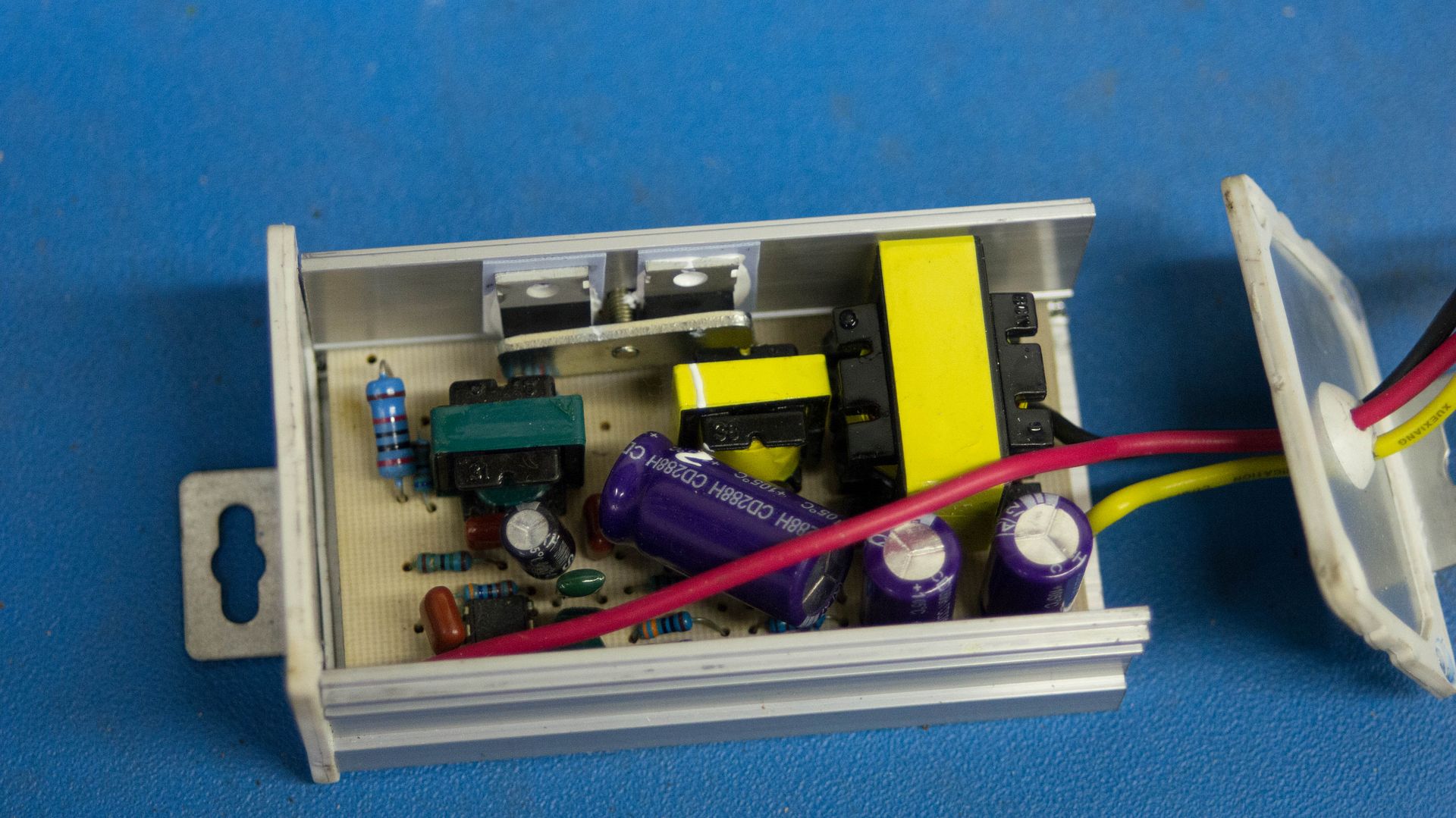

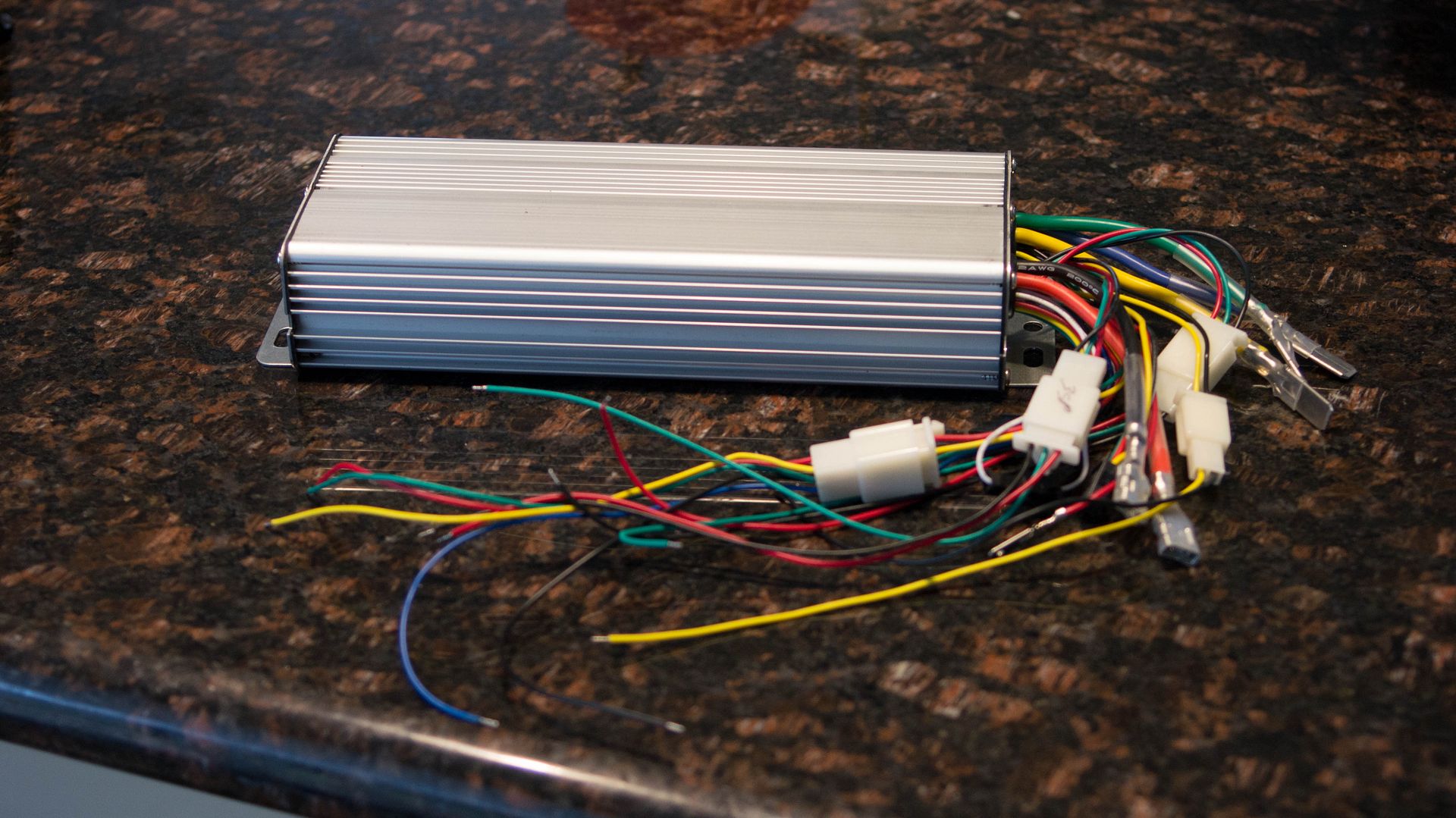

Here's Zombies 18Fet controller. This is when I want to play with regen at 24s. But for real running on 24S, I will need a bigger controller for the Cromotor.

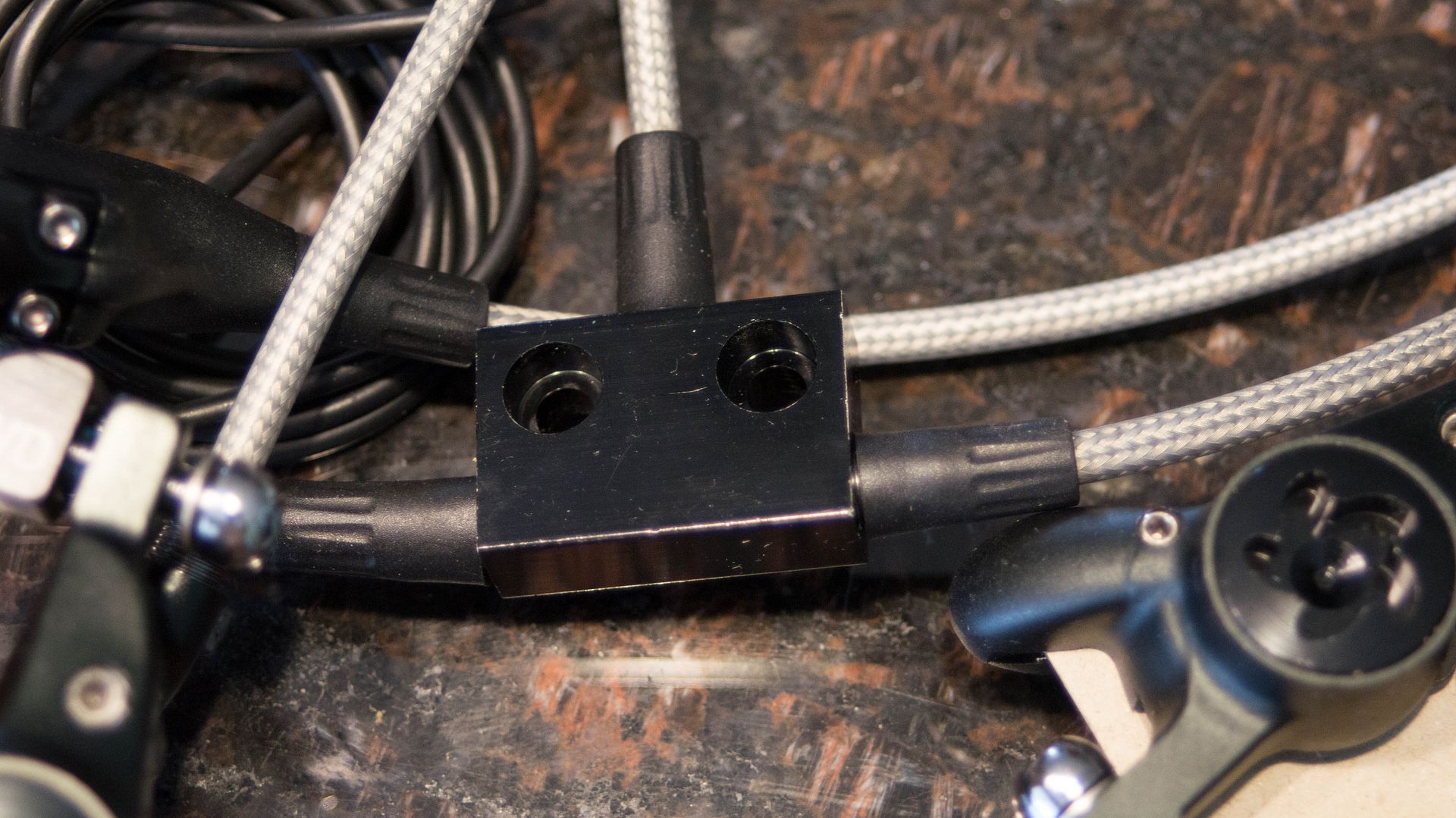

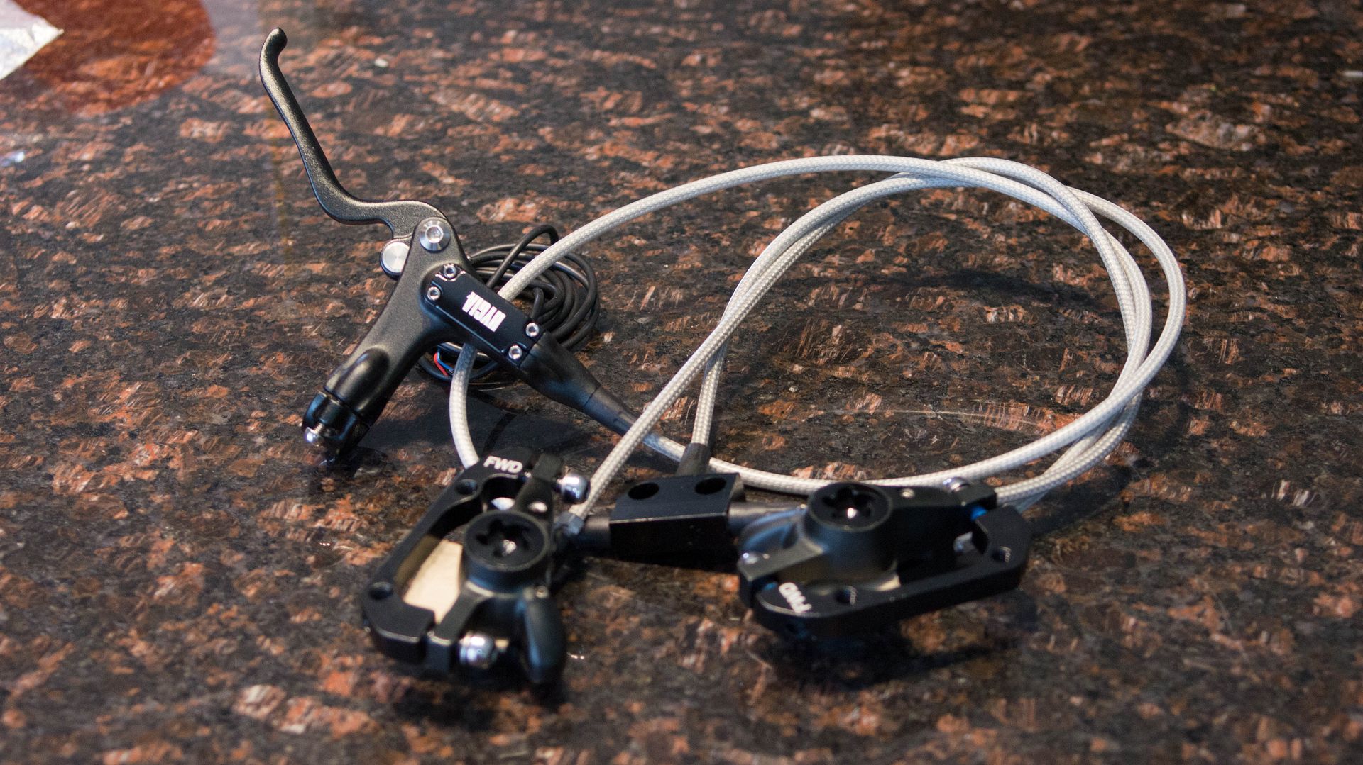

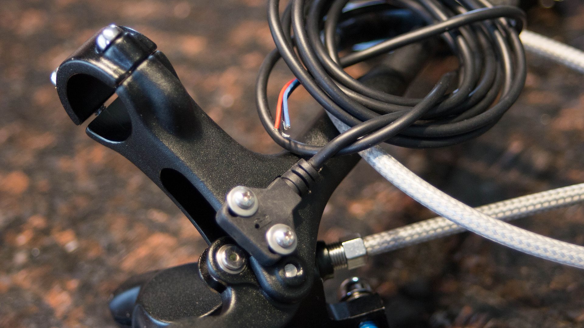

This is the Hygia E-hydro brakes I got through Greyborgusa. Uses a hall sensor that is screwed on the bottom of the brake handle.

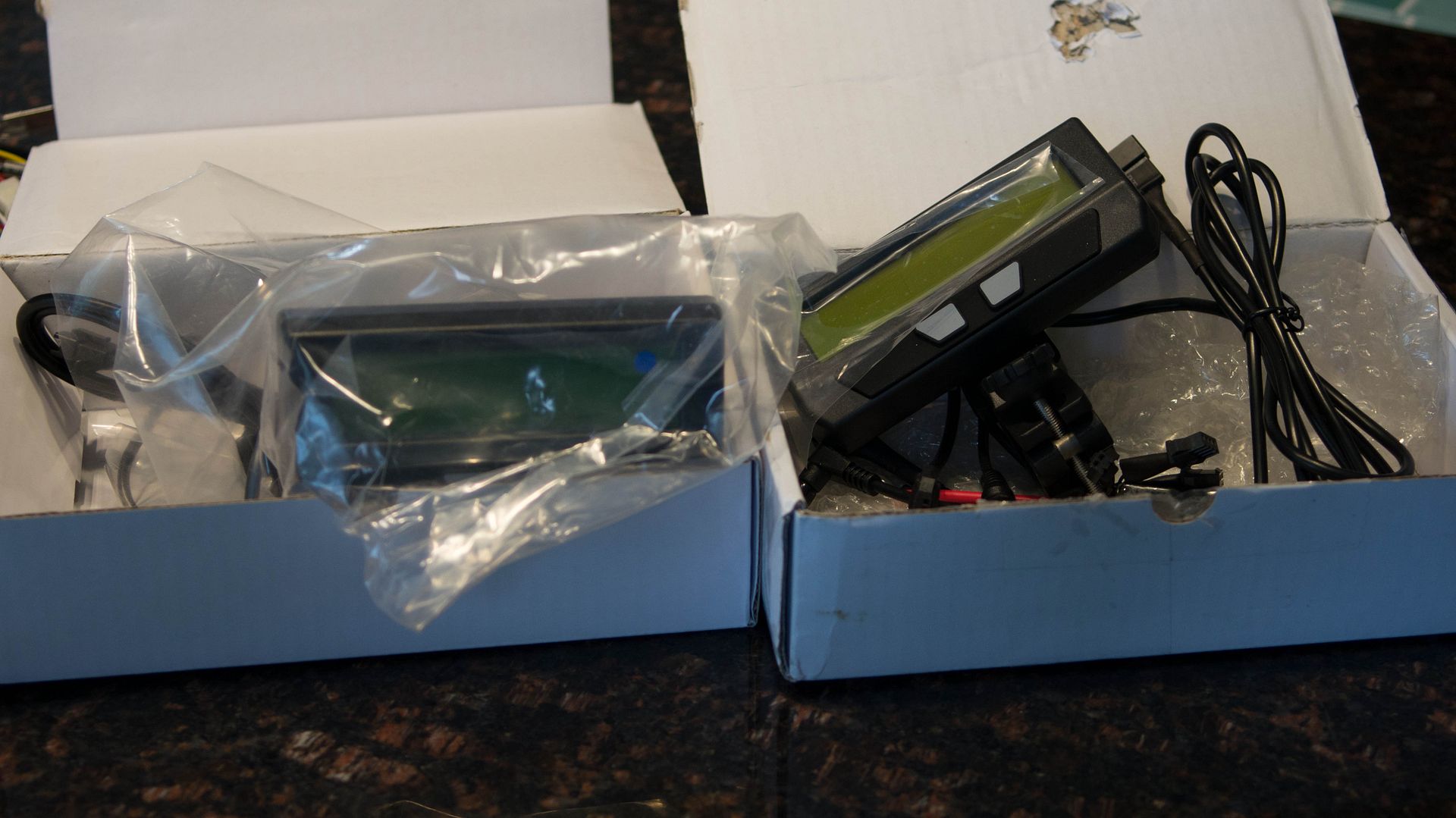

I have a pair of V3 CA's. One for Lyen 18fet sensorless controller and one for Zombies 18Fet.

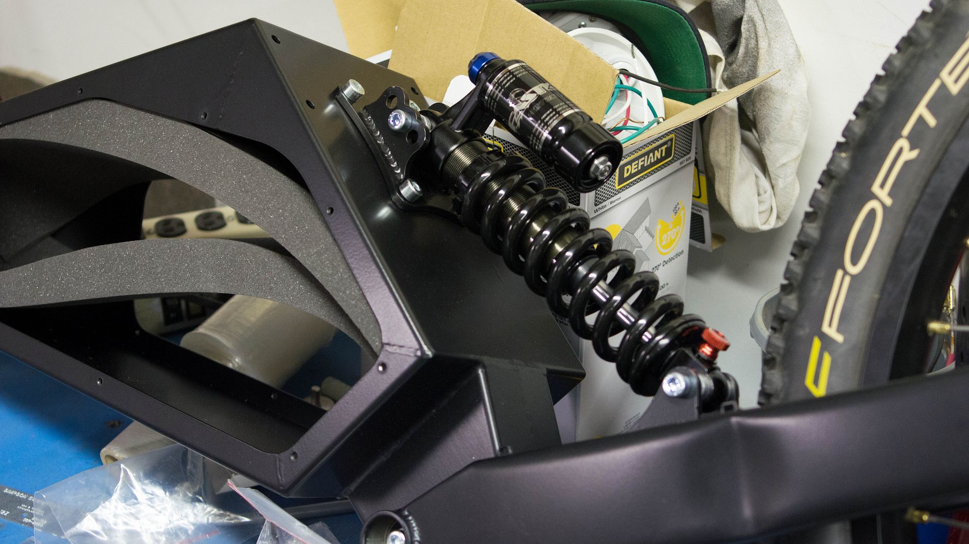

Got the 50 dollar 9.5" shock from Ebay. Looks ok for the price and fits nicely.
Got me some stuff from evworkslab.

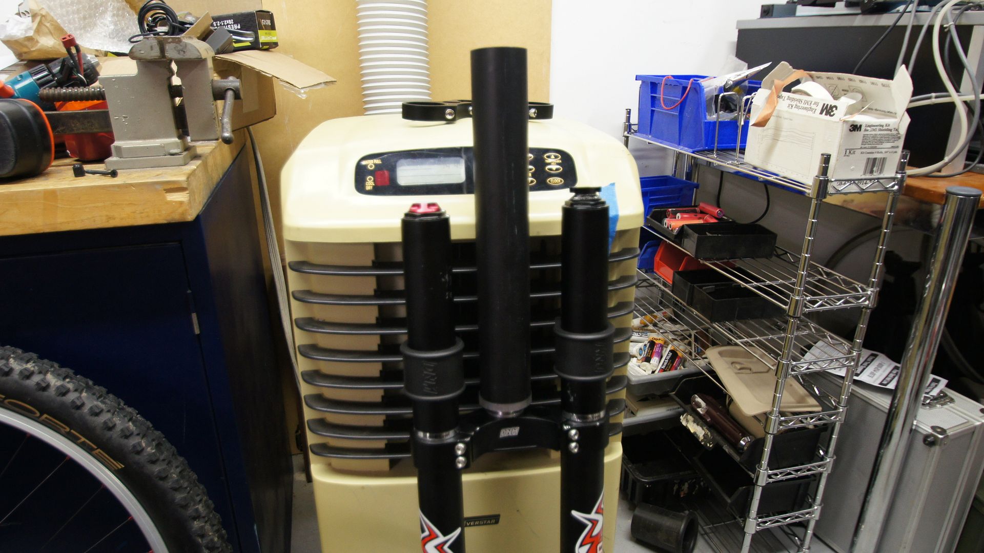

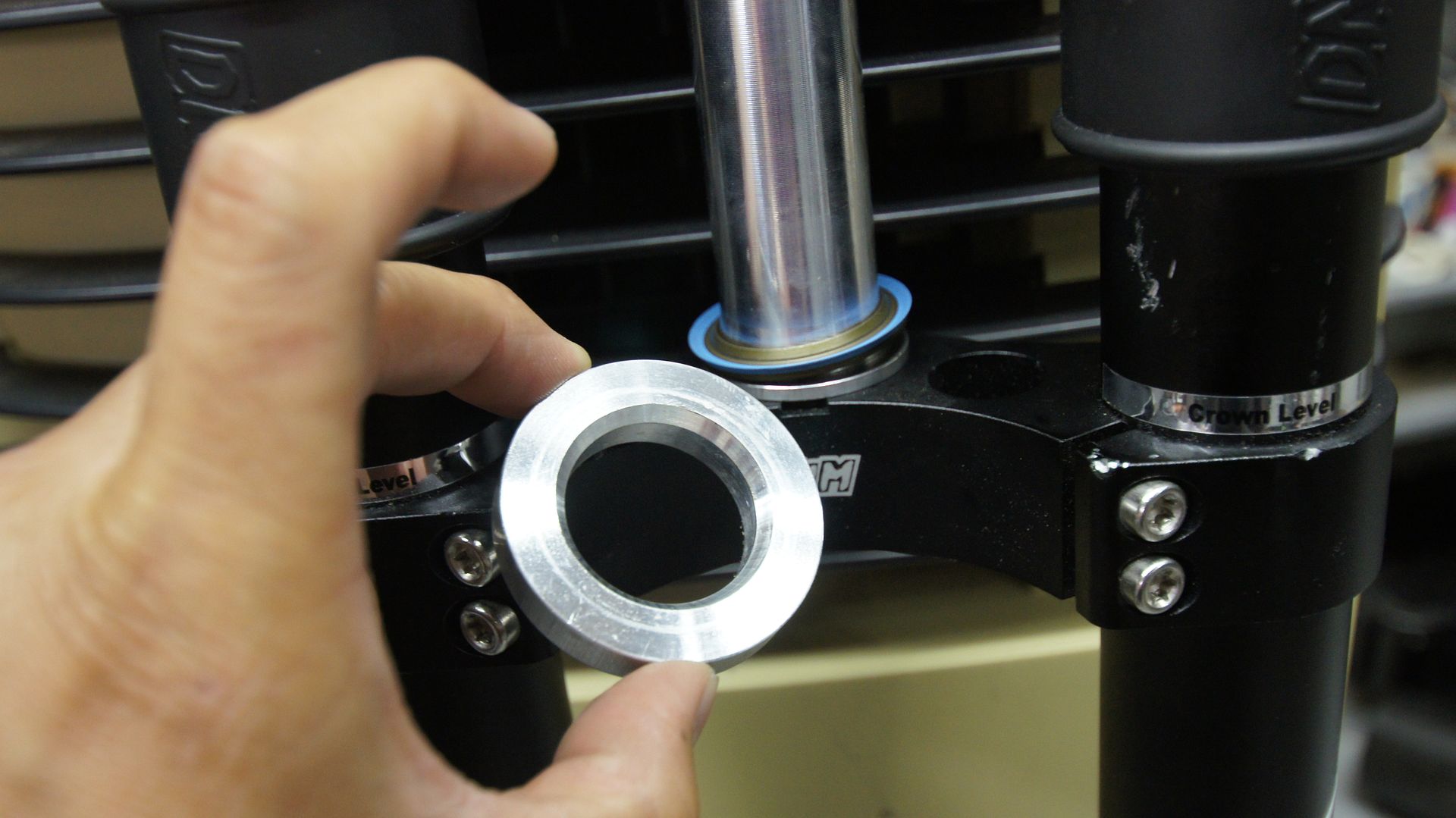

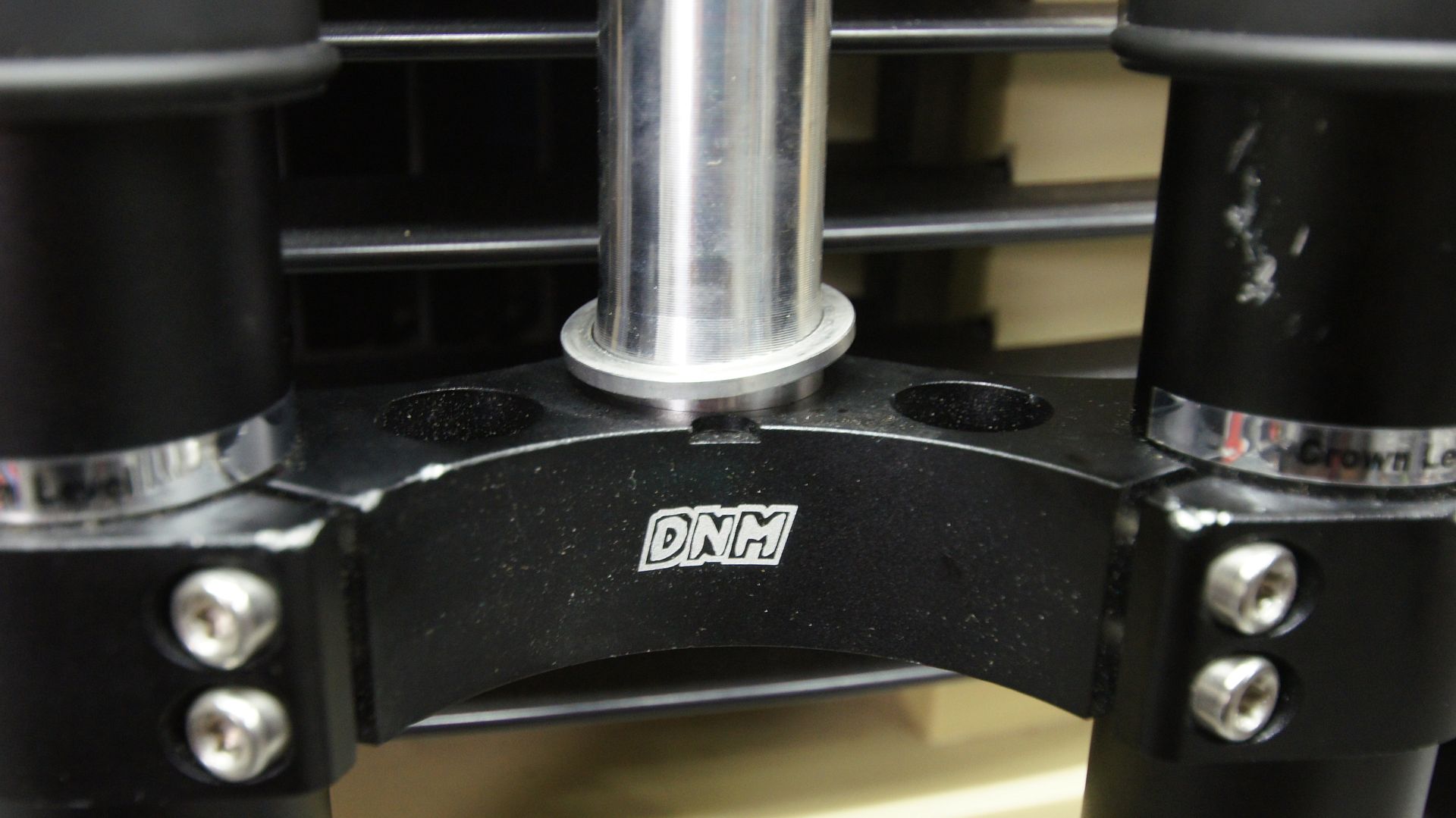

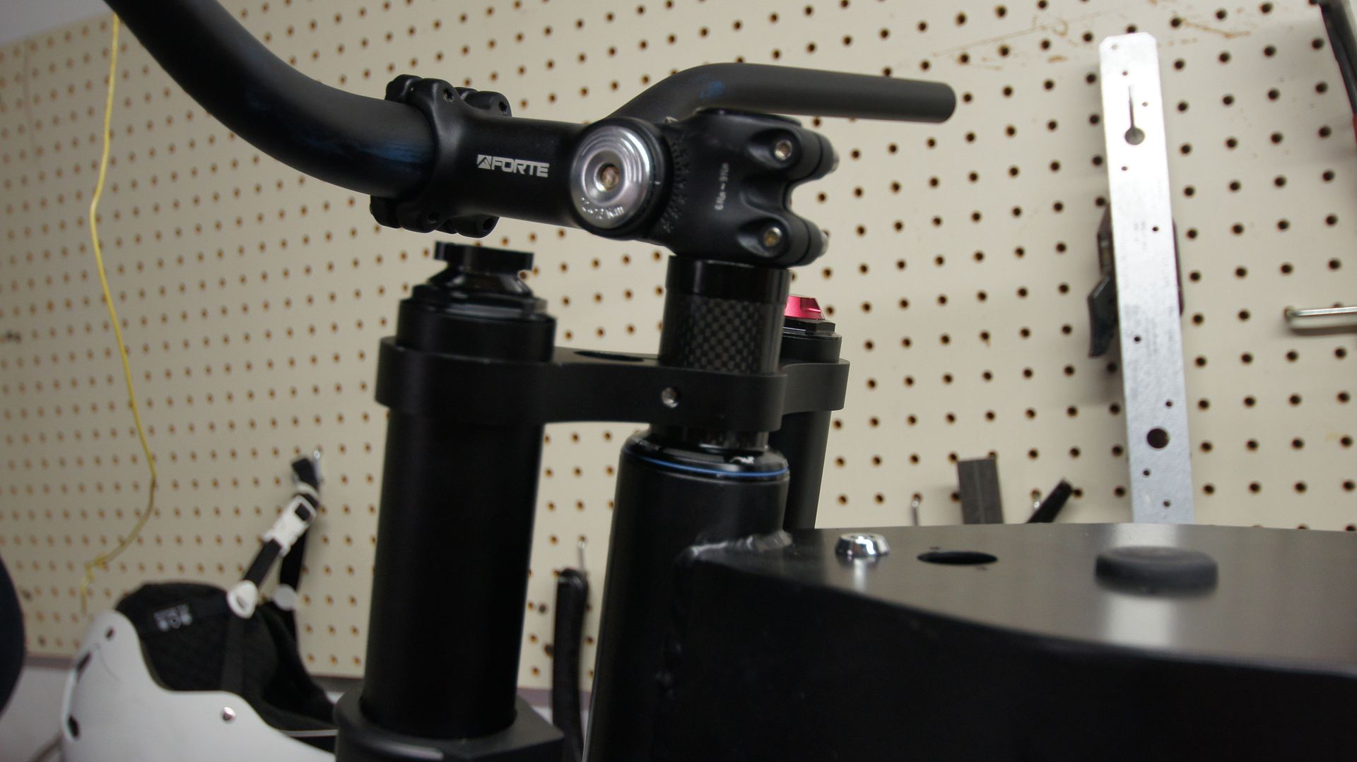

Used a spacer on the fork before installing the Cane Creek headset.

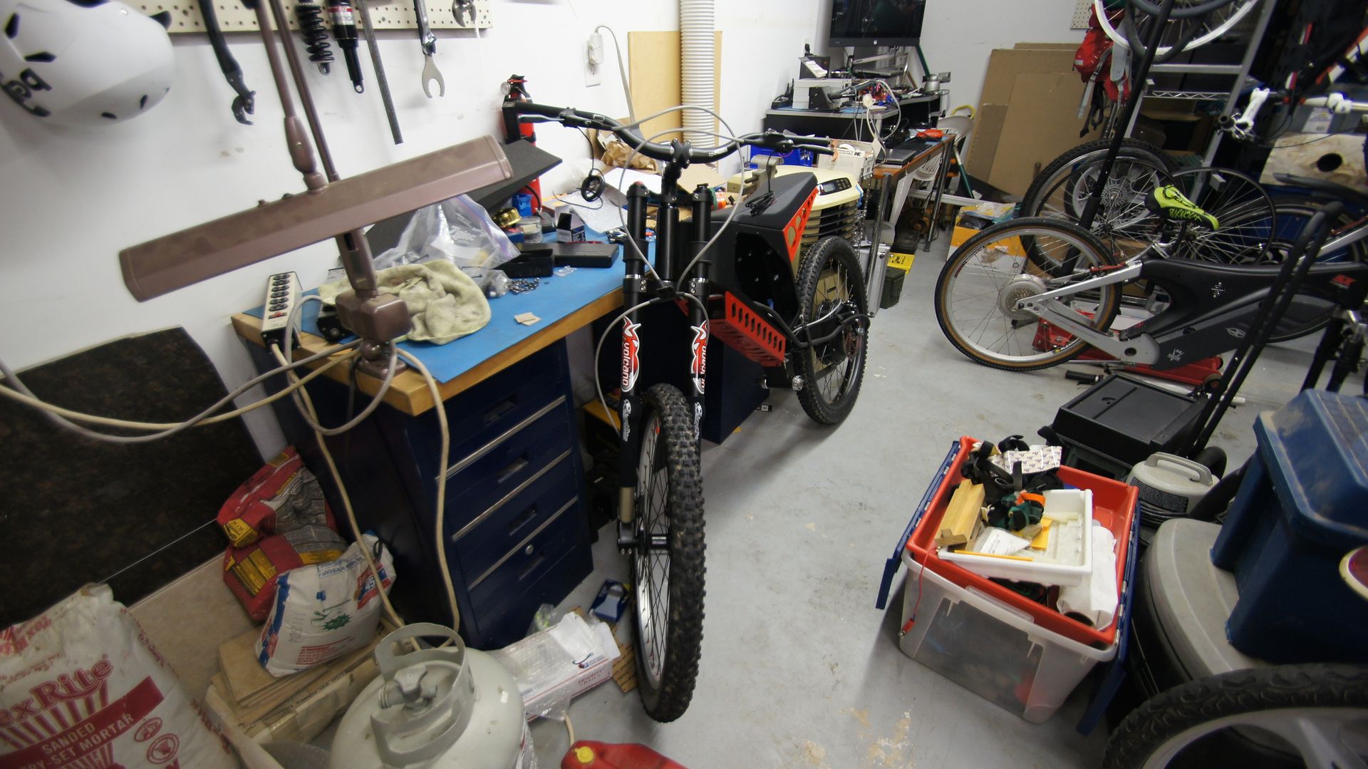

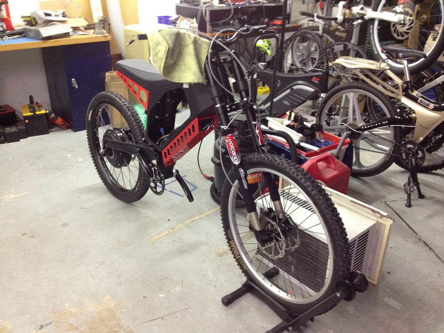

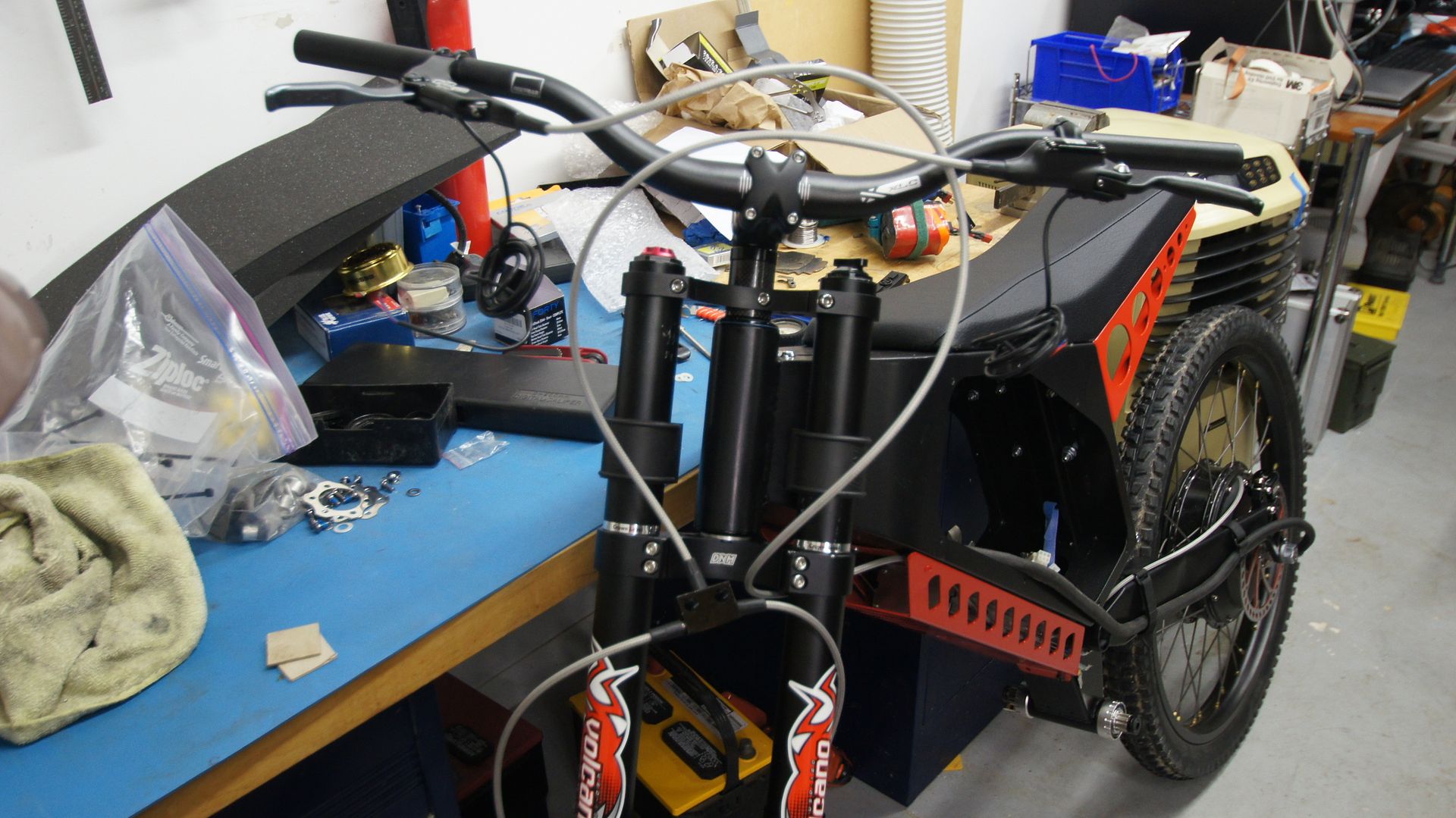

Getting there...The bike is tall or I'm just too damn short. Waiting on more stuff to arrive next week.

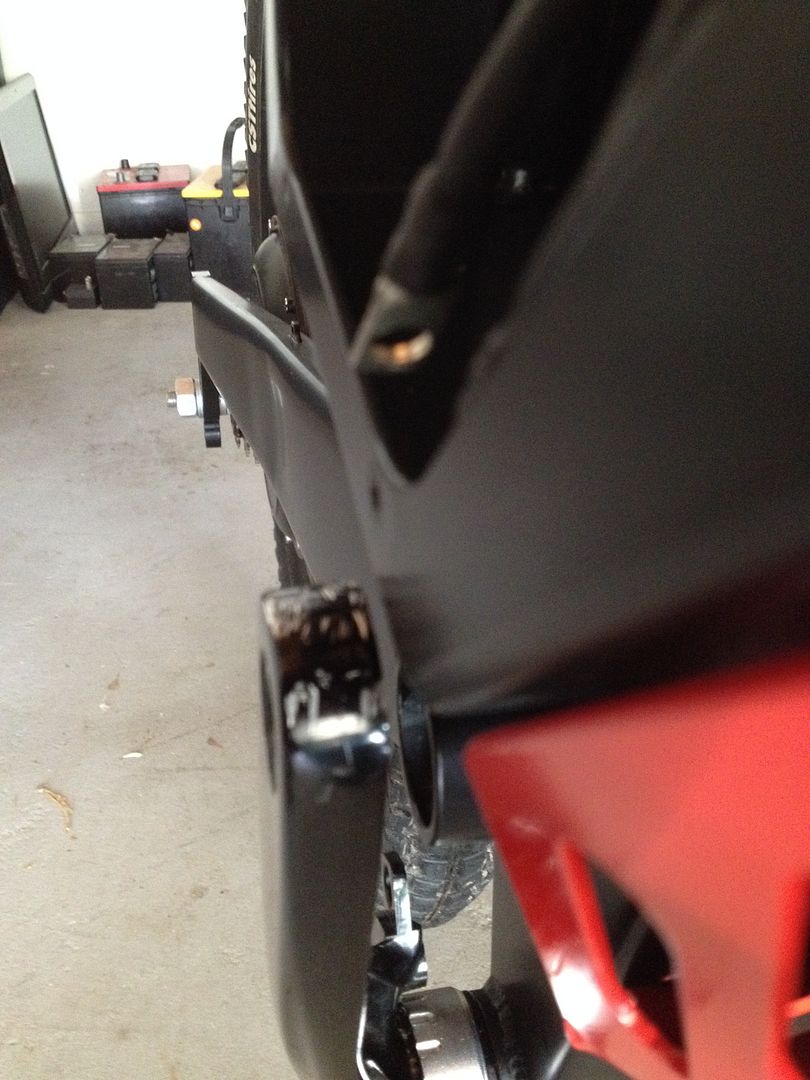

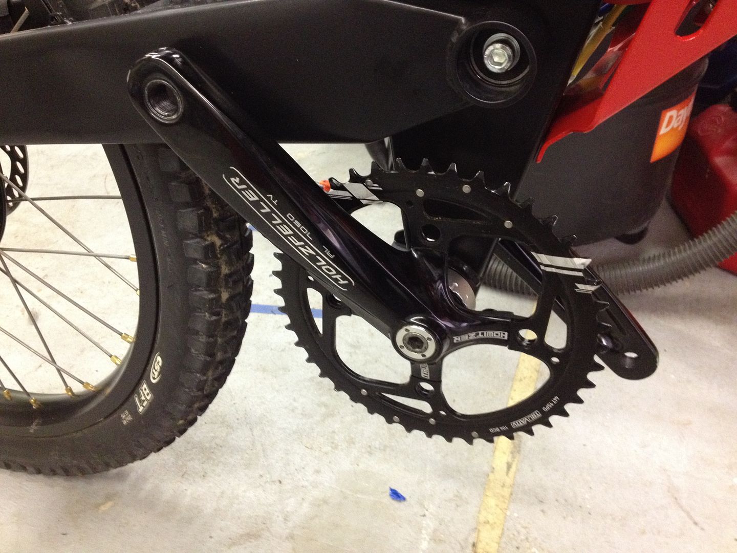

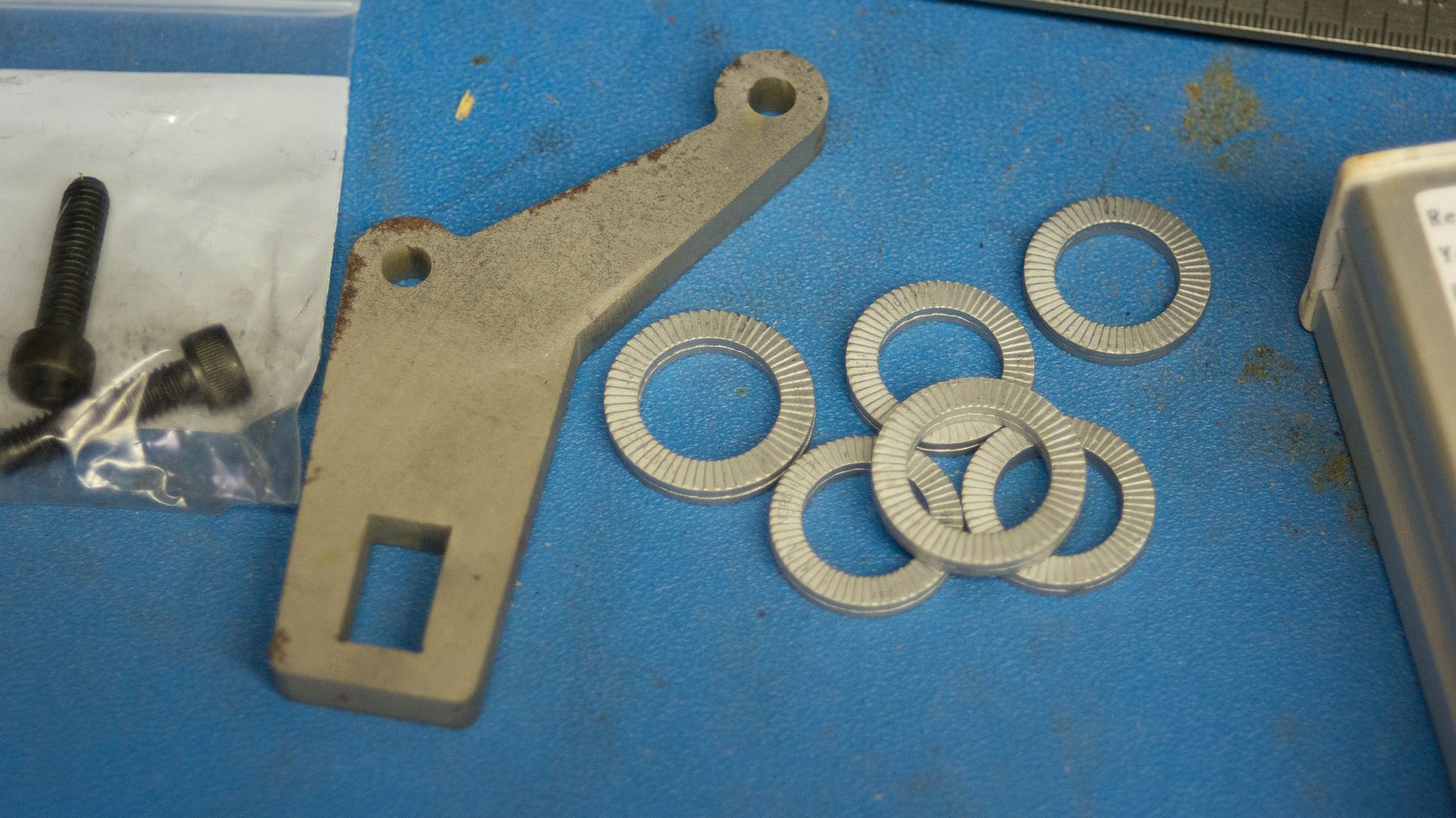

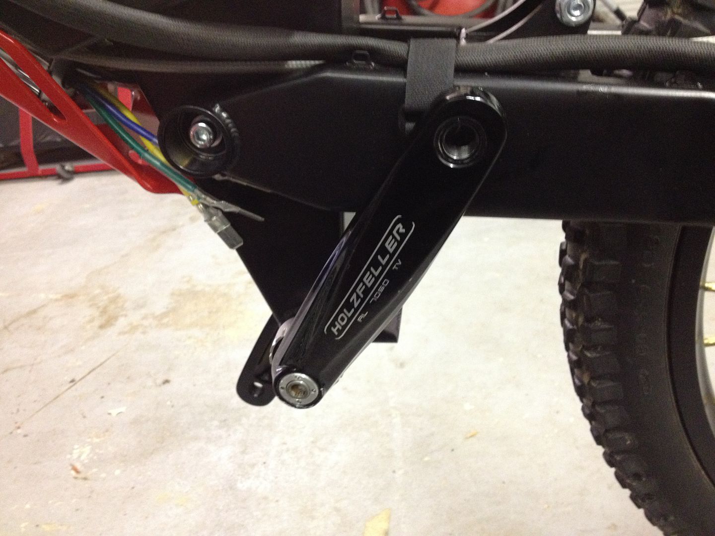

Installed an old set of 165mm cranks. Still need to look for a new rear brake, as the the one I have is leaking oil. The front brake lines are find, but need to install some spacers between the brake rotors.

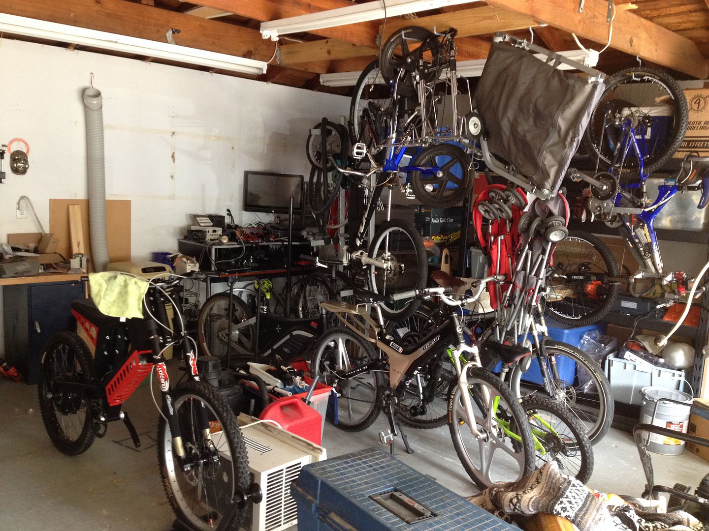

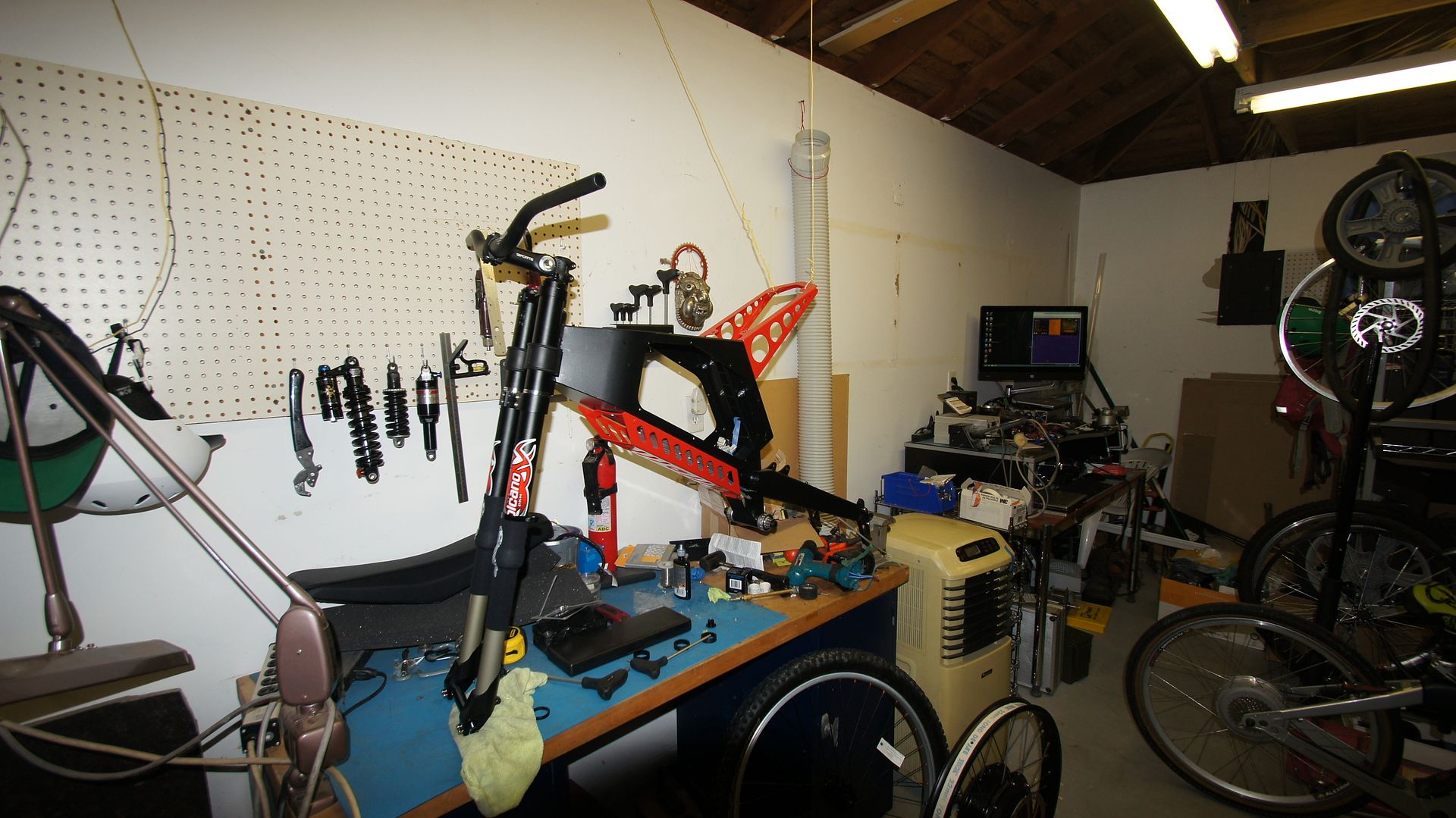

This is my Bike Barn
