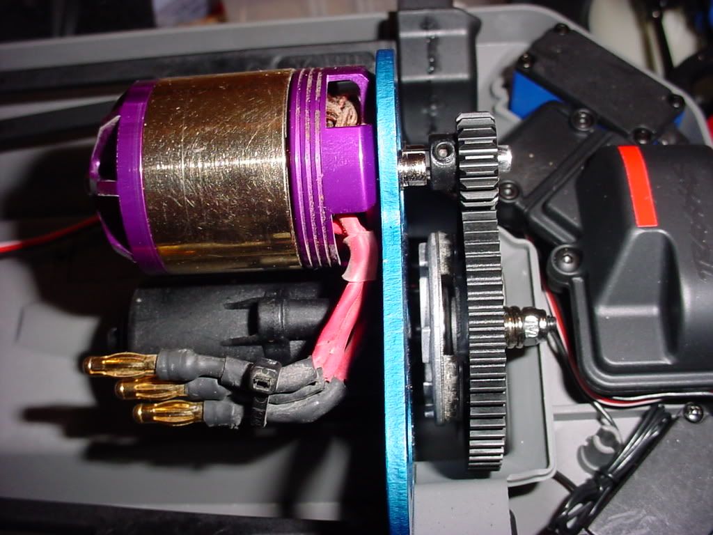

I would like to see some of those UH hybrid outrunners in action. I tried both align 600l and xl on 5s and they worked well for me in my old emaxx. They are around 1600kv and work well with a quark controller.
I might just give it a shot. Heck, for $39, i'm not losing much if it doesn't work very well.
01.21.2008, 05:21 PM
If it has anywhere near the performance of the align motor you will be happy. The spool up was slightly slower than an inrunner, but so much more torque. Very smooth power delivery as well. And it did not get hot at all. Hope the UH hybrids are as good as the align.

The crazy thing about that motor is its based on a 5mm shaft and its turned down to 3mm where the pinion goes on it. I think they were aligning it to work with stock emaxx pinions.
I think like most outrunners its just a matter of losening a set screw that holds the shaft in place and replacing it with a 5mm shaft that isnt turned down on the pinion end. Should be easy to do if you can find a 5mm piece of rod and cut it to length. I could be wrong on that, but I think that is the case on most Outrunners.
Hey Jhautz,
You just described exactly what I did to the very motor I got from you. LOL
Desmo
