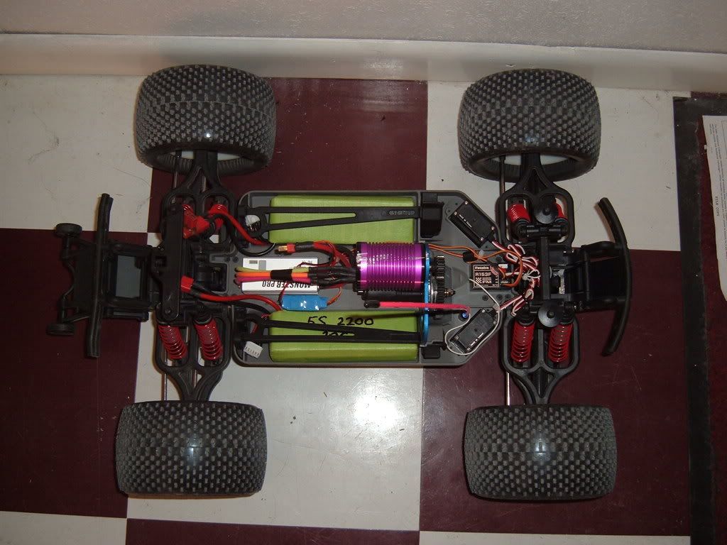

Ok, the moment you have all been waiting for:
I will have some body pics up as soon as I finish the sticker application. The big scratch on the motor is from the riduclous cart wheels it does without the wheely bar! Sucks, but I guess it gives the motor more character!

Looks good man. Whats up with the scuff marks on the motor?
6 KiloWatt A123 Racer
24s2p EVG SX 49.6mph Ebike.
01.30.2008, 12:21 PM
I like to do my test runs without a body (I am a dumbass). It had alot more power than I was expecting from a l can motor!

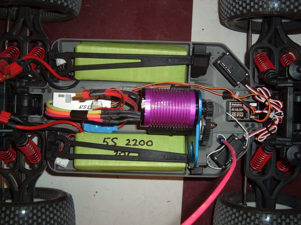

01.30.2008, 08:28 PM
Changed the gearing to 20/52 and ran the truck for about 15min. Top speed was 42mph, leading me to belive the motor is a 14l, or possibly a 13l. The 14l has a kv of 1725, which works out to slightly over 42mph on Brian's calc.
Temps were good, after 15mins, batterys were 70f, esc, 90f and motor was 150f. Ambient was about 65f. I would like to gear down slightly, maybe a 19t pinion. But since I have an 18t pinion and a 50t spur, that should be perfect gearing for this setup.
I am very happy with the hacker motor, just bought 3 more used hackers and have my eye on a few more. And I won a new aveox for the xxx-cr and my sidewinder came in. So I have a bunch of testing to do!
