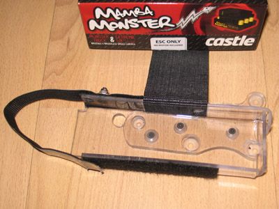

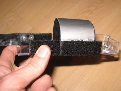

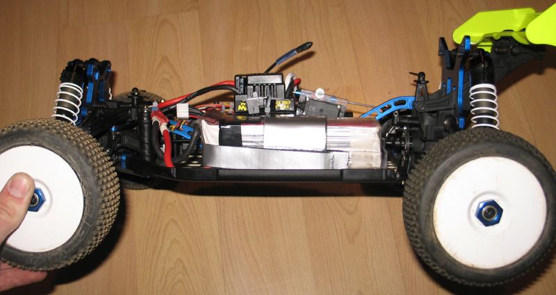

Then came the two-piece battery tray, including the spacer to offset it from the chassis (to clear the dirt guard) and the actual tray:

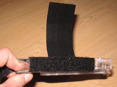

Open, demonstrating the ability to adjust for different battery lengths:

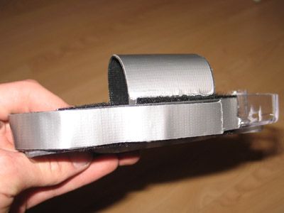

Showing the height adjustment capability:

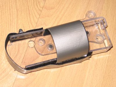

With the top strap in place (notice the outer velcro on the height adjustment strap, more on that soon):
My favorite part, showing how the length adjustment strap actually helps secure the top strap!

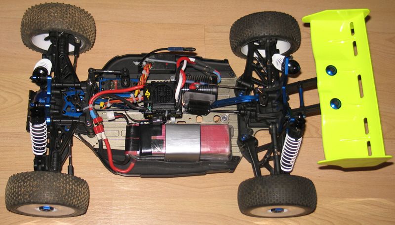

Another complete view:
Complete "nude" view:

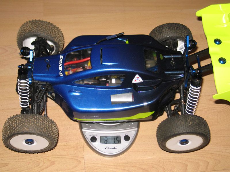

Overall CG view:
Cool:
Just over 8lbs fully RTR!

Since racing this buggy, I gotta say that so far it's working very well. I didn't have time to set up the mechanical and motor brakes properly, but they still worked flawlessly. Nothing on the buggy broke which was nice because I had no spares...
Only problems I had were when the switch turned off (my fault, and immediately after the race I cut the switch off), and two wing mount screws came out all the way (again, my fault since I didn't thread-lock them).
Although, I did have to run a lot of preload on the springs to keep the arms level, which is an indication that the springs were too soft. Indeed, I would have been much happier with stiffer springs, but they aren't yet available.
The rear end was very loose in corners, but the track also had a loose top surface since all the water had evaporated from the dirt. Also, better tire choice could have fixed this.
Steering is great on this buggy. On a certain u-turn on the track I was accidentally cutting other buggies off because it was taking the turn so sharply.
I definitely look forward to fine-tuning the handling, braking, and acceleration of this new buggy!

WWooowww that looks great Metalman.. I see the mount worked out quite nice and it looks like you CG or good?. Great to hear nothing broke!.. And I do like the micro servo for the rear brake.. Did you end up hooking to your 3 channel??. What is your gearing? And do you know what that bad boy weights?? I thinking what 7.5lbs??
Looks great!..

The CG is decent, but because I wasn't able to fit the components on the floor of the chassis the CG could be better.
I did use the 3rd channel mixed in with the throttle to control the rear brake.
Check out the last picture . Just over 8lbs . Not bad for the first electric conversion to the SH buggy in the US .
Originally Posted by tom255 View Post
Wow nice conversion but I dont like battery box, becouse material is too weak, if it not polycarbonade otherwice it too fragile. I dont trust velcro tape too on front of battery box. Maybe when it fresh it will hold battery but in dirt and after copuple battery replacements it goes weaker
The material is 1/8" thick polycarbonate - it's very strong. This is my third time making a battery tray using similar methods of velcro mounting (and it's worked for the last YEAR), and it's gotten better each time I have made a battery tray. In racing last Sunday there were no problems with the battery even close to falling out.
Besides, dirt doesn't get in the velcro fibers. I don't get the buggy dirty without the battery in there, and when the battery is in there, the velcro straps are on, closing off the inner fibers from whatever might get on them.
