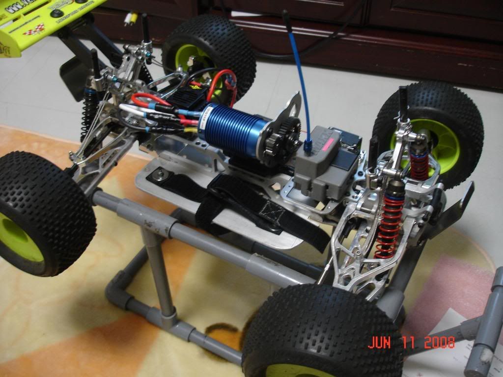

It just dawned on me last night. I was initially thinking of cutting the other "ear" of the motor mounting plate but I changed my mind because it actually helps in cooling down the motor. It helps in dissipating the heat from the motor by providing an extra surface area for cool down.
By the way, that's the stock 3906 motor mount which I deanodized using oven cleaner.

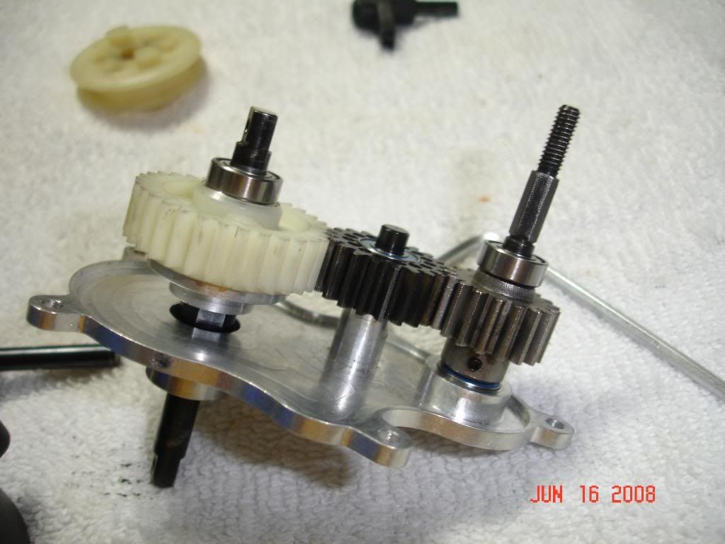

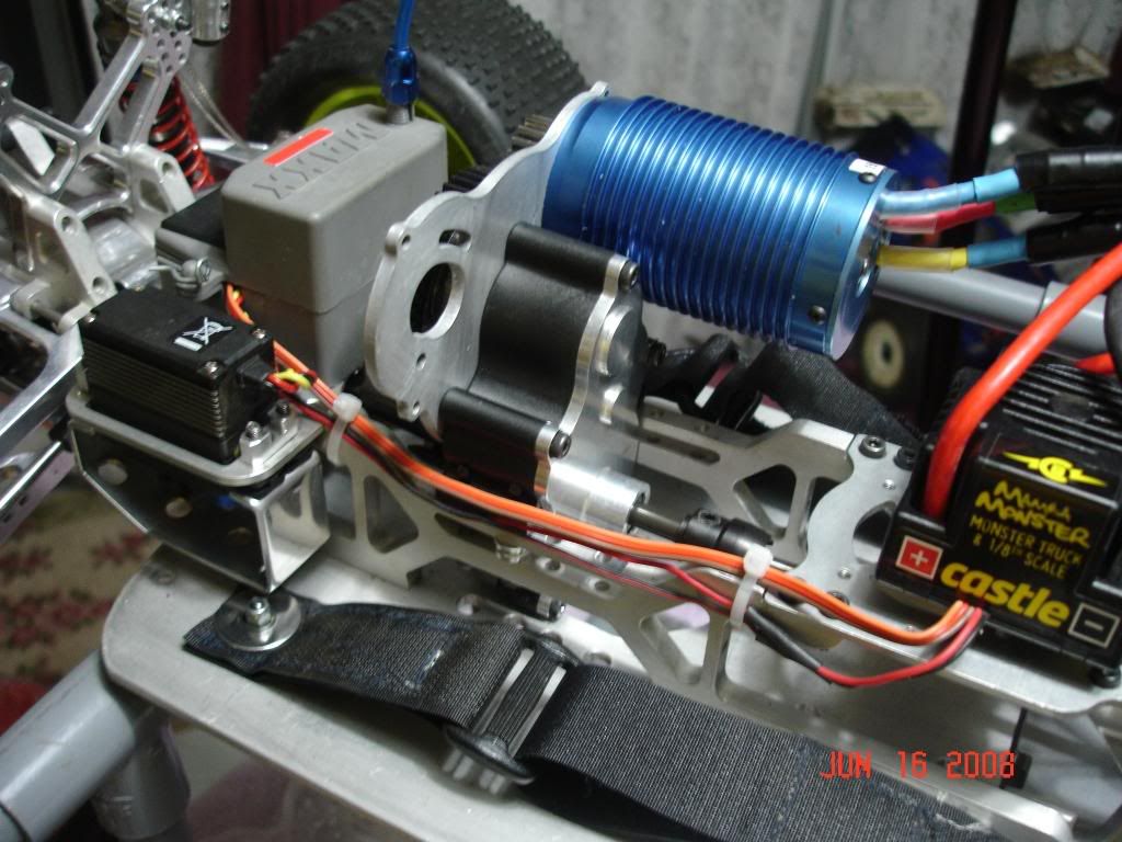

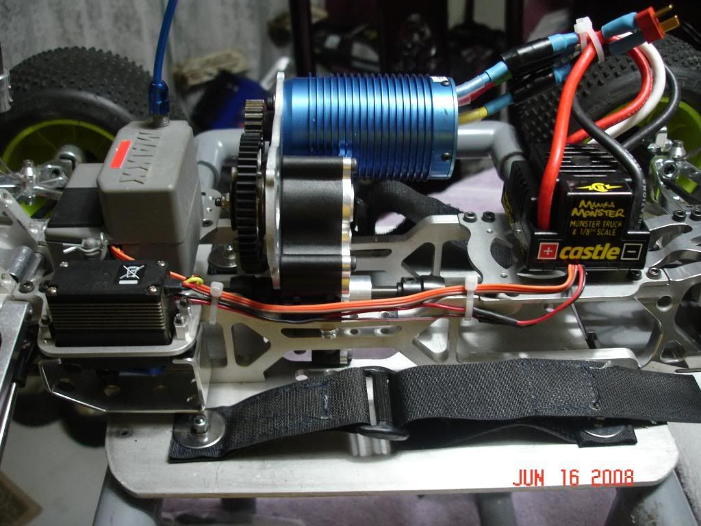

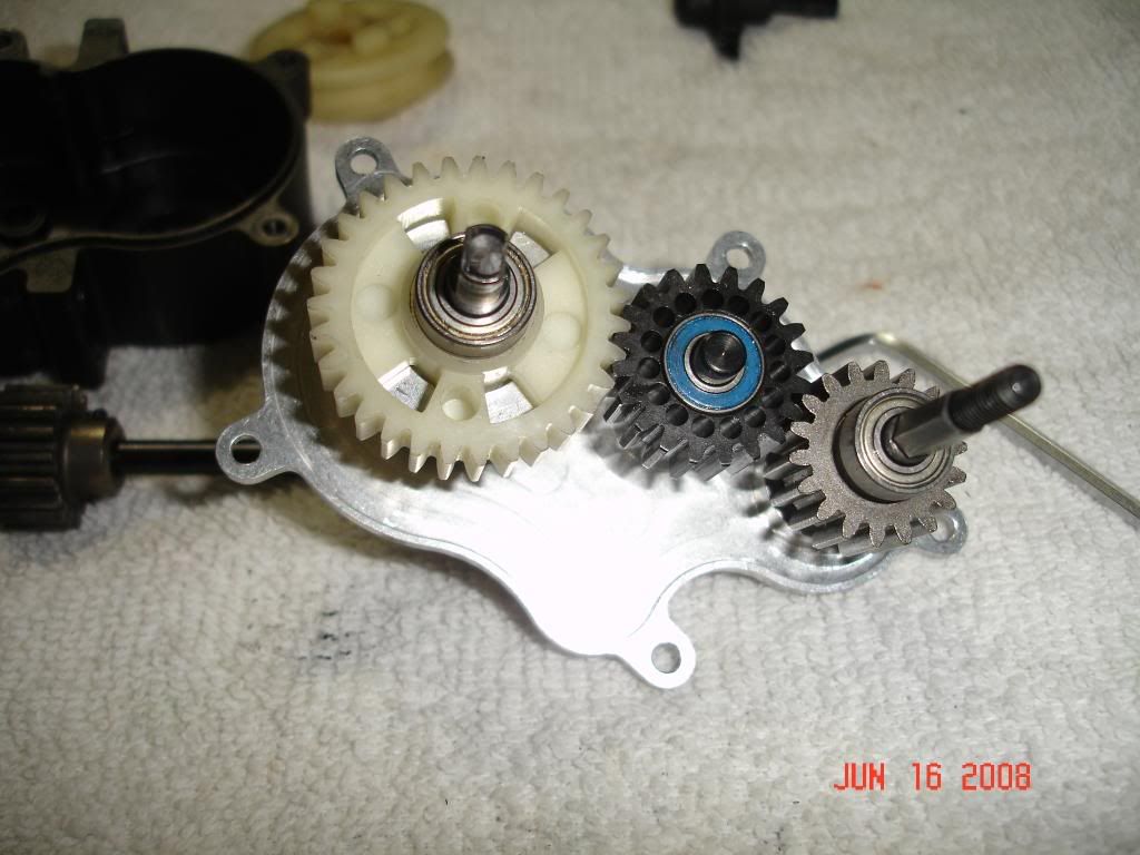

I did some more mods tonight by installing the Gorilla maxx single speed tranny I scored from Ebay for $50. It was a complete tranny and also came with the traxxas lightweight shafts.
Anyway, here are some pictures:
More pics:
